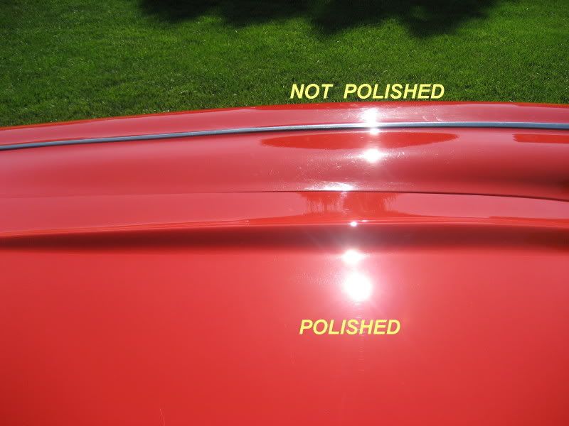

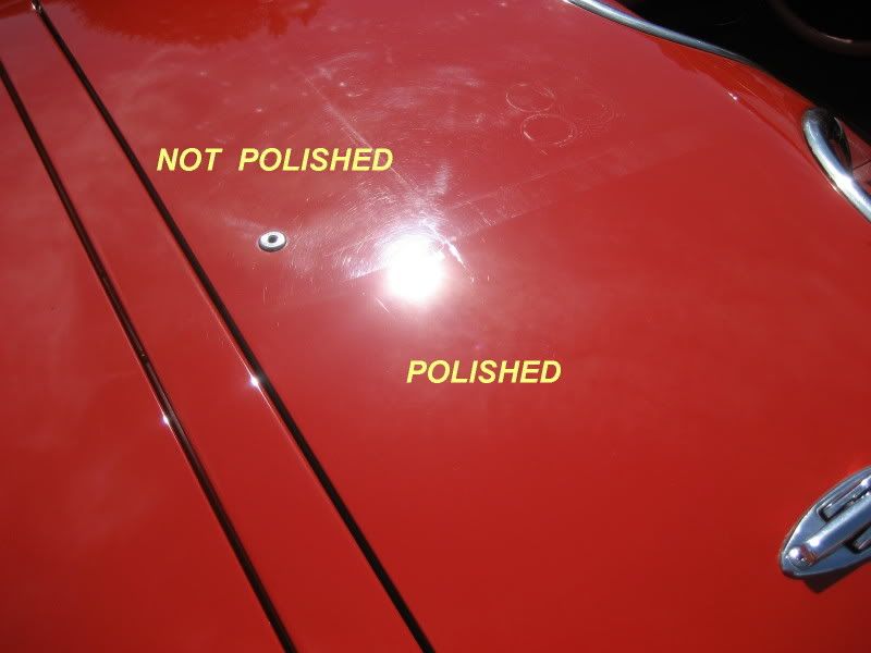

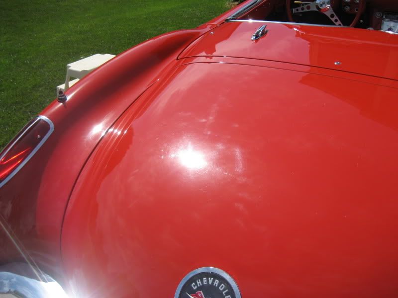

This customer brought me this '59 Vette this morning. He was as nervous as a cat! He explained to me that the paint was single-stage enamel that was painted in 1984.
He was urging me to "Err on the side of caution."
I agreed.
It was covered with swirls. He said it hadn't been polished since it was painted in '84!
The car was already clean so I started with:
1. Meg's Quik Clay
2. Tried M205... didn't cut the swirls...
3. Switched to M105, PC, LC Orange
4. M205, PC, LC White
5. IPA Wipe
6. Z5P applied with LC White (x2)
7. Z8 Wipe down

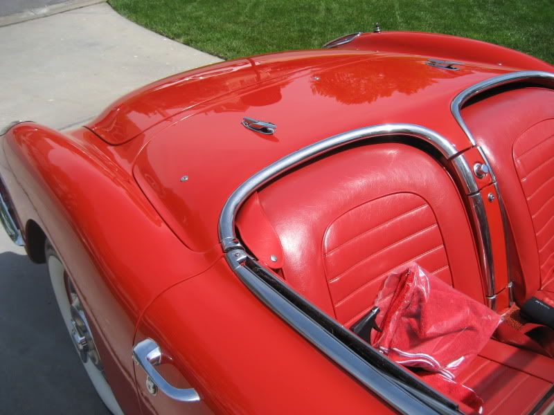

Wheels, tires, engine, interior were all perfect.
Nice car.

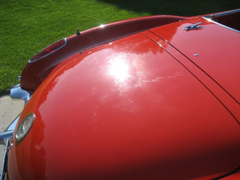

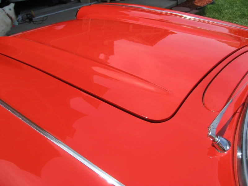

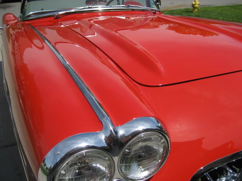

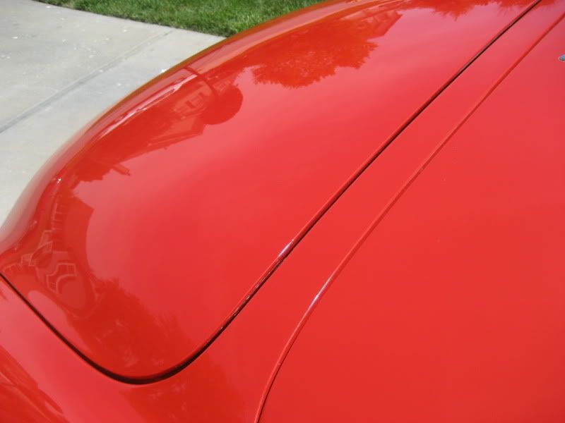

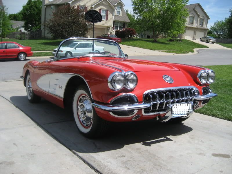

BEFORE:
AFTER:
THE PROUD & HAPPY OWNER!!!:D
