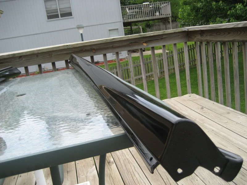

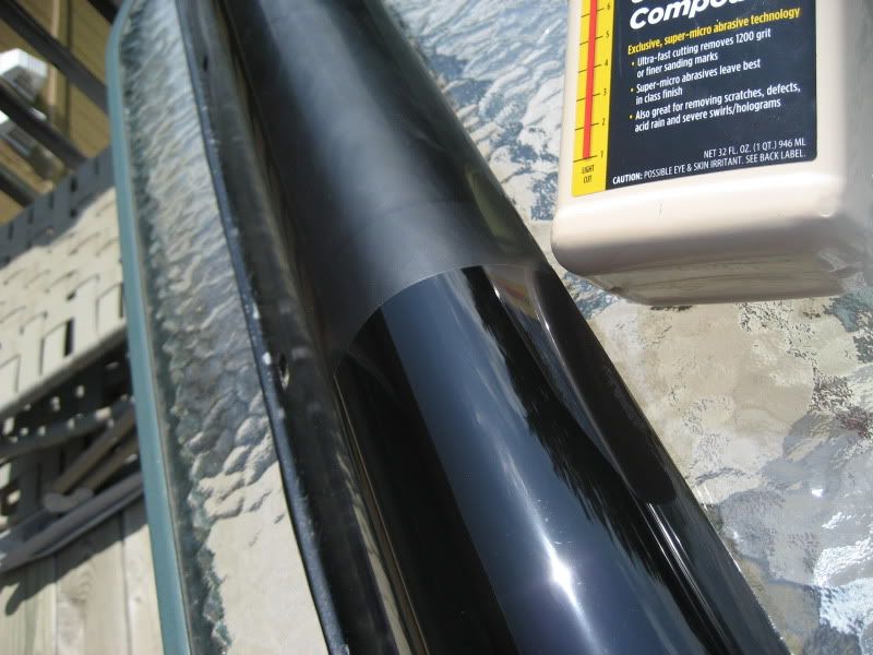

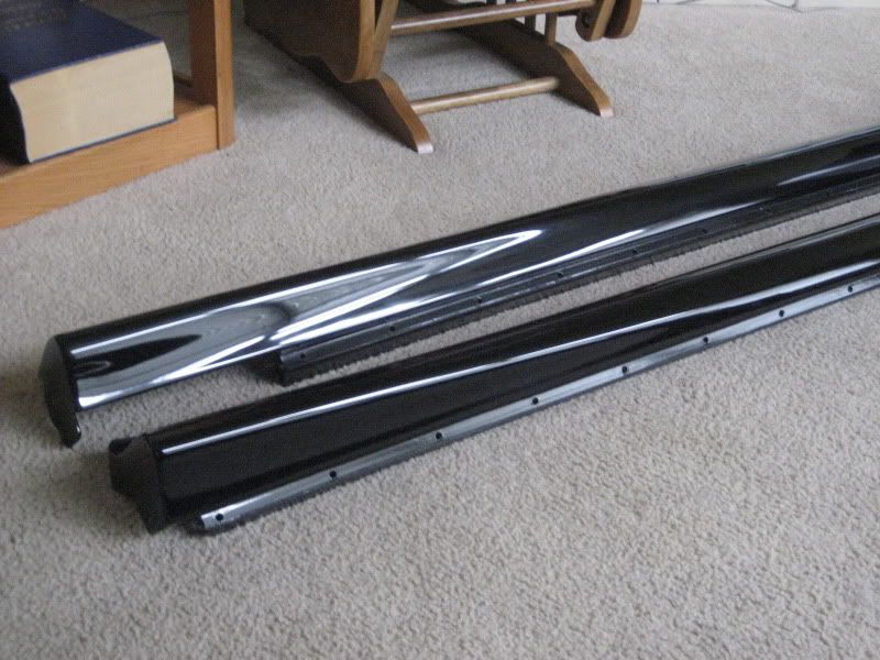

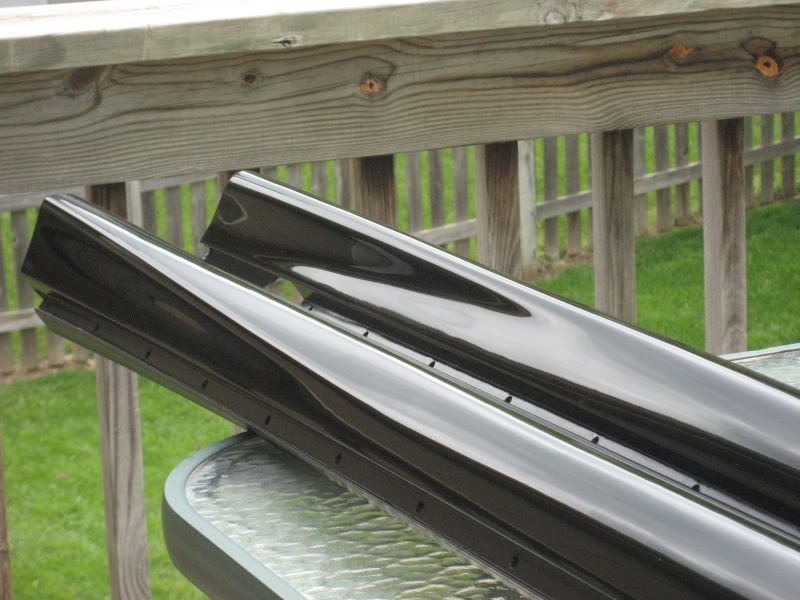

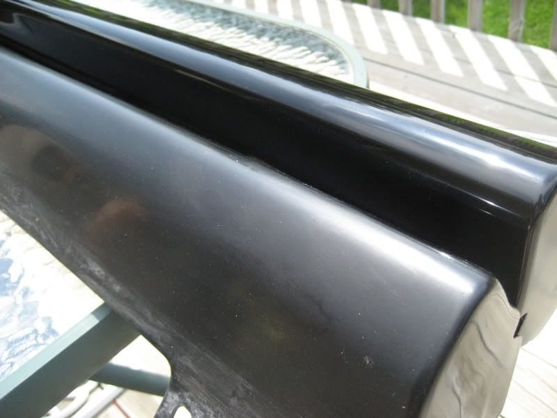

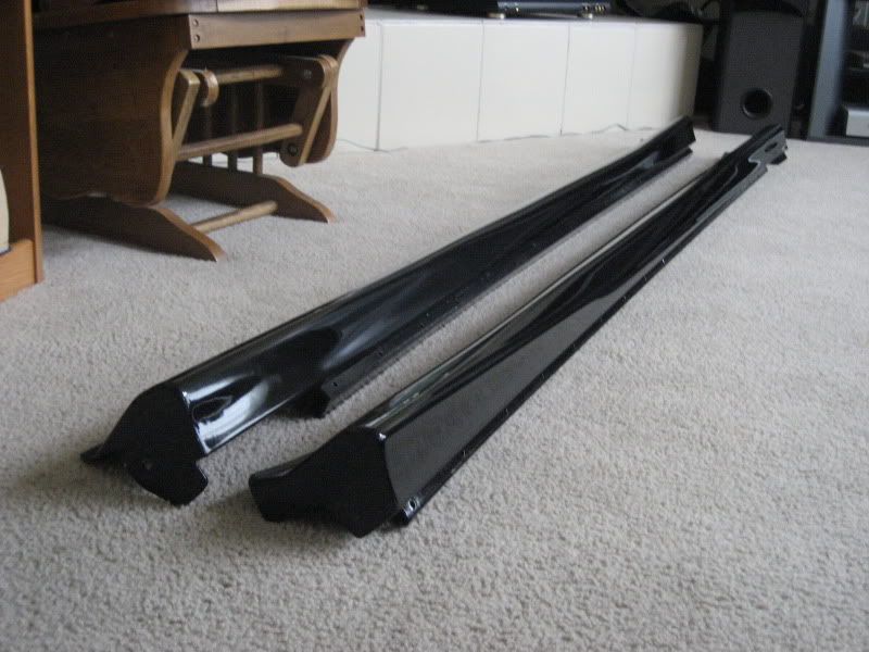

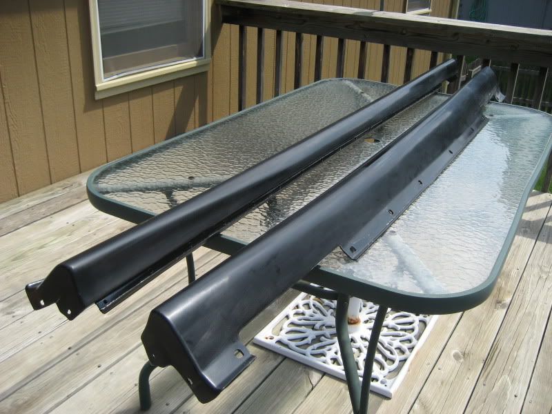

A friend of mine called me a couple nights ago and wanted his Ground Effects polished. He had taken them off the car, re-painted and wet-sanded them and wanted me to "shine 'em up"!

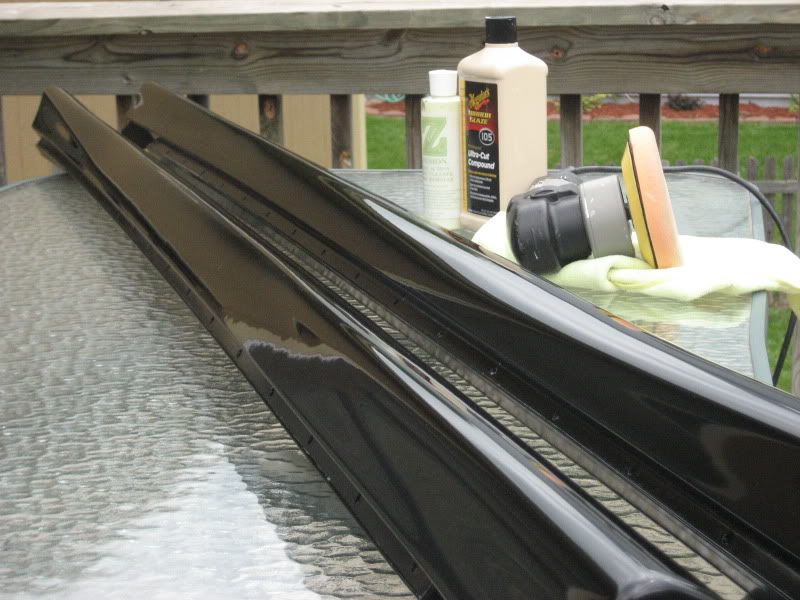

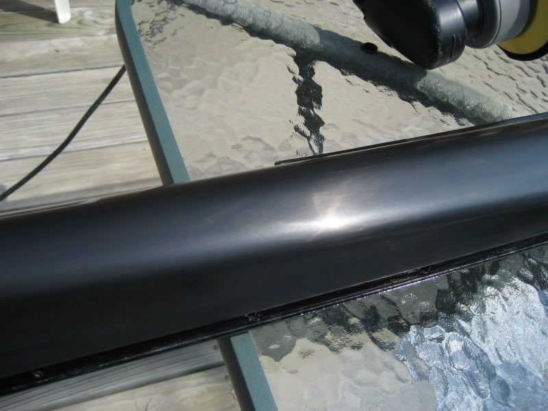

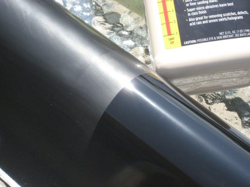

Process...

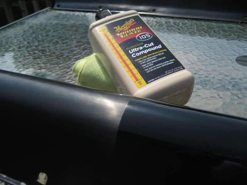

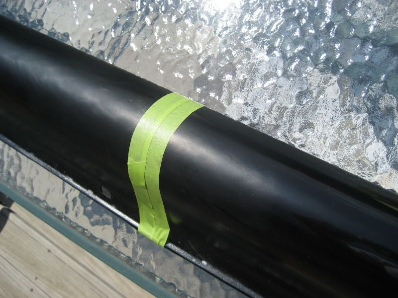

1. For good measure, I hit them with some 2000 one more time
2. IPA wipedown
3. M205/PC/LC Orange 5.5" pad. This was VERY SOFT Clearcoat. I used NO PRESSURE. Just the weight of the machine.
4. IPA Wipedown
5. ZPC/PC/LC White 5.5" pad. (He's a Zaino guy, so I wanted to give him Zaino prep.)
Total duration, 90 minutes.
Turned out nice, but next time I want the whole car!!!!!:D ;) :D ;) :D
