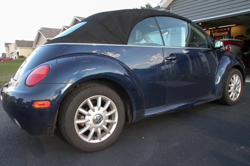

I picked up my mother in law's VW Beetle because I knew she doesn't take care of it. I was right.....it was trashed. I was completely hesitant to post this here 1) Because it's a little intimidating to say the least considering the talent that usually posts and 2) the finished product wasn't even up to my standards. Figured the only way to get better at everything including showing off the work is to just dive in and start doing it.

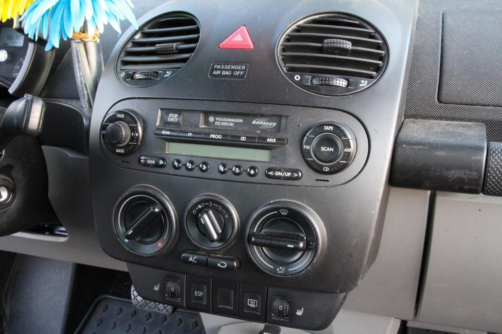

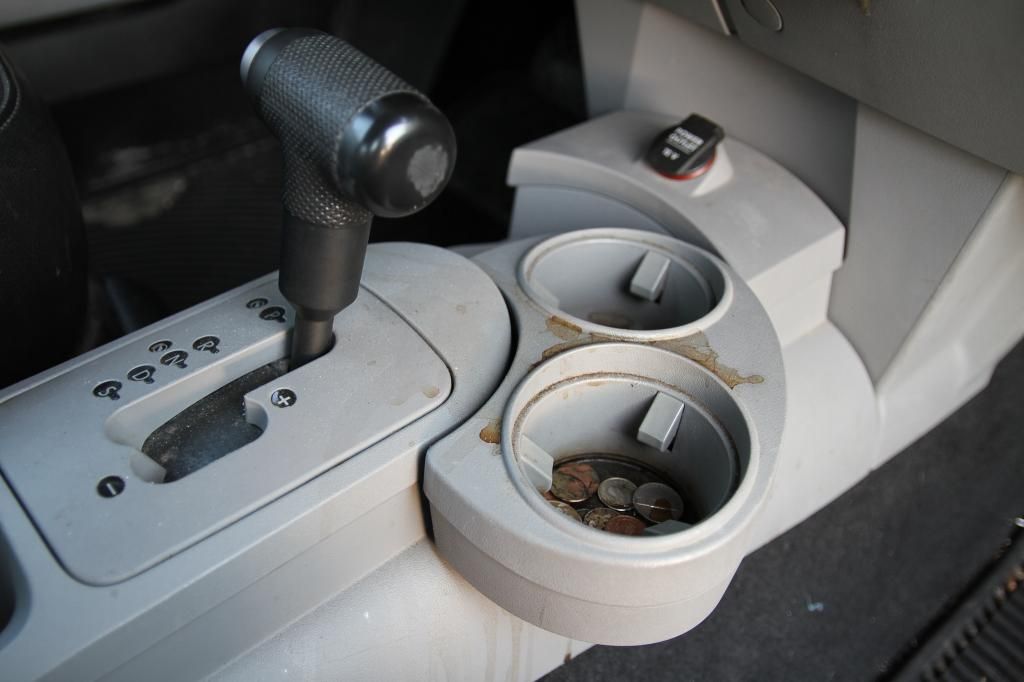

Interior was cleaned with Simple Green and then topped with Aerospace 303

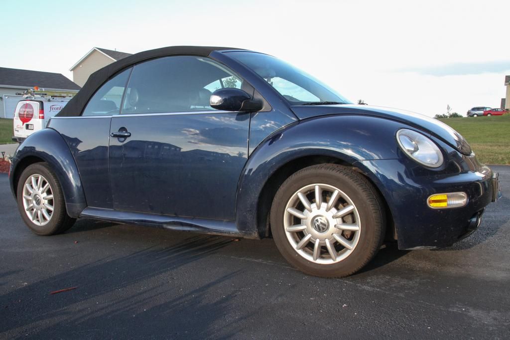

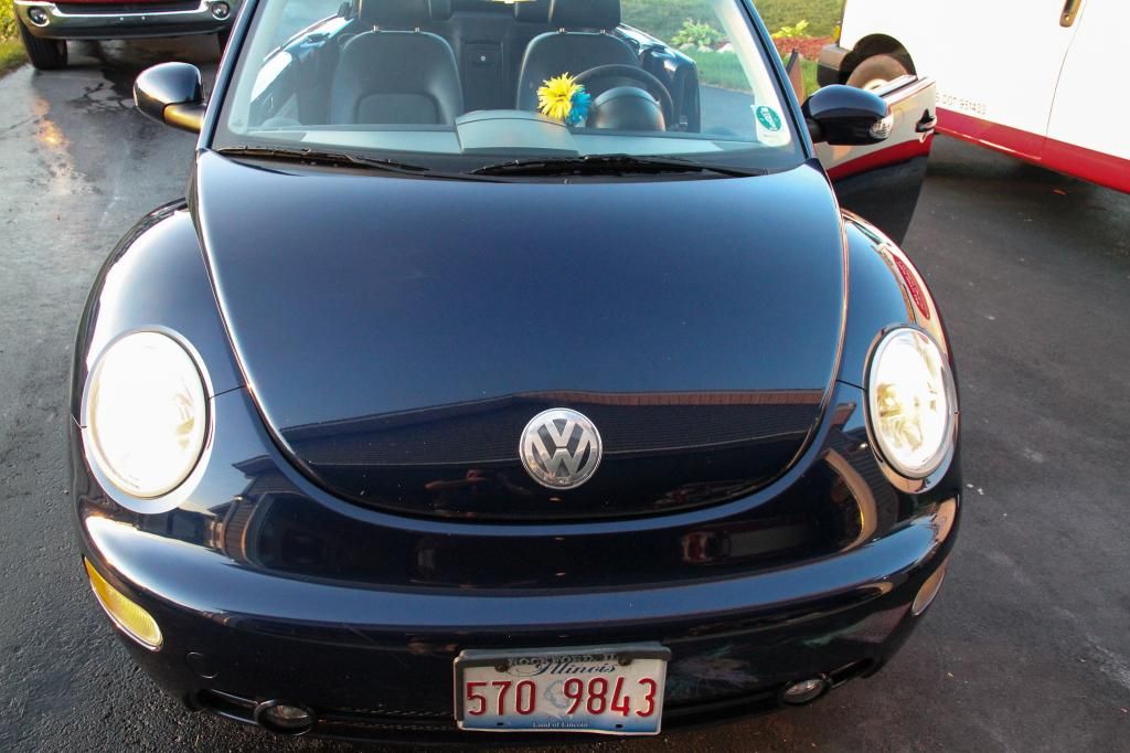

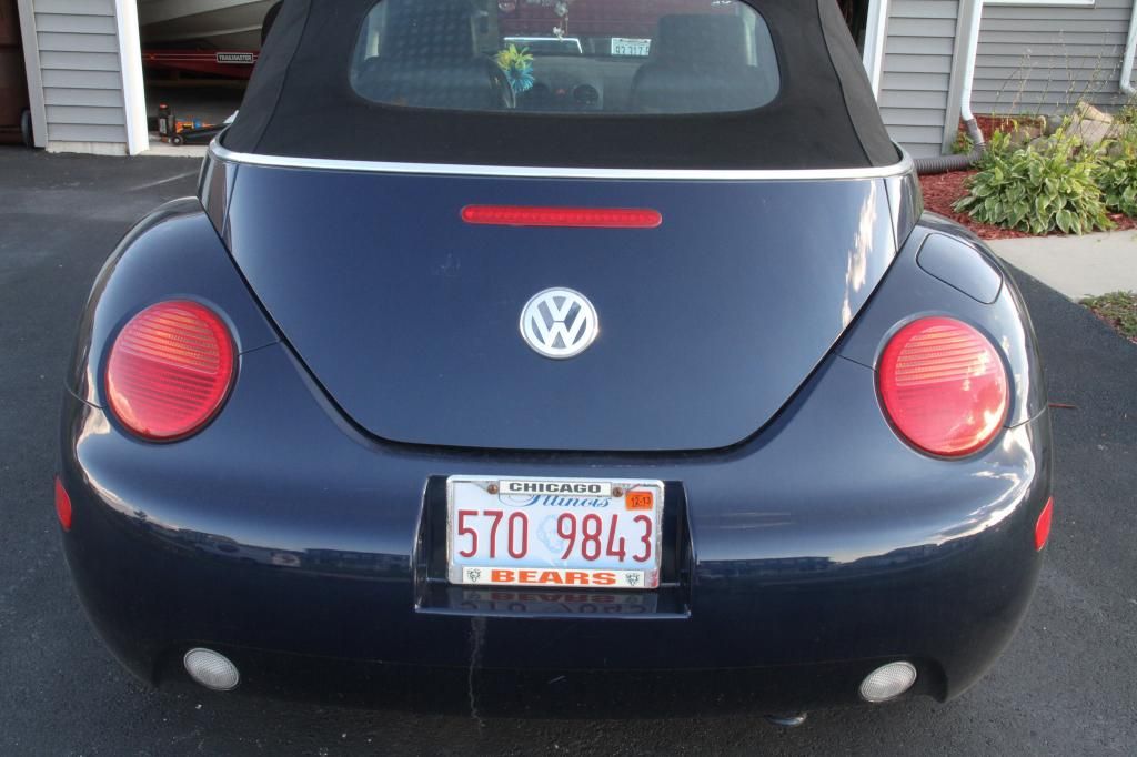

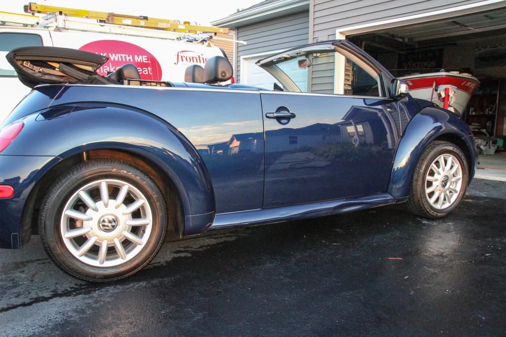

How I brought the car home:

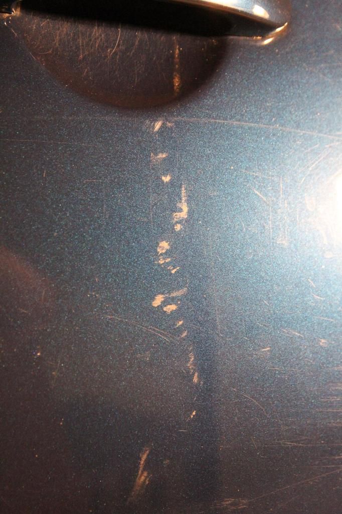

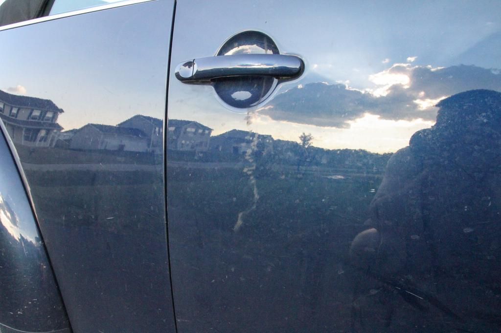

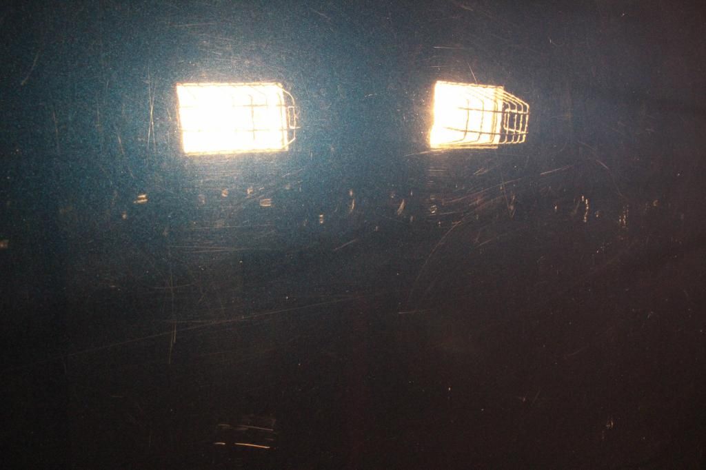

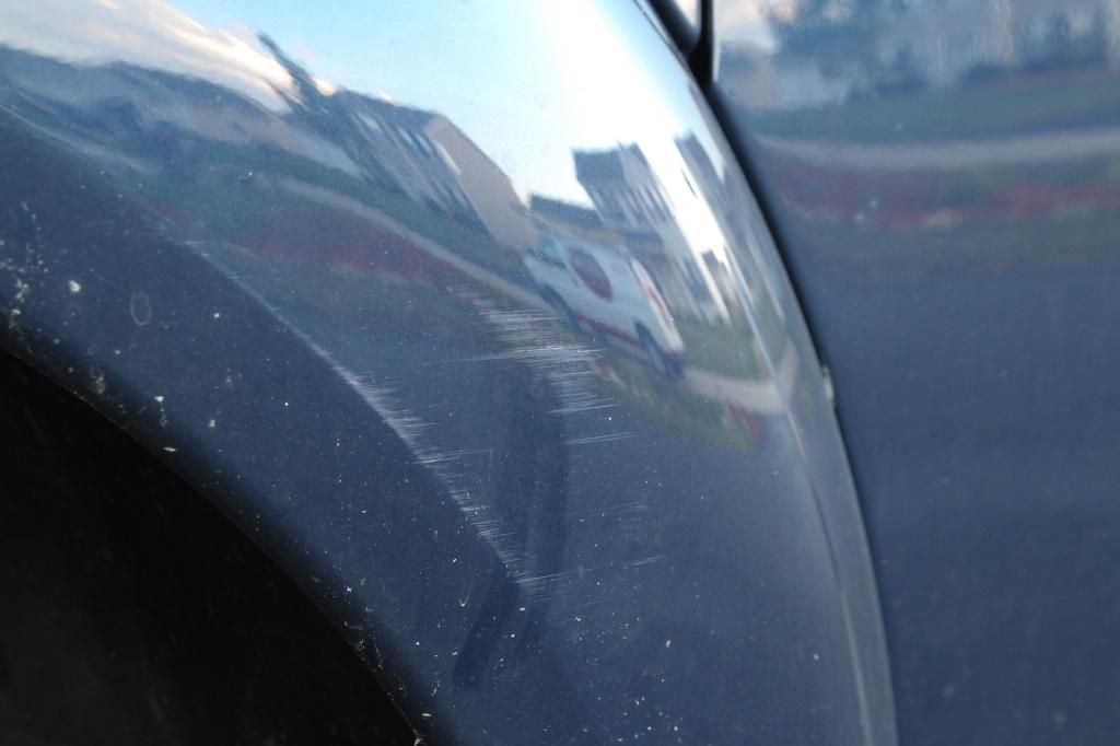

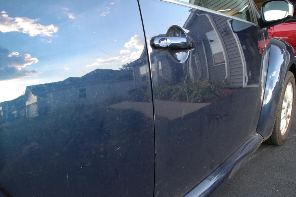

After wash and clay (the paint literally felt like fine grit sandpaper all over the entire car. God bless clay bars):

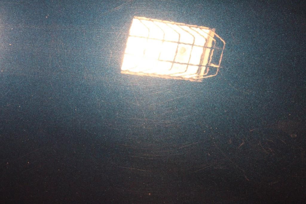

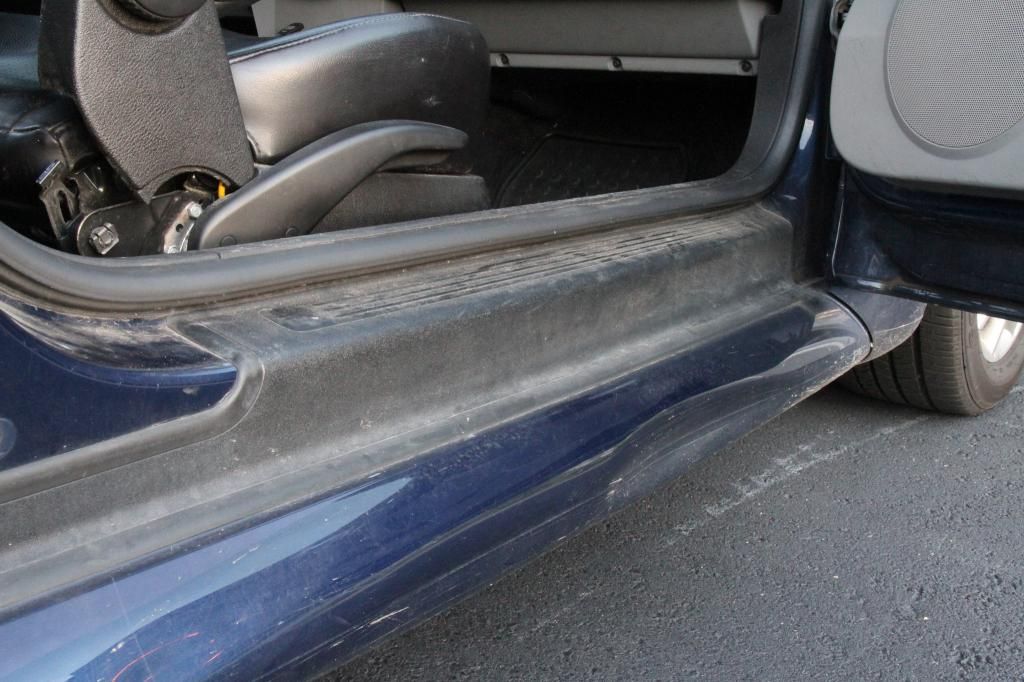

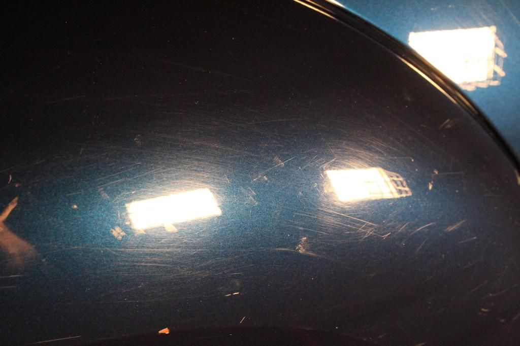

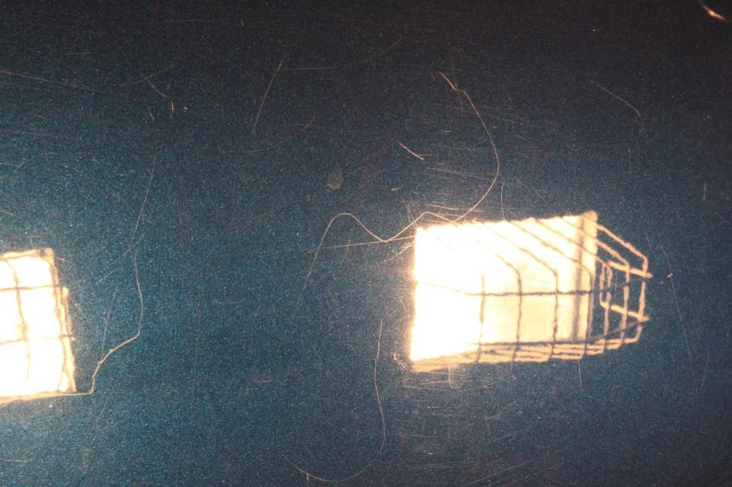

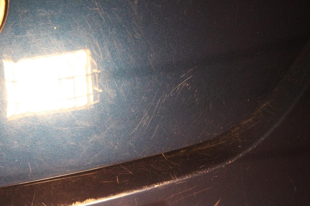

I won't plaster all of the defect pictures I have, but the whole car top to bottom looked like these pictures.

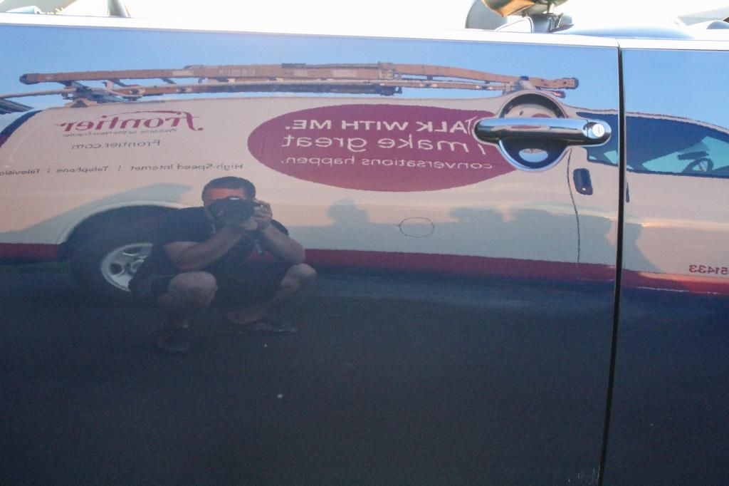

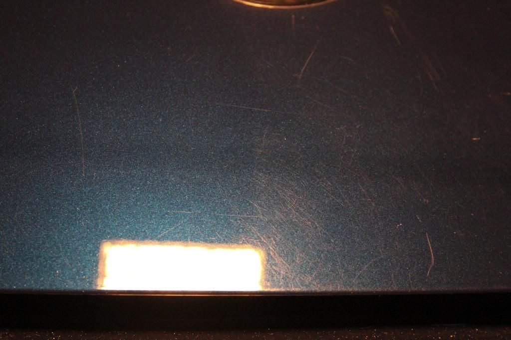

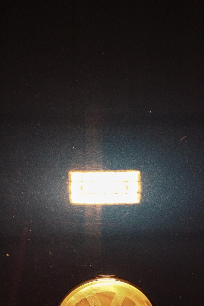

Here's a couple of bad 50/50 shots. I need to keep working on how to capture these shots. The difference was much more drastic in person
Hood
Driver's side door

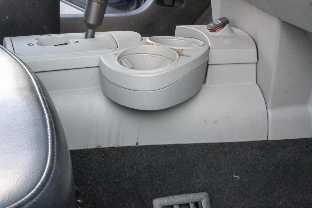

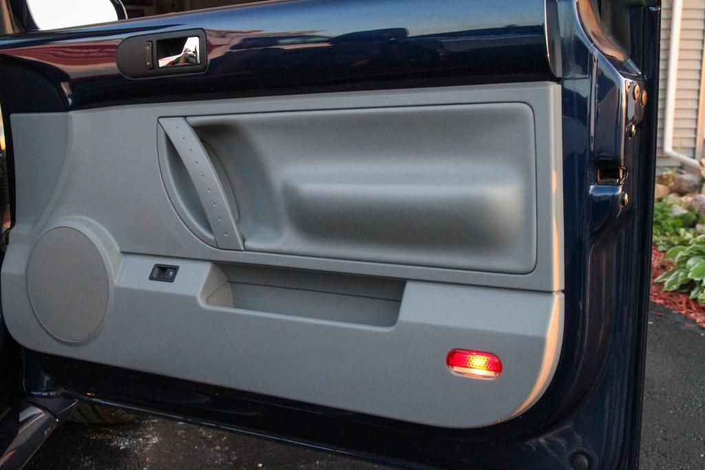

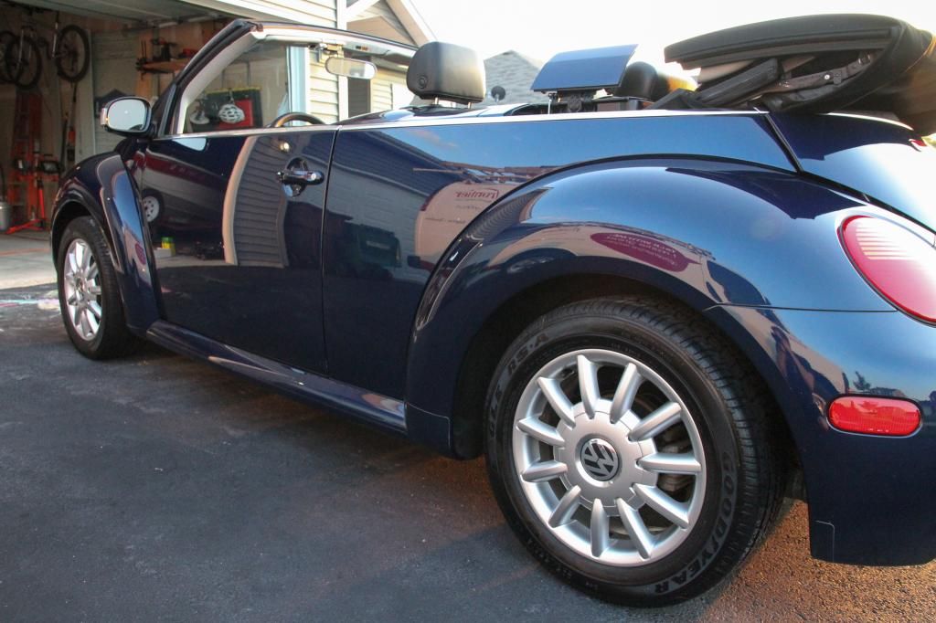

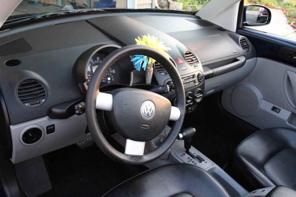

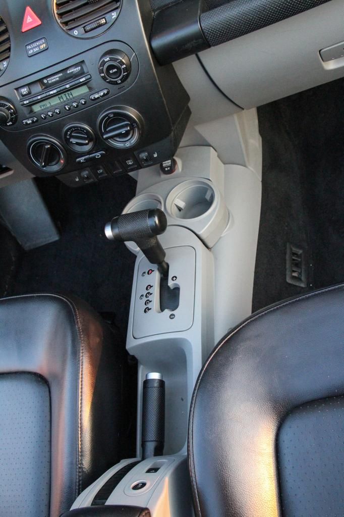

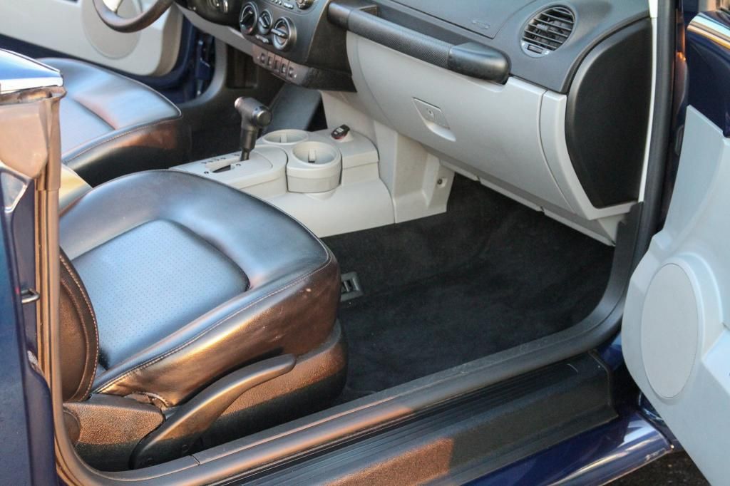

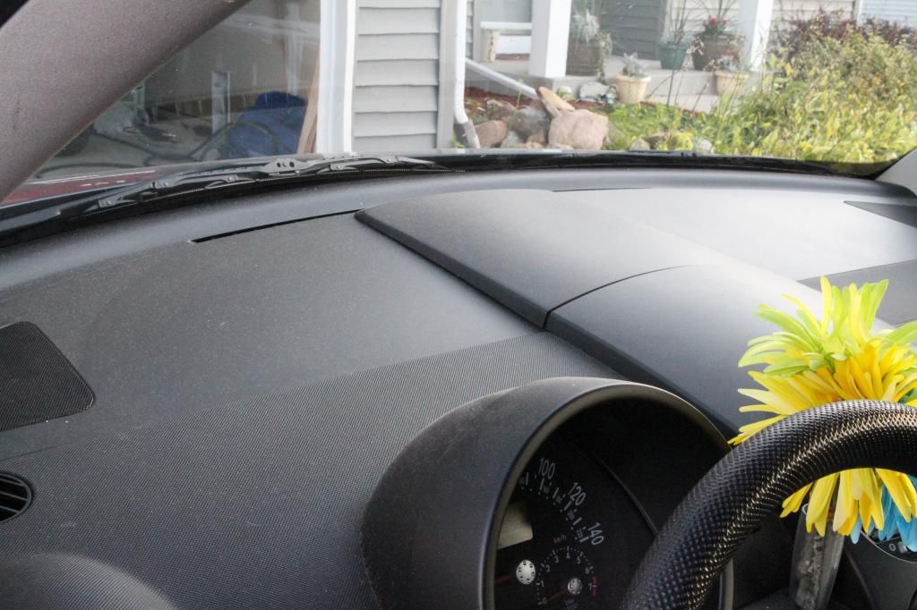

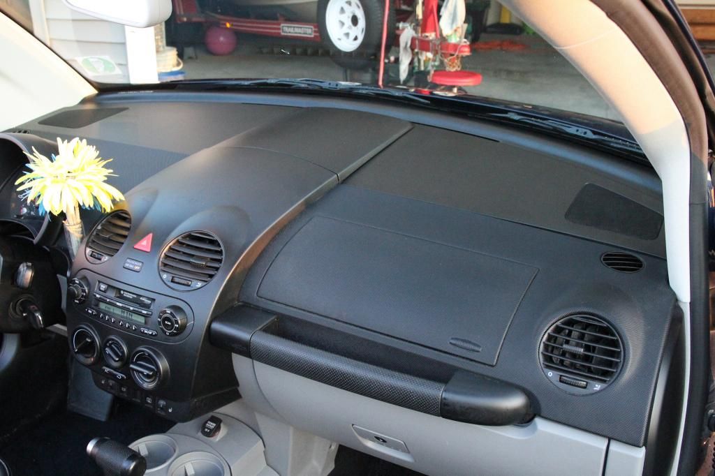

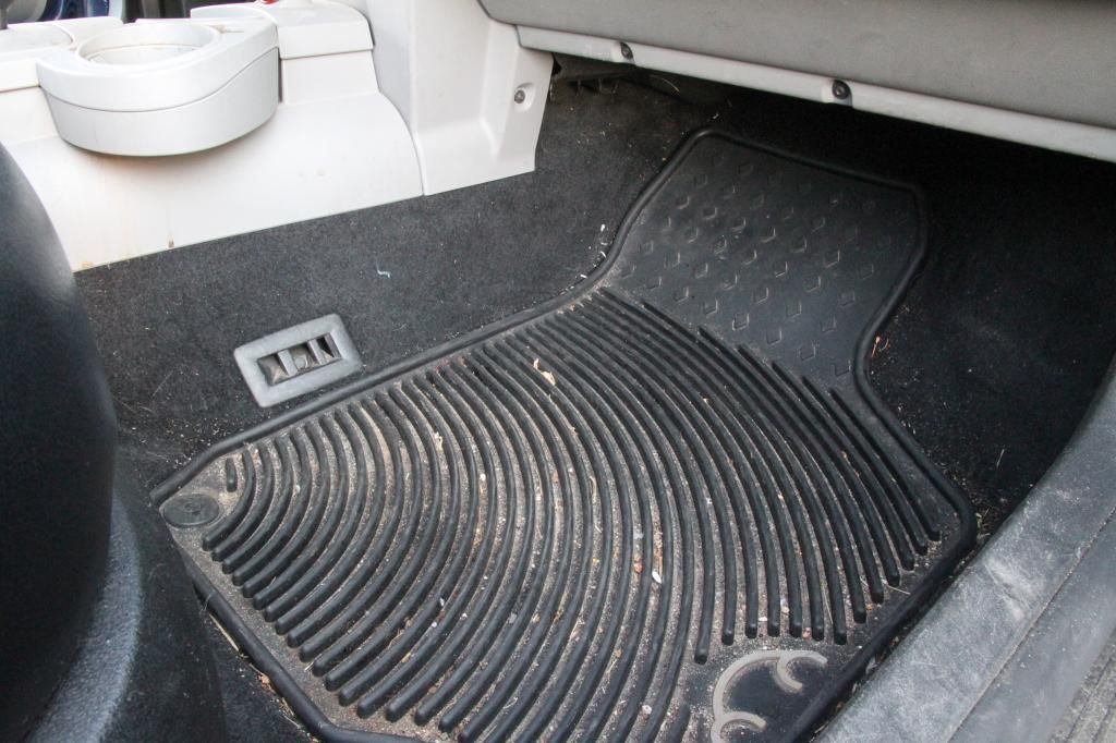

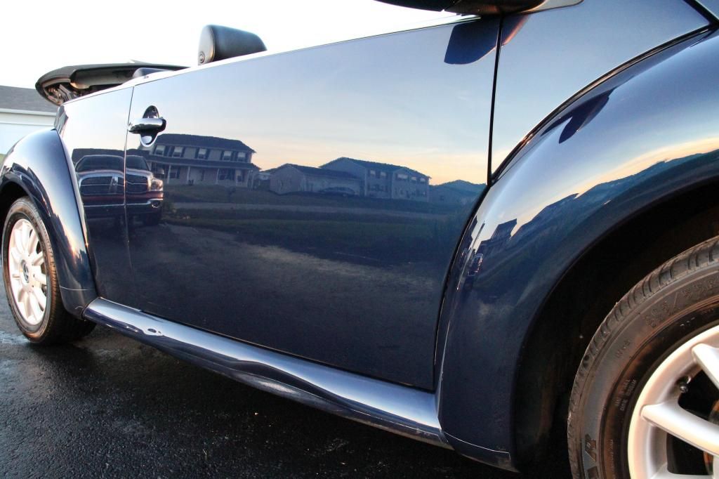

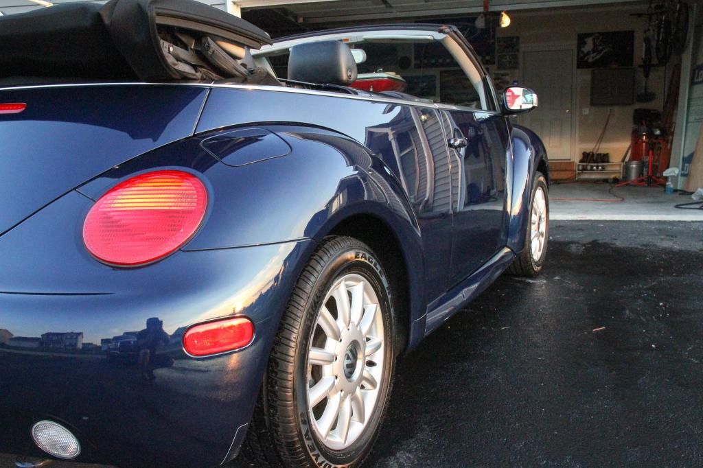

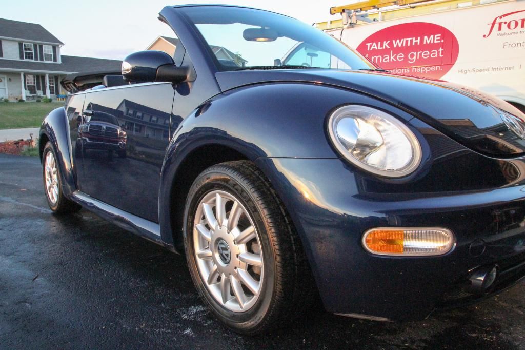

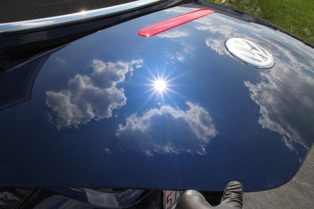

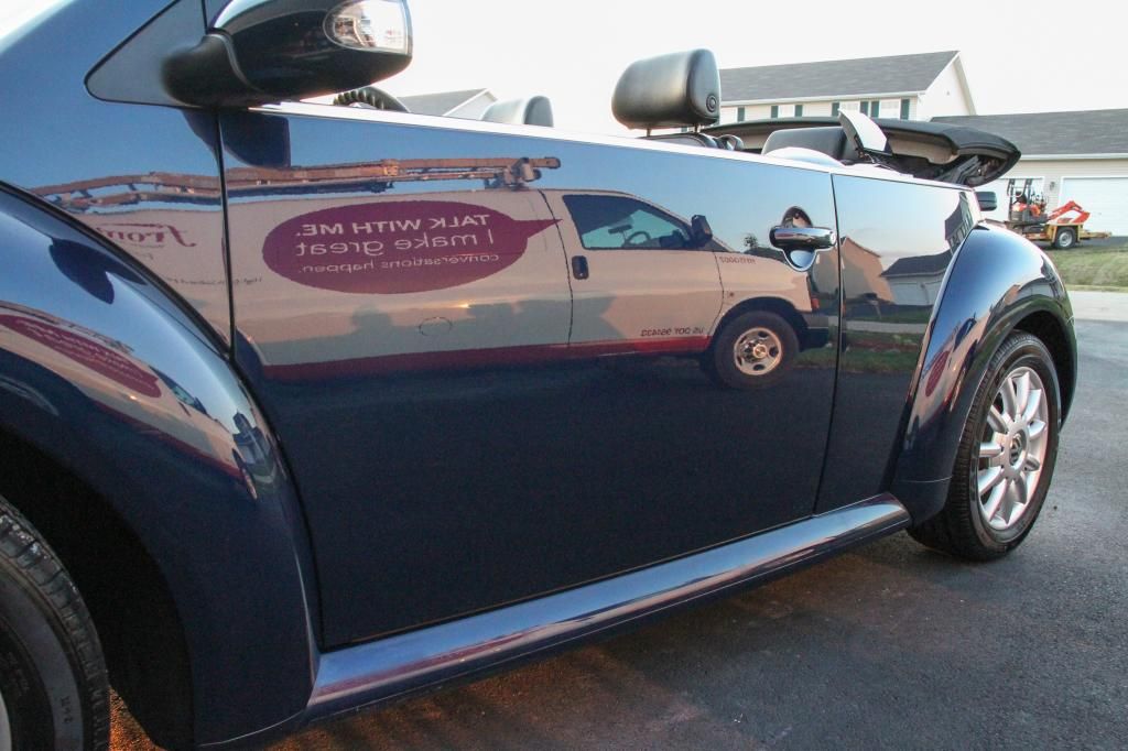

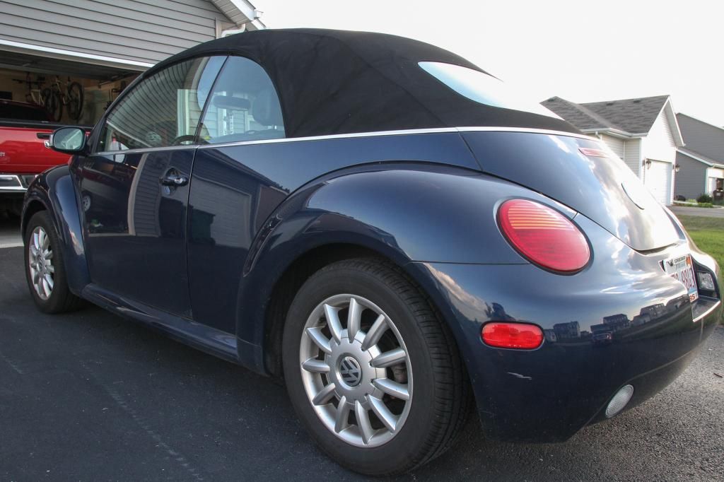

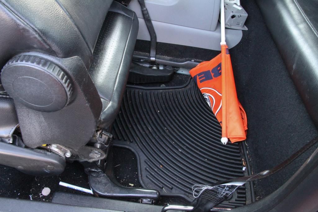

And finally some after shots. This is where I got disappointed with the project. Due to some things popping up through the weekend that took up more of my time than I intended, I flat out ran out of time to get the interior done the way I wanted to and to get the after shots including the halogen shots to show the improvements made. I literally could've spent most of a day on the interior it was so bad. Anywho, it does look better so I decided to post everything up anyway:
Some final thoughts on the project:
Even though it didn't turn out as well as I was intending, I'm still glad I did it. It was in by far the worst shape of any car I've ever done. I actually just kind stared at it for awhile after I got home trying to decide where to begin lol.
As far as the defect removal goes, I think I was really in need of a more aggressive type of pad. It was the first time I had ever used Meguiars 105 and the yellow pad had the most cut of anything I currently have. I went over everything twice with that combo and while it took out a lot of defects, I still didn't get it to where I wanted it. I picked up a Dewalt rotary earlier this summer because I wanted to add it to my arsenal for use on our boat and eventually cars. I figured I gotta bite the bullet and try it sometime so I busted it out on this car. I didn't end up using it long though because the pads I had bought for it were intended to be used on our boat (i haven't gotten around to that, so the pads were still new) and the size of the pads just proved to be too awkward on the small curved panels of this car. I'm really glad I tried it out though because I didn't mess anything up, I could tell the cut on the areas I used it were more effective than the PC, and I'm really interested in using if more due to it being more quiet/smoother than the PC.
I really need to work on the photography skills to better portray all the work. All in all though, it was a good experience. Bringing it back to my mother in law and seeing her almost in tears sure made the work all that much more worthwhile.

The more you practice at finishing down the paint, the better your outcomes will be. Keep at it.
