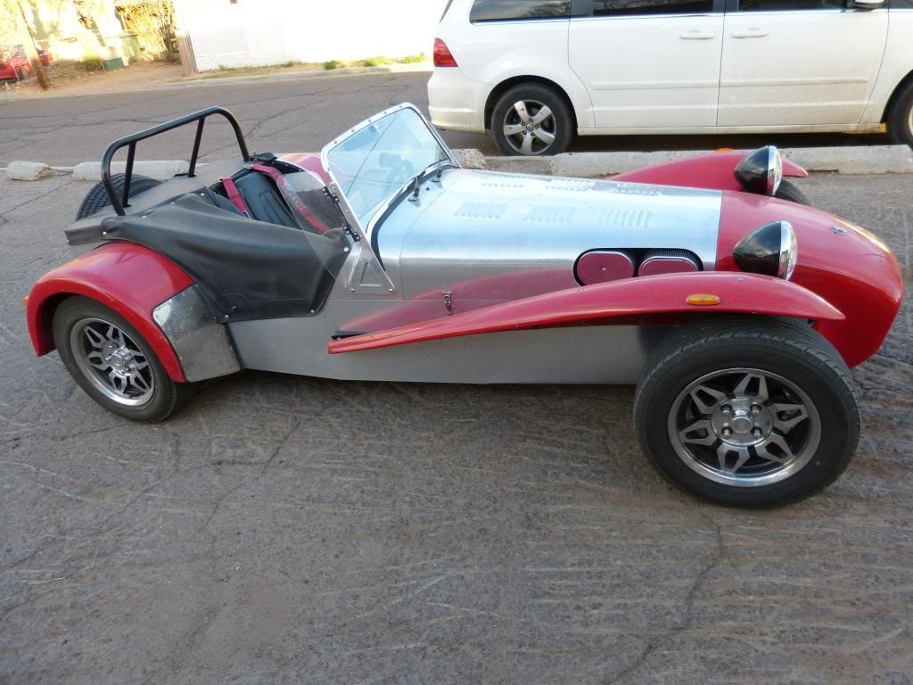

This will be coming in late next week:
It's pretty trashed. Driver side fender cracked from the owner using it for leverage to get in and out. But it's the unpainted body that I can use some pointers on. Not sure if I should use wool or what? Been looking at these two products:

This will be my first go at correcting Aluminum so any input appreciated. As well, while there are some scratches, which would be great if they could be, if not removed, then at least muted, I'm wondering, what LSP on bare Aluminum?
TIA
So some of the folks on the Lotus forum suggested sanding 1000/1500/2000.
Well I found that way too aggressive. So I used OptiClean on an area behind the spare tire as a test spot. I have 3 & 4K Buflex pads. The sanding cleaned it up really well. Followed with Never-Dull/ Mothers and buffing off the Mothers with a MF towel, the aluminum mars!
It's like the softest black BMW paint, only worse.
Am I doing something wrong or is this wha'st to be expected? Does anyone know?
