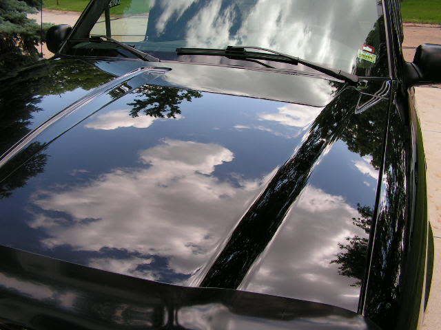

I have not posted any pictures here and I had a request to post my work both here and on another forum. I have been away from detailing for a while due to personal reasons and have just recently started back into this again.
Anyway:
The process:
Wash with NXT Car wash
Clay with Meguiar's Fine Clay Kit
Wash with NXT Car Wash
Wheels/Tires:
P21S Wheel Cleaner
Eimann Fabrik Tire Cleaner
Meguiar's Endurance Natural Look X 2
Polish:
As you will see from the pictures, the paint needed a lot of correction although my truck was in fair shape.
-Meguiar's #83 Dual Action Cleaner Polish with a PC and Lake Country Orange Light Cutting Pad -Speed 5
-Meguiar's #80 Speed Glaze with a PC with a lake Country White Polishing Pad - Speed 5
-Meguiar's #7 Show Car Glaze - For some reason I decided to try this with my PC and it did not work well. I should know better. Lake Country White Polising Pad - Speed 5
-Meguiar's #21 Synthetic Sealant X 2 applied by hand and buffed with a Microfiber Bonnet - Speed 5.
-Danase' Wet Look Glaze by hand and buffed with a Microfiber Towel
-P21s Wax applied by hand and wiped with a Microfiber Towel.
Before Pics:
During:
After:
As always, I'm open to any questions or comments.

It's be nice if you could make the pictures full size. That way we'd be able to enjoy it a lot quicker :) Got some mighty orange peel there, but you did an AMAZING job at reconditioning the paint. Did you find the #83 hard to work with?
Like always, #83 has a short work time so you have to move fast. The #80 gave me a long working time so I spent a lot of time doing paint correction with it. Gotta Luv that orange peel on new cars.

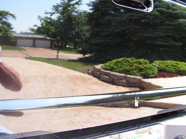

Here's a few afters in full size.
LOL - Im sorry but the reflection of the tree looks like it connects directly to your body and the tree actually looks like it has a smile on it and two beady eyes!!!!!!! :chuckle: :chuckle: :chuckle: :laugh: :laugh: :laugh:
Other than that, great job! Must have taken a good bit of time for a full size truck like that.
Oh crap, I didnt realize it was Ford Ranger, from the angles it almost looked like a Chevy Silverado! Great job anyway ;)
Funny Chris! I was thinking the same too. I was looking for his head and then I seen the teeth in the bush
