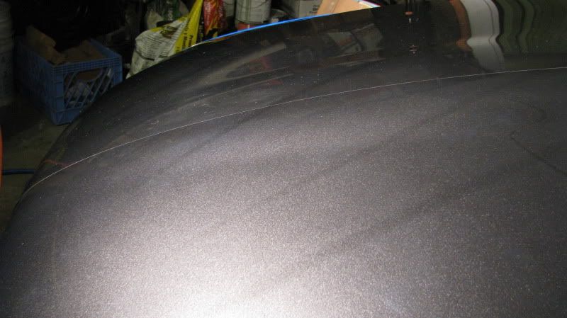

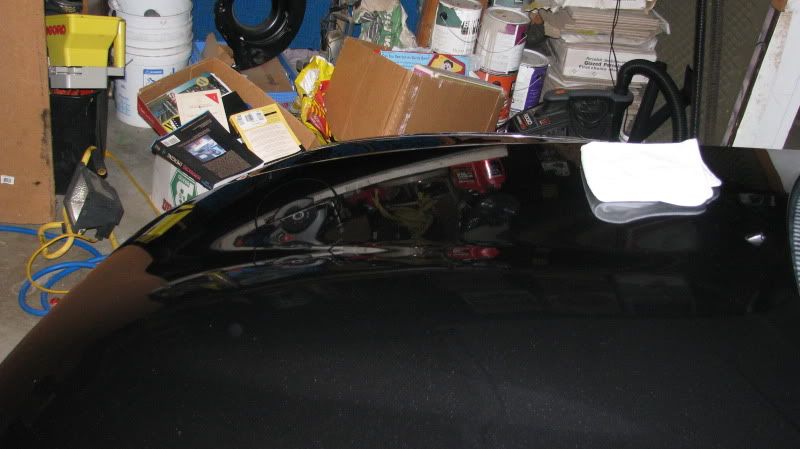

So here is an outside shot of the hood, I tried to angle the light just right to see the marring (which, by the way, wasn't there before I clayed)

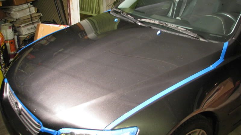

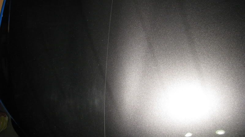

Inside the garage, taped up, and ready to polish. Kinda let down you cant really see how bad the hood looks in this pic, but the dullness of the paint definitely stands out

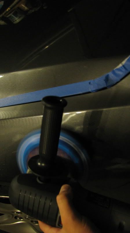

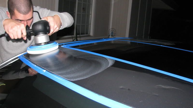

Excited to play with my new toy... This is m205 with white LC pad (looking at the pic now, my sweater makes it seem like I have a huge belly. Im a pretty skinny guy)

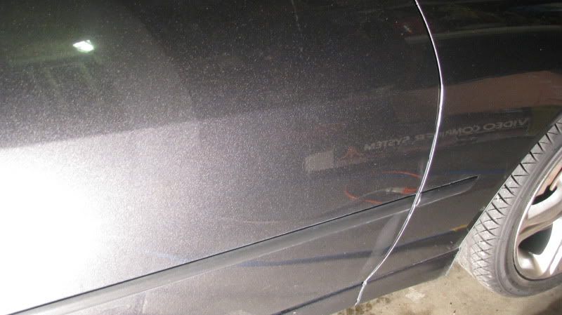

A couple 50/50 shots
The finished hood, reflecting the piles of S in my garage

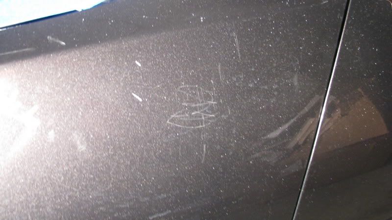

On to the fenders; the drivers side one looks like someone tried to do a Spirograph drawing on it with a key

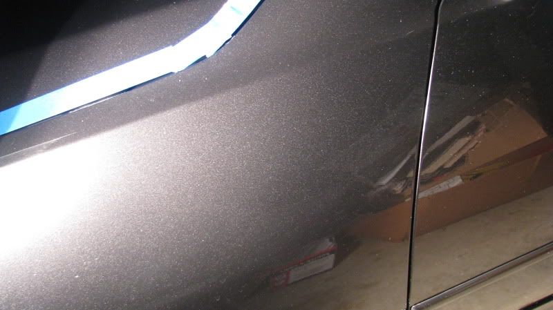

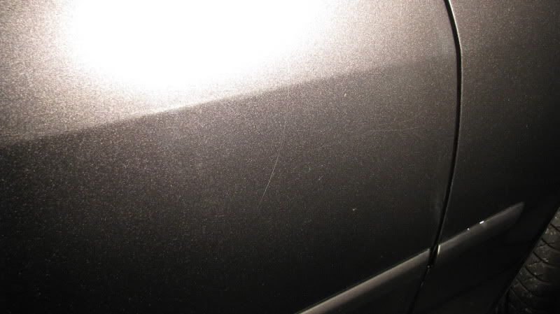

Some light scratching

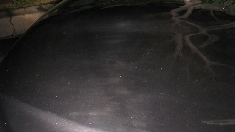

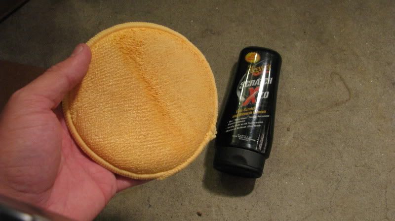

A few drops of scratch X later...

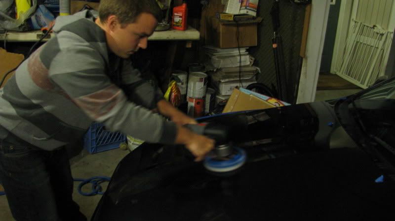

Gotta give cred to my buddy Sean for lending a hand. Looks like he's aiming a gun

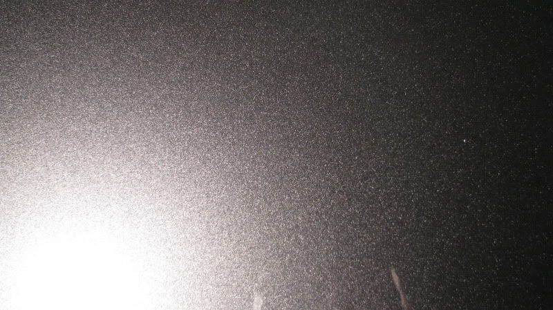

The halogen overwhelmed the camera, Wasn't sure how to get the awesome reflective pic. Maybe I need a lower wattage bulb, or I didn't do a good enough job?
