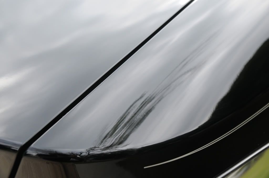

Bad scuffing and RIDS

Scratches removed but stress cracks in plastic from impact remain
