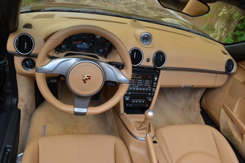

After years of use, automotive finished leather can become worn and tired looking, and can often make an otherwise pristine interior, look old and unappealing. The option of a replacement is both expensive and very often unnecessary, and can affect the originality of your vehicle.
Leather restoration helps you or your clients add value and prestige to their vehicle, wither it be a daily driver, a Concours d’élégance entrant or a classic car. When the time comes to resell the vehicle, one with damaged leather will realise much less than one with clean undamaged upholstery so clients use renovation for commercial as well as aesthetic reasons.
As tough and durable as finished leather can be it can still suffer from wear and tear problems which can be repaired at an affordable cost compared to renewal. Finished leather upholstery is often the most costly item to replace in a vehicle. Small scale damage can be fixed with a localised repair quickly and smoothly i.e. cuts and cracks, scuffs and scratches, fading, stains and discoloration as well as general wear and tear
