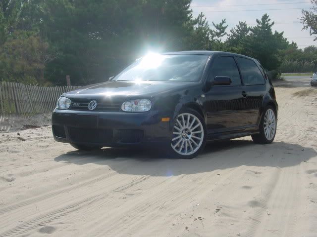

here's a pic of it right after he bought it.... black on black with tinted windows :cool:

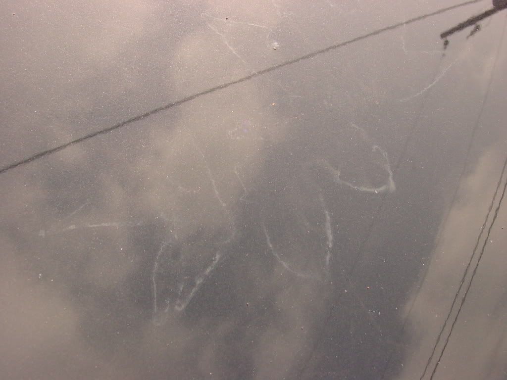

here is a closeup of one spot... you can see the mark around it all, it reminds me of an oilspot on blacktop... it has that shimmery / rainbow type look to it - not to mention the "fallout" that is on the paint... brown pimplly spots

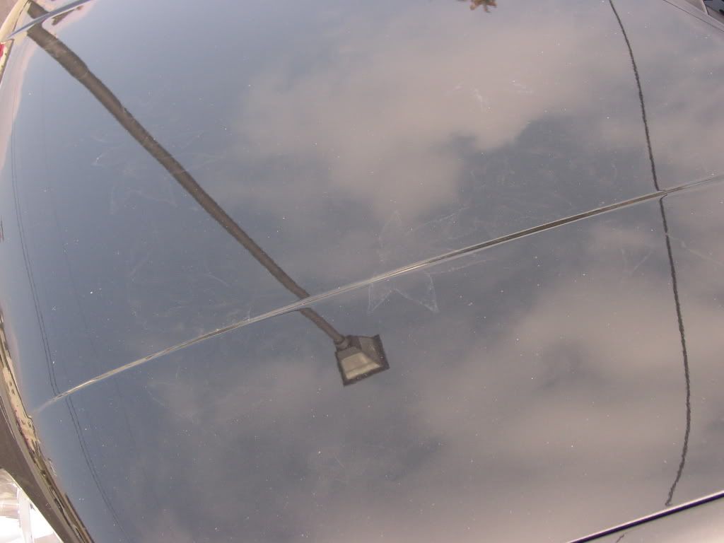

overall shot of the hood

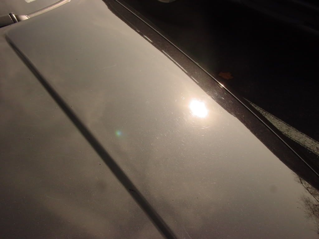

minor swirling (what i consider minor anyways)

I don't see anything in those pictures that I could not remove with a pc:nixweiss

bshertzer- If I were doing that care I'd use the 1Z Extra Polish on a light cutting pad and follow up with the #80 on a green polishing pad. See how it looks after that, use the NXT as opposed to the (longer lasting but less forgiving of flaws) Glanz.
Some VWs have hard clear and the Extra has a fair bit of cut. You'll probably need that. I didn't recommend the #83 simply because I'm not a big fan of it, but the Extra will be more aggressive IMO.

ok, maybe not the scotchbrite pad... but a lambswool mitt ;) they definately did NOT wash off, if anything, now that the car was clean, they were more noticible. I took it over to a friends house (who details cars and himself owns a cleeeeean black mk4 getta) he looked it over... and brought out the rotary with some speedglaze. after a few passes, they were lightened up. after a few more passes they seem to have dissapeared.
i'm thinking i may have overracted slightly, but the pics didnt really do it justice. when you got right up close and looked at it, it literally looked like the clear was bubbling.
