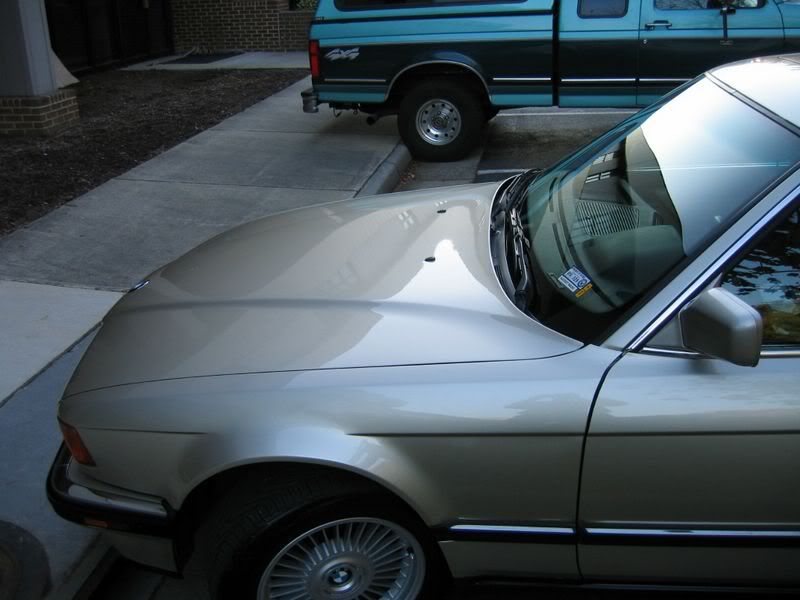

Exterior only. 1990 BMW 735iL
QEW
clay - 1 pass and the clay was dark brown. Went through 2 of them, both trashed. Dirtiest paint ever for me.
ssr2.5 white LC pad on 6
ssr 1 white LC pad on 5
EX+P gray LC pad on 4 waited 30 min and removed with MF towel
Meg's Hot shine on tires and trim

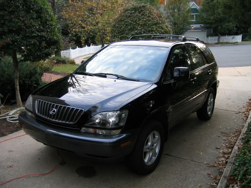

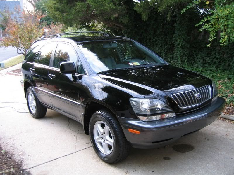

Monday's detail 1999 Lexus SUV
Very neglected. Full detail.

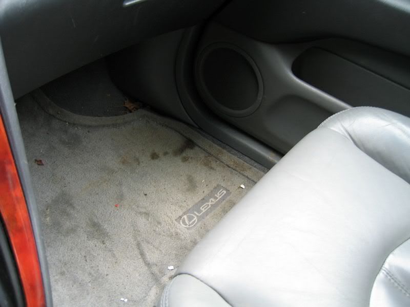

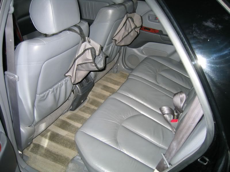

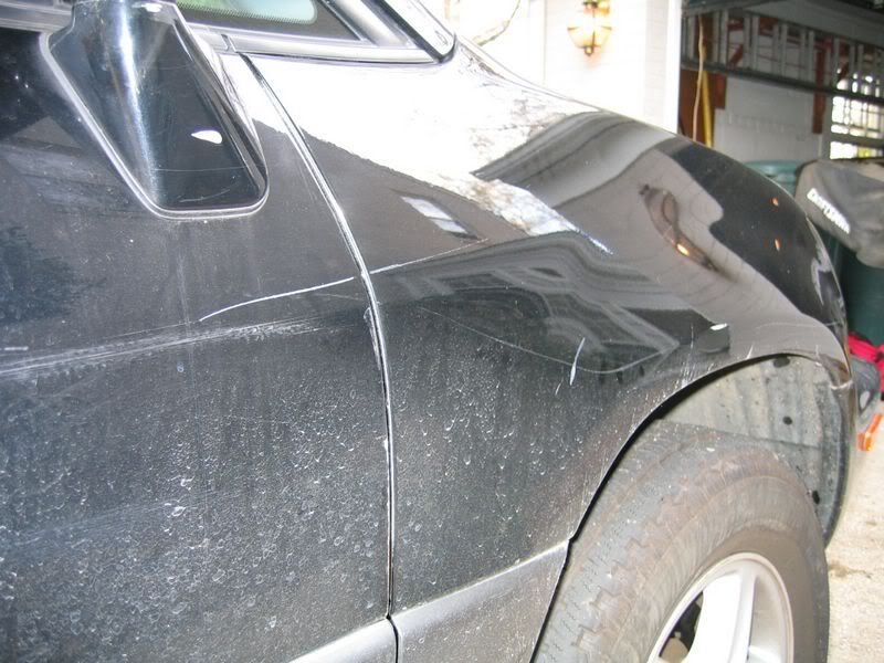

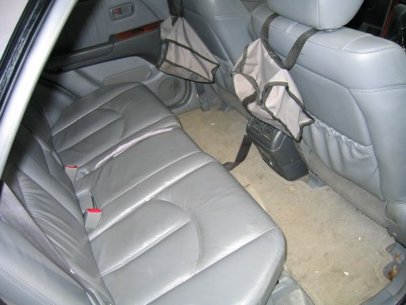

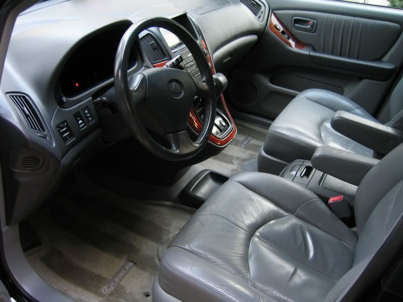

Inside was trashed by her 2 kids. Every inch in the car had to be cleaned. I mean every inch. Exterior was just as bad with tons of scretches, birdpoop (couldn't do anything with those)
interior
woolite
PB NL
before front
after front
before rear
after rear

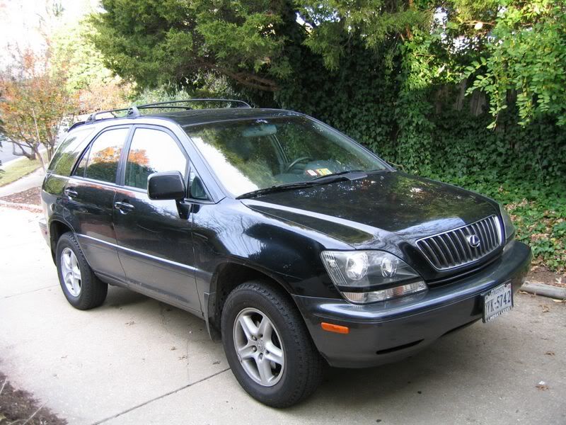

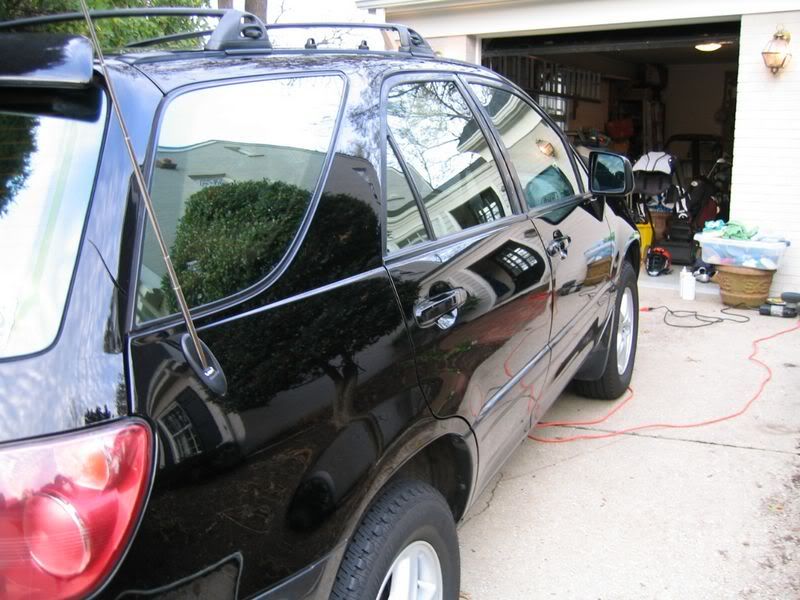

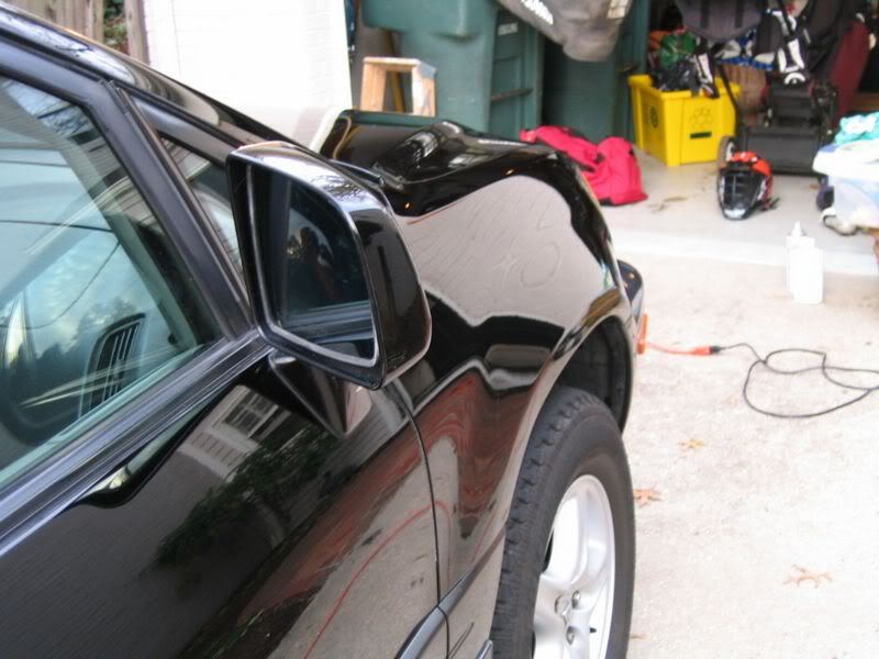

exterior
nxt wash/autopia clay
ssr2.5 with white LC pad on 6
PwC with white LC pad on 5
FK1 sealant with LC gray pad on 4 - this wins hands down when it comes to slickness - UNREAL!
Meg's tire shine in tires, and wheel wells.

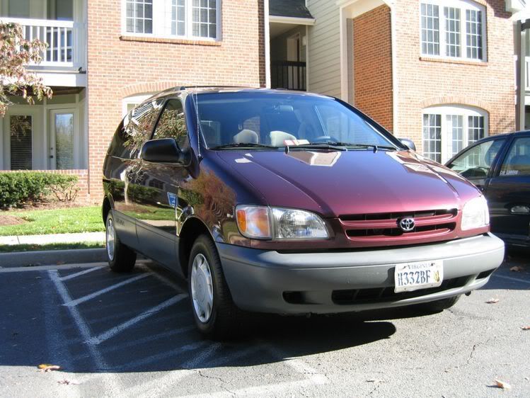

2000 Sienna LE
My girlfriend's van - will be for sale. She is getting a 2005.
Last worked on it on 6.14.04. and received AMINO UV Polish/Sealant After washing it with NXT (has not been washed since but once I think) the paint still felt somewhat slick, but no beading.
nxt wash
clay
ssr 2.5 LC white polishing pad on 6
PwC blue polishing pad on 4.5
Natty's by hand with yellow foam pad
I did a full interior as well, but didn't bother taking pictures. The car was full of swirls but thank ssr 2.5 most are gone.
The Van is gettin another coat of Natty's this Saturday. I'll take better pictures. The car looks awesome.
MMMM! I love carpet lines.
Have you tried using an oxyclean mix for carpets? I found that it has a little bit more 'bite' with stain removal that Woolite.

But you no like the van? :D She looks so nice and wet as well.
tdekany said:
Thanks Scott for the kind words.
I like the van but I am on dial up. My download timed out before the pics of the van loaded.
Looks really good though. Super wet and reflective!
tdekany said:
Gracias! I figured that not too many people are into Siennas but it is all about the shine. :D
The new Siennas look awesome... I really like the XLE Limited in Phantom Grey Pearl :bounce
Navi, rear DVD entertainment, and HIDs... if it had a better leather interior, they could rebadge it and sell it as a Lexus ;)
On your gf's Sienna, are the grey bumpers painted or are they plastic?
yes we like the new ones too. However I think she is going with another LE version. In gold I believe. Their silver isn't a great silver. She doea want a DVD player though. A JL 10w7 along with a JL 500/1 is sitting in my closet waiting to be installed.
woohoo, love the sienna the best! ;) the picture of its trunk is like liquid metal! :D i'm sure you'll get top dollar for it.
great jobs. the lexus, super transformation! :xyxthumbs
How do you like ssr 2.5? I currently use ssr2 with a yellow pad and like the results, but was wanting something just a little more aggressive. Especially since you are using the white pad, I'm really anxious to hear how you like the product/pad combo.
That's a combo I'd really thought about using. I was debating about using PI-IIIRC with a white pad too but I'm pretty happy with the poorboys line. Thanks.
