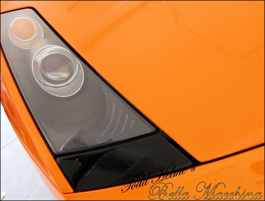

The plastic lenses of the headlamps and taillights where slightly hazed from micro scratches. The headlamps also had light scratching from days at the track. Menzerna PO106ff was used with a 4 inch beveled edge Lake Country Pad in white foam for multiple passes to remove the surface damage and restore clarity.
The taillight had hazing and what looked like rotary trails.
Light polishing for several applications improved the surface considerably as evidenced by the ?tightening? of the reflection of the halogen light?s reflection.

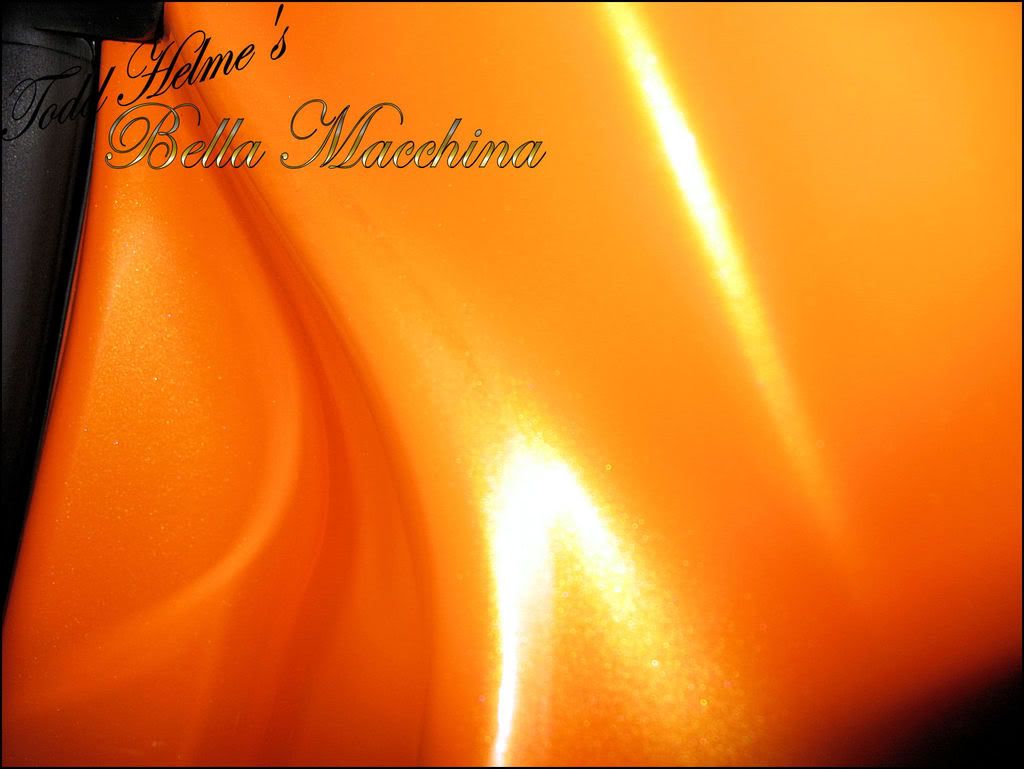

Day two started at slightly after 8:30 AM and ran until 8:30 PM. Using 500W halogen lamps and handheld L.E.D. lights the paint was inspected for all defects that could rob the gorgeous color of its natural shine. Given the pearl accent and metal flake, the defects where hard to see and harder to photograph.
The paint on this particular Lamborghini was EXTREMELY hard, much harder then modern Corvettes and Audis.
Process- larger flat panels.
The larger panels (which allowed me to use full sized pads) received a four step process. First Meguiars' M105 Ultra Cut Compound was applied with on a Meguiars' So1o Full Cut Wool Pad for 3-5 applications to remove random scratches and surface marring from the paint.
This was followed with Menzerna PO83 on a Meguiars' So1o Medium Cut Wool pad for one pass to begin refining and nursing the shine back into the paint.
Menzerna PO83 was once again applied, this time with a fine cut Lake Country Green Euro foam pad and worked long to remove any marring from the wool pads and increase the gloss dramatically. This left the paint 100% defect free and it looked amazing.
Final gloss enhancement came from Menzera PO85rd applied with a Meguiars? So1o Finishing Pad. 5 to 6 slows passes where made at 1500 rpm, before reducing the rpm and lighting jeweling the paint for several minutes until I was happy with the gloss.
