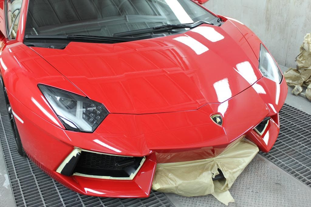

OK, let us see the pictures:

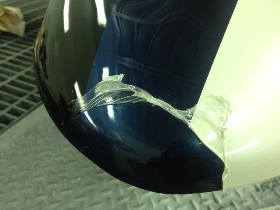

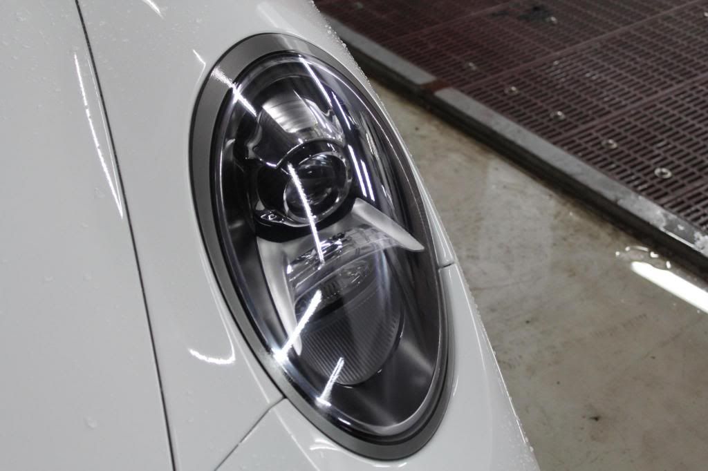

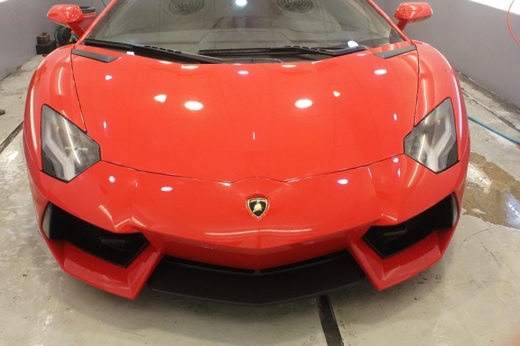

This car already had normal PPF on it.
But the customer don't like it, too many defects.
It apply by top worker, not worker's problem, it's material problem.

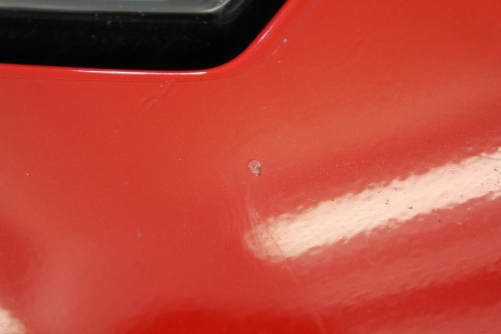

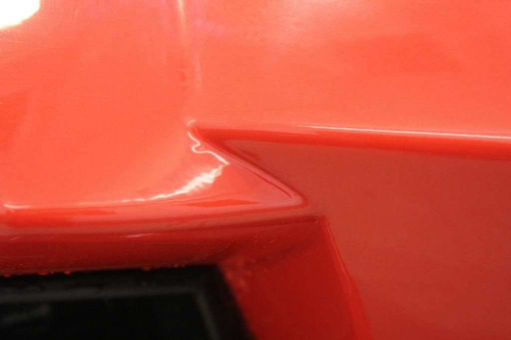

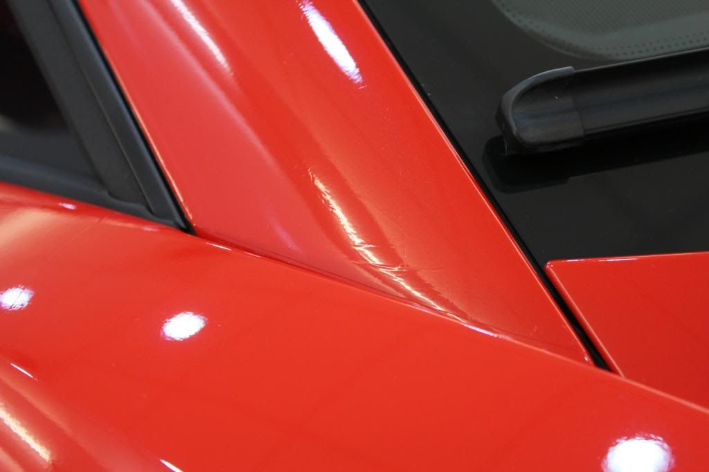

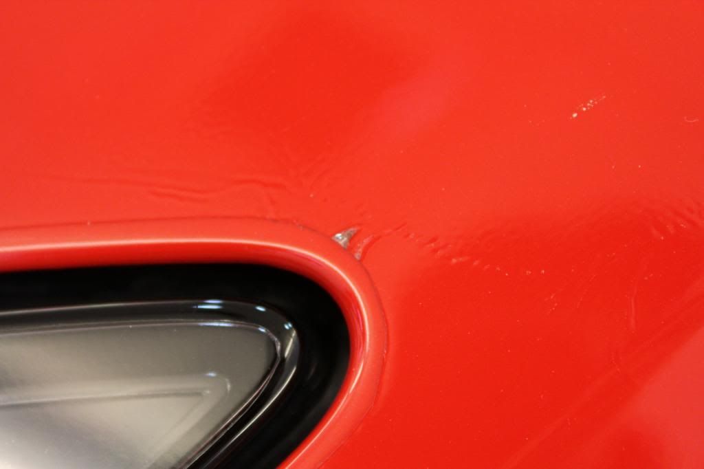

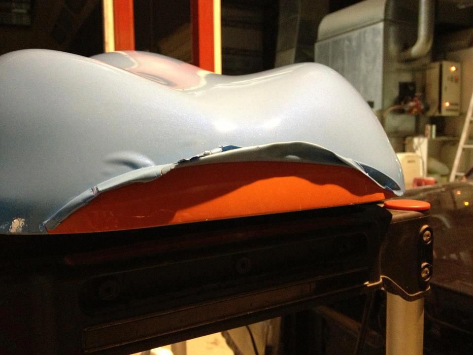

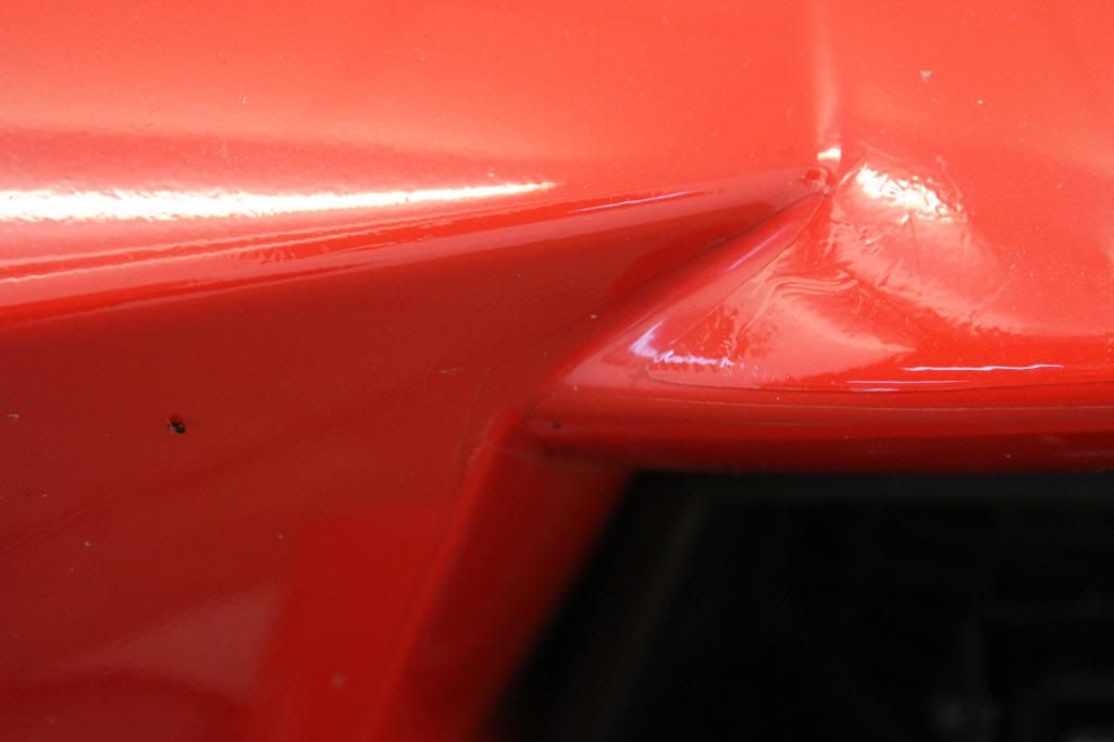

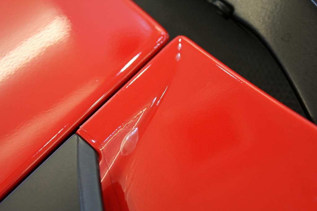

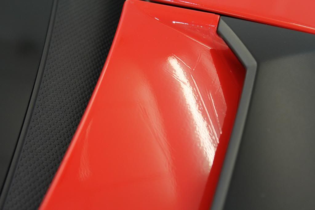

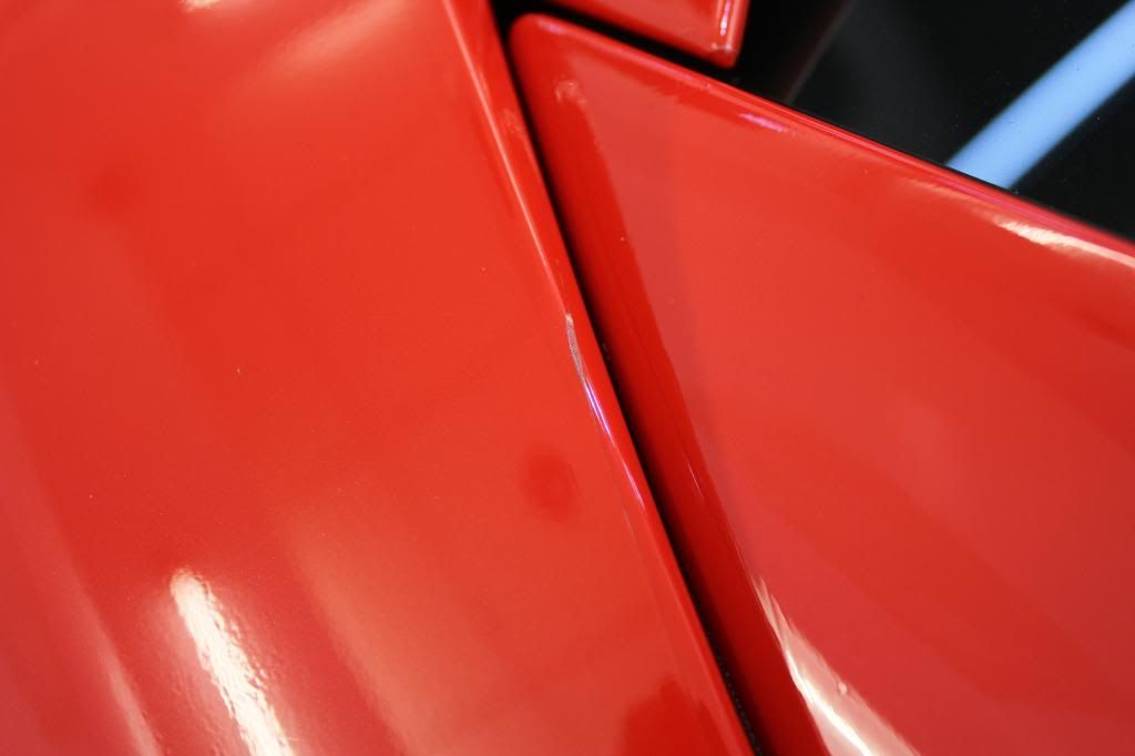

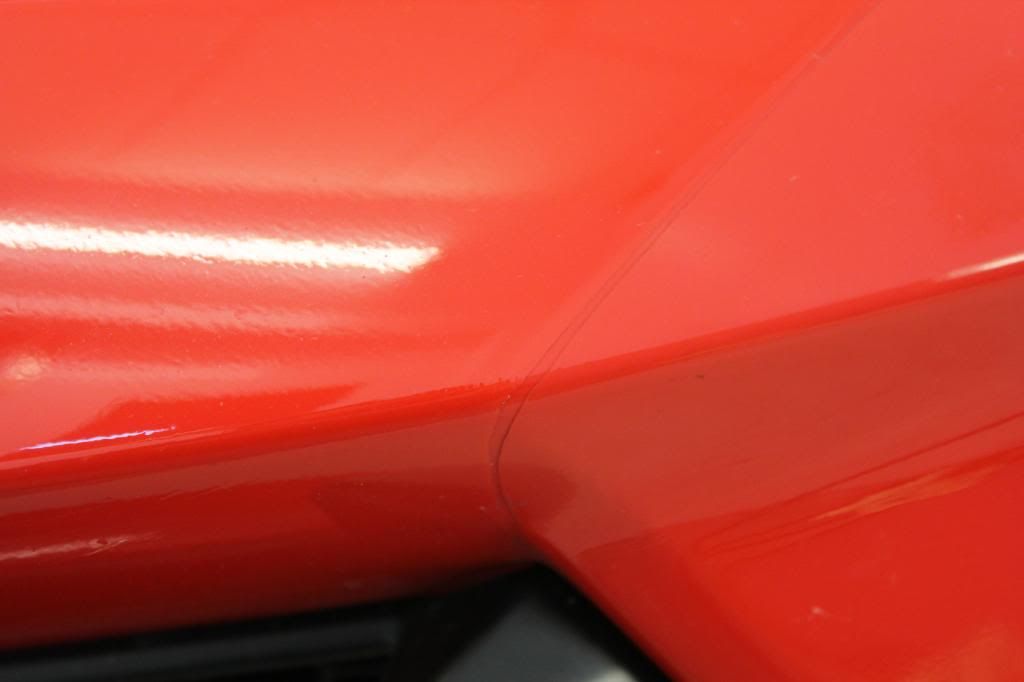

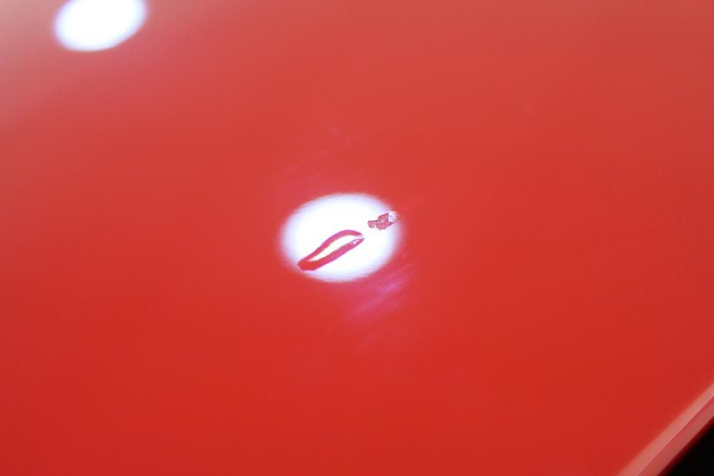

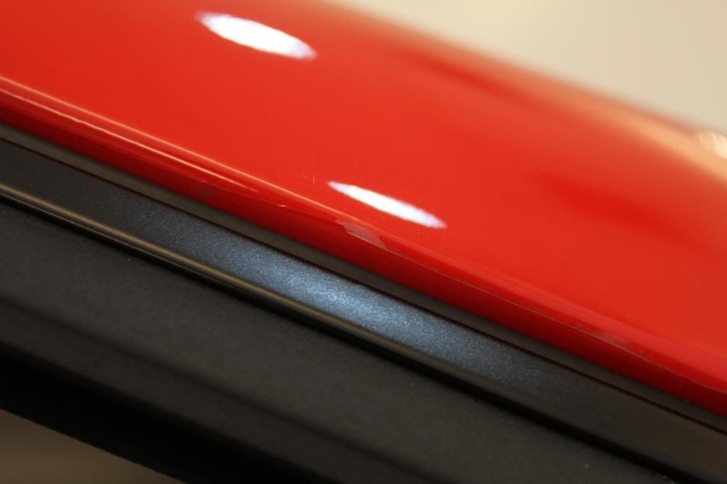

The normal PPF defects as below:
No one had idea for repairing these defects. Only remove it, do again.

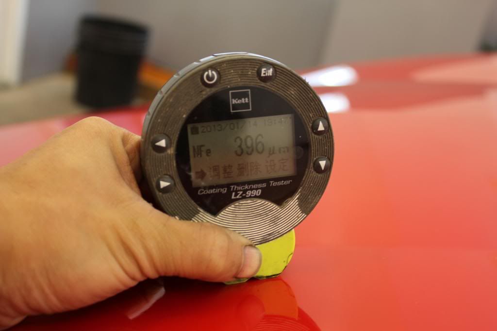

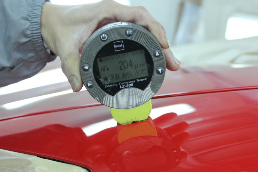

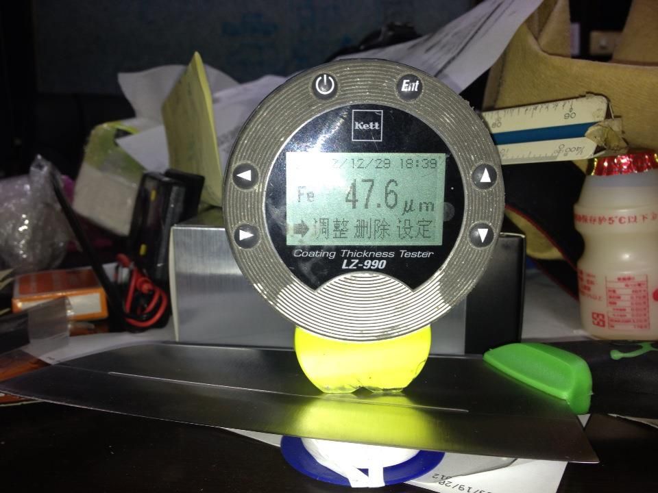

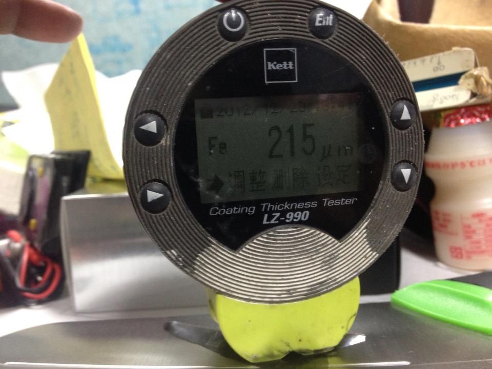

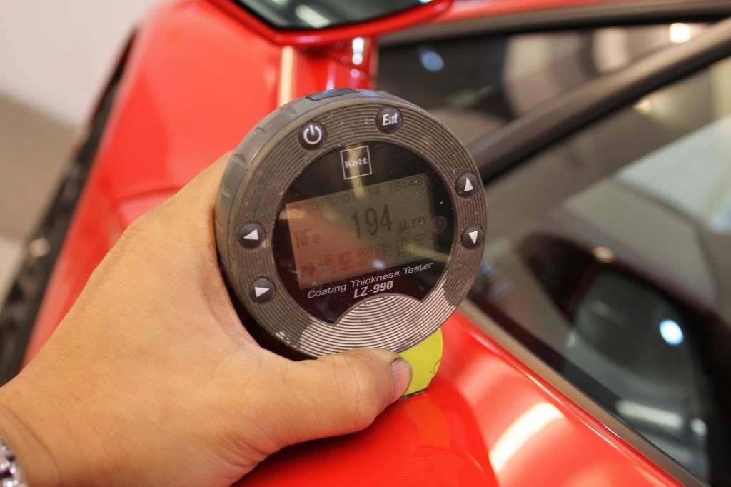

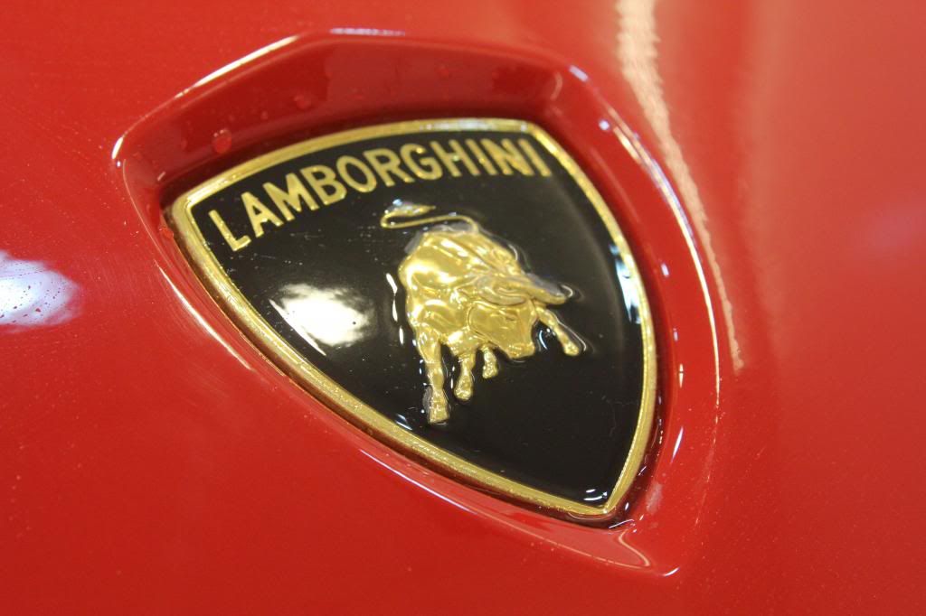

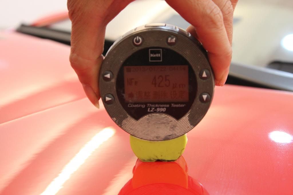

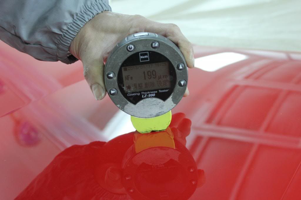

The PPF and factory paint's thickness is 396~420 um
Factory paint is 196~205 um

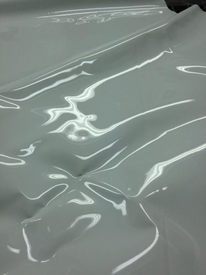

So, the PPF is around 200 um

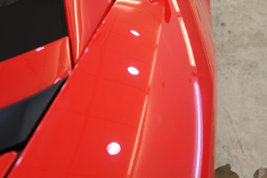

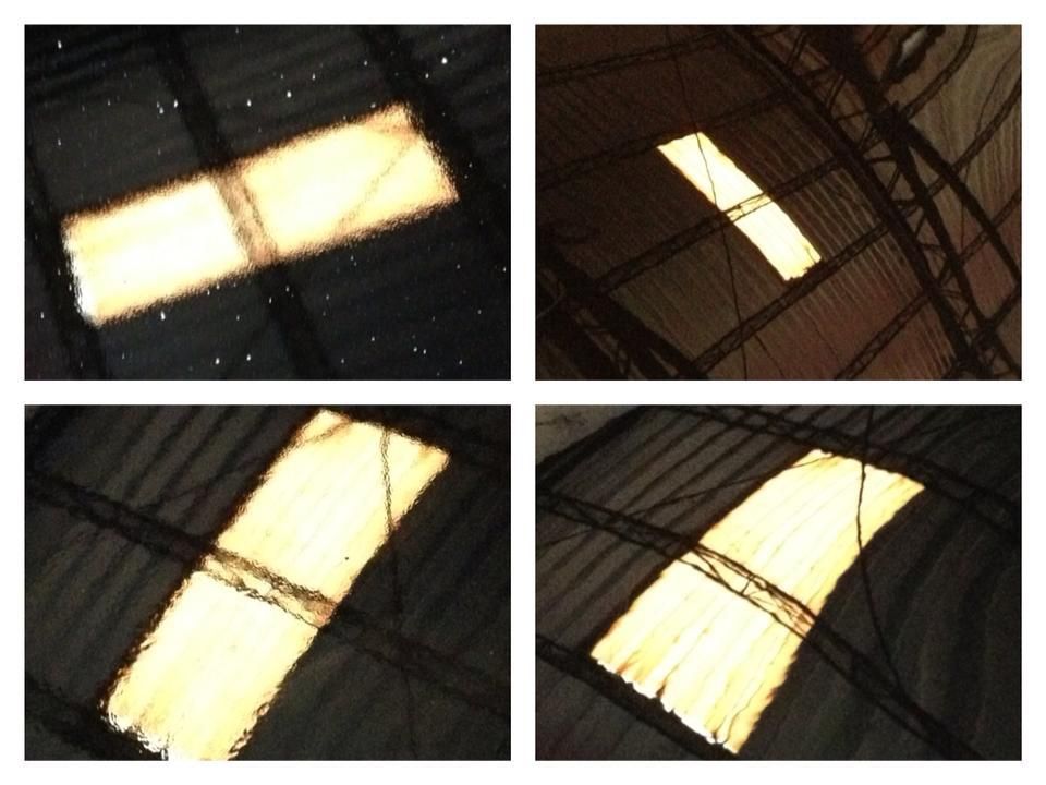

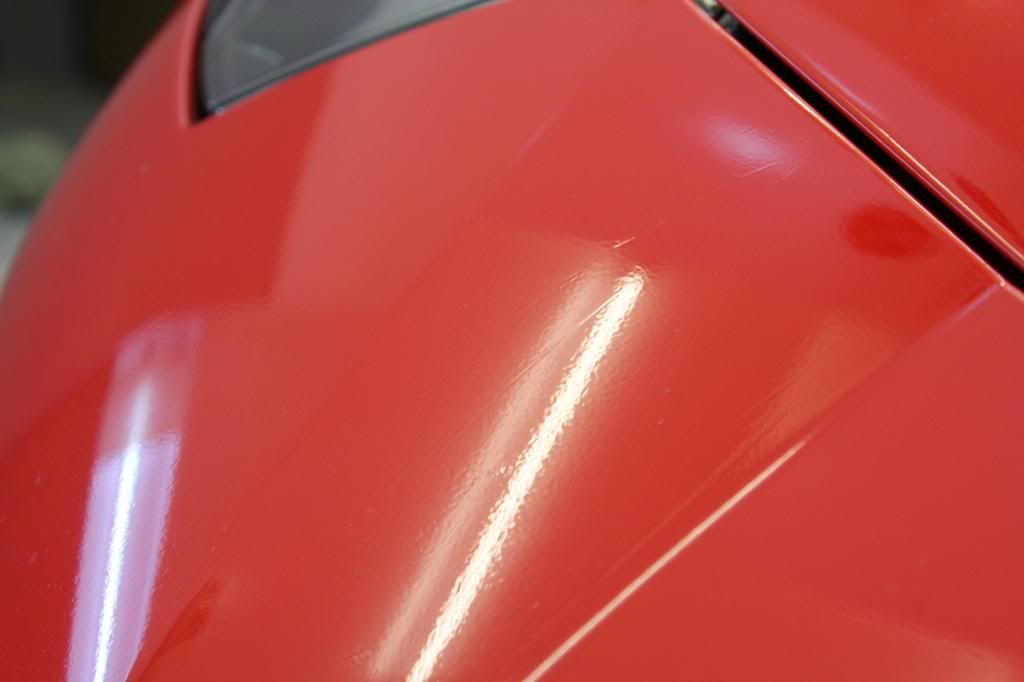

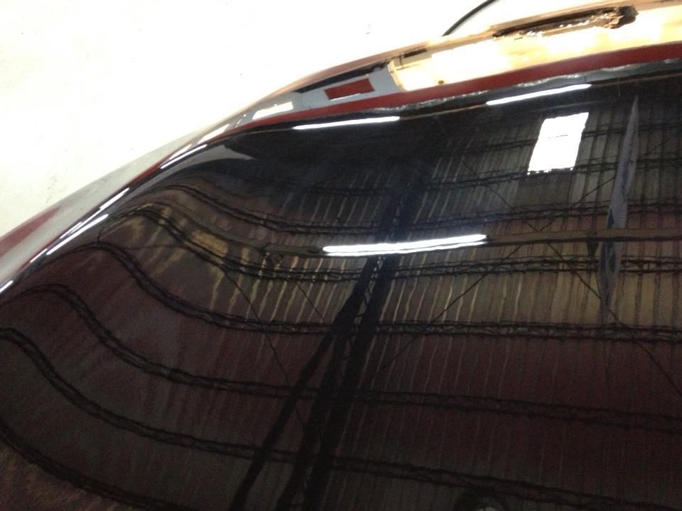

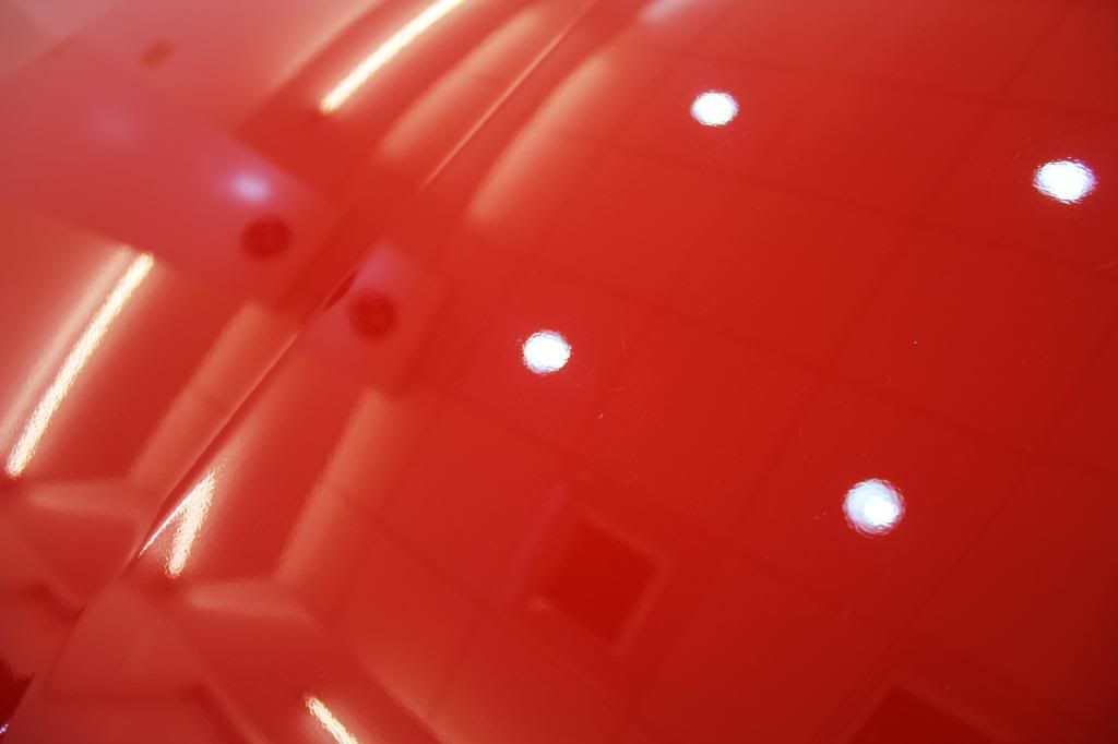

Serious orange peel

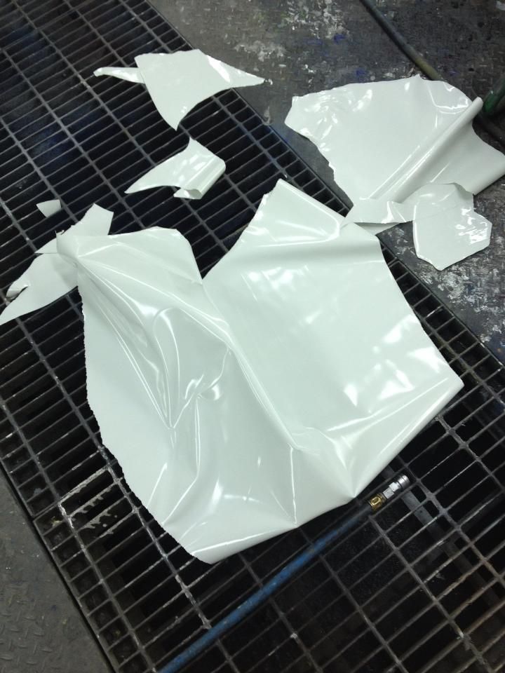

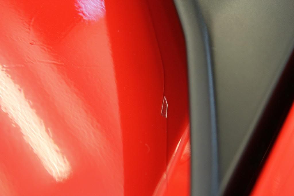

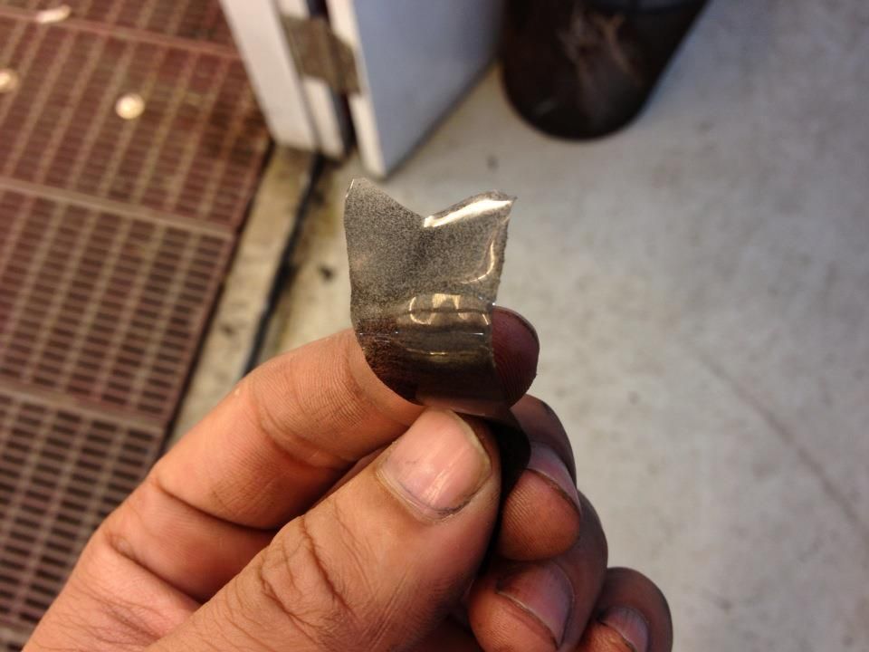

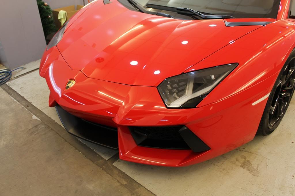

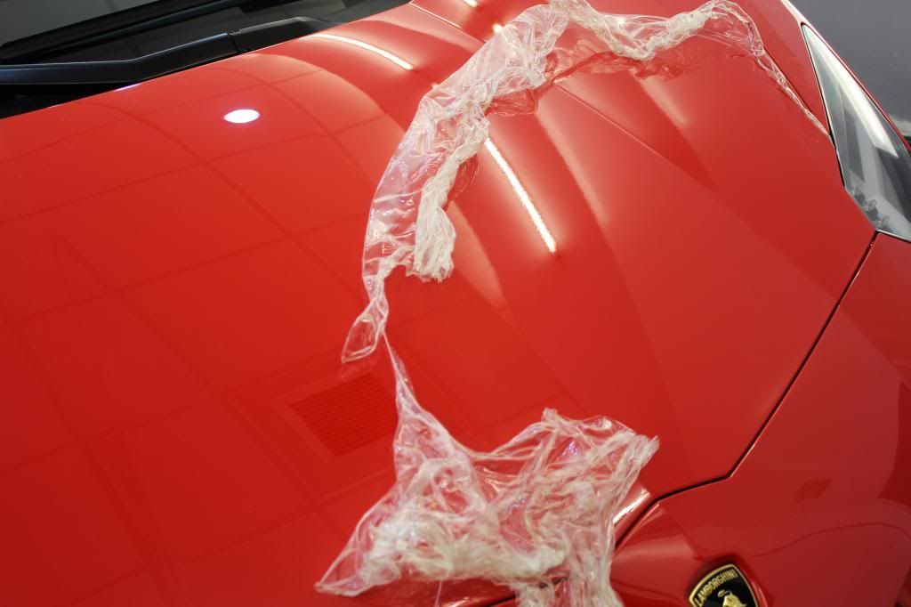

After remove it, we polish and clean it.

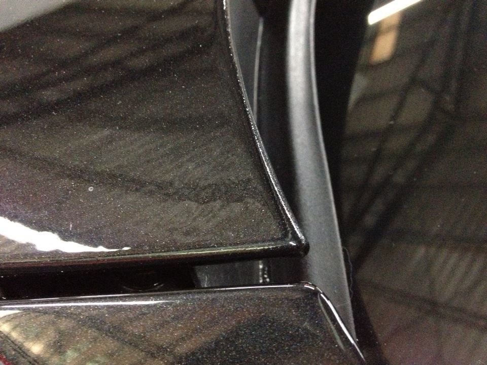

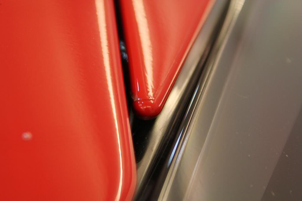

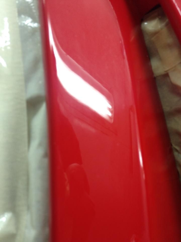

Then, we found big problem:

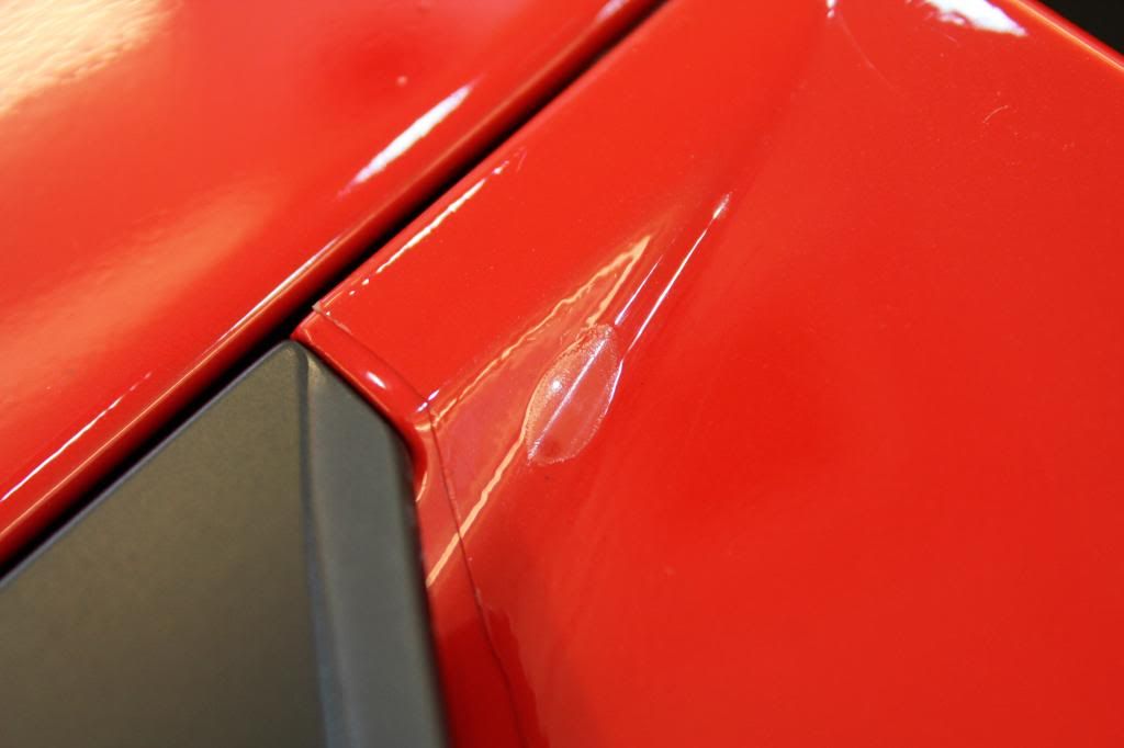

there are bubble inside the paint, maybe the worker heat the PPF too much.

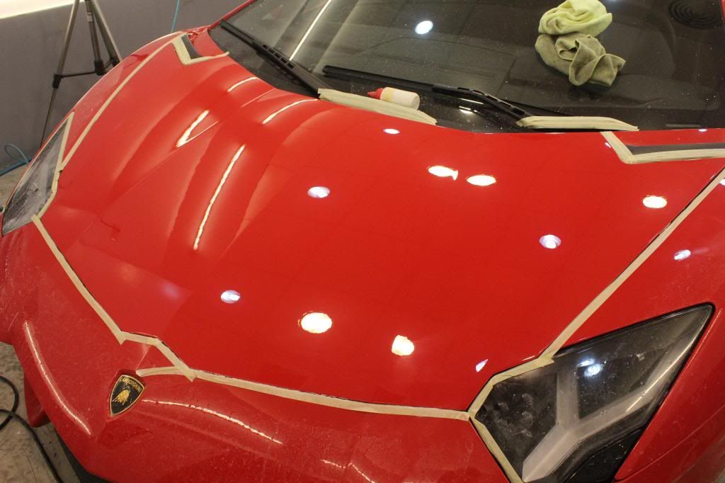

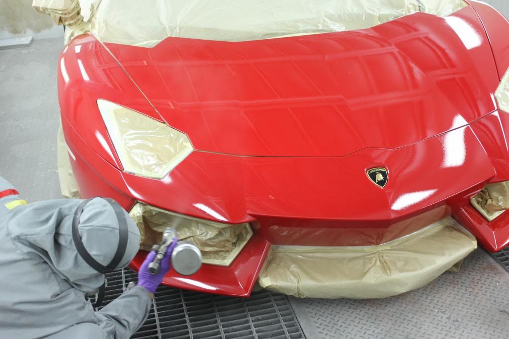

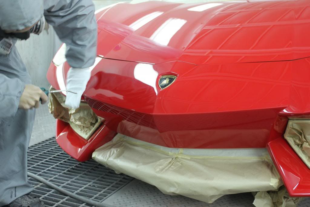

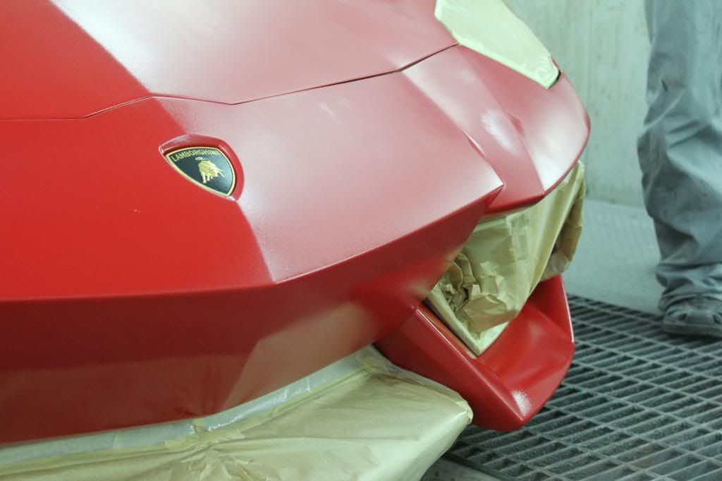

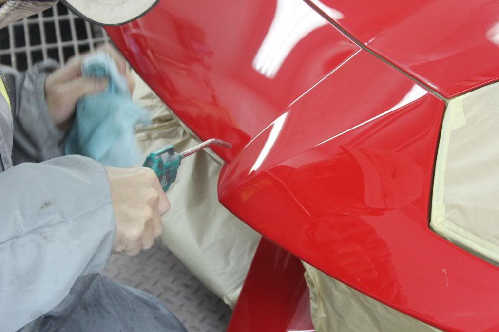

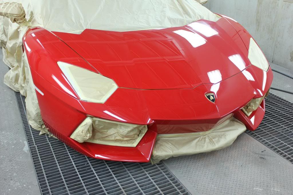

My painter repair this first

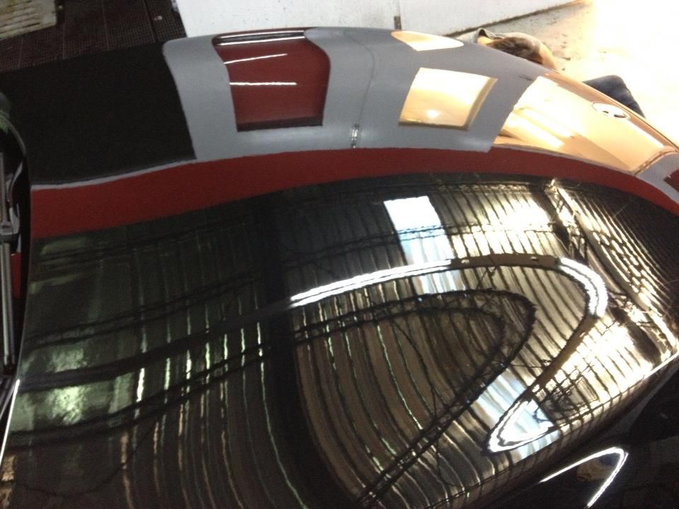

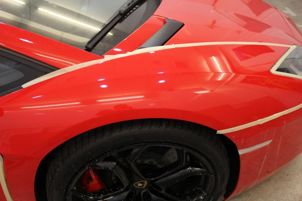

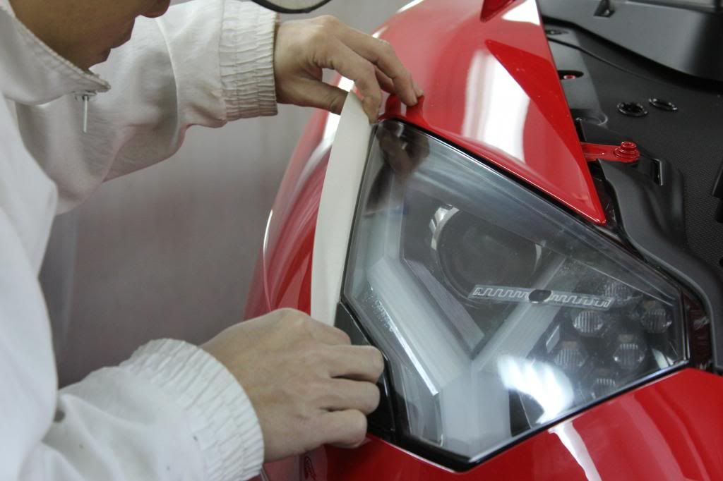

Then mask the parts.

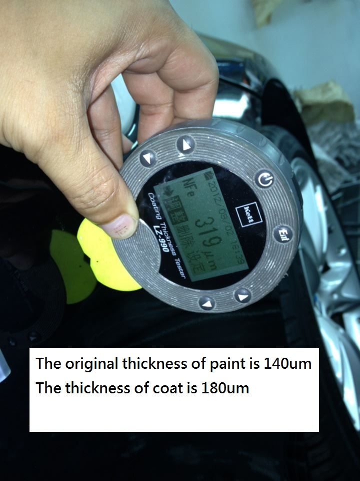

the thickness of paint is :

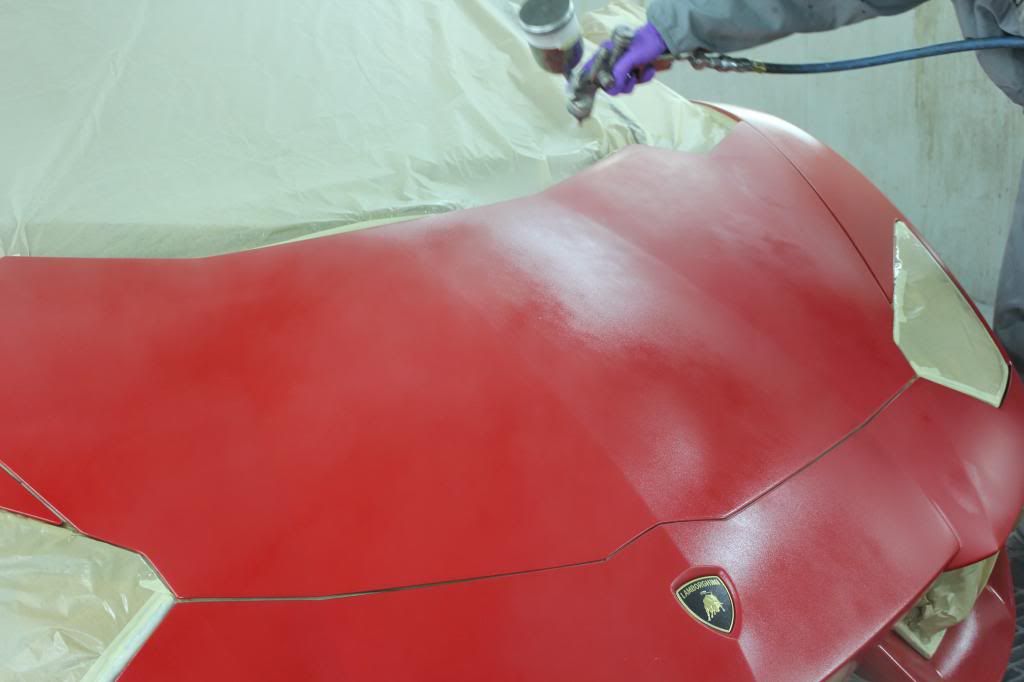

Before apply, need to clean again:

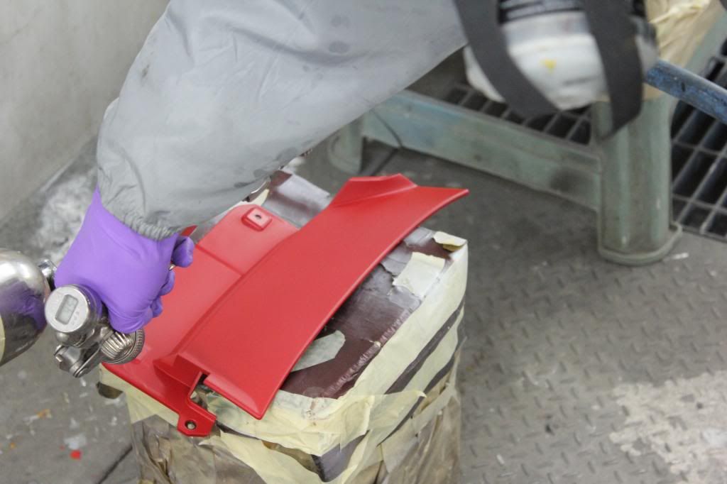

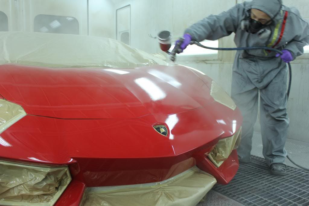

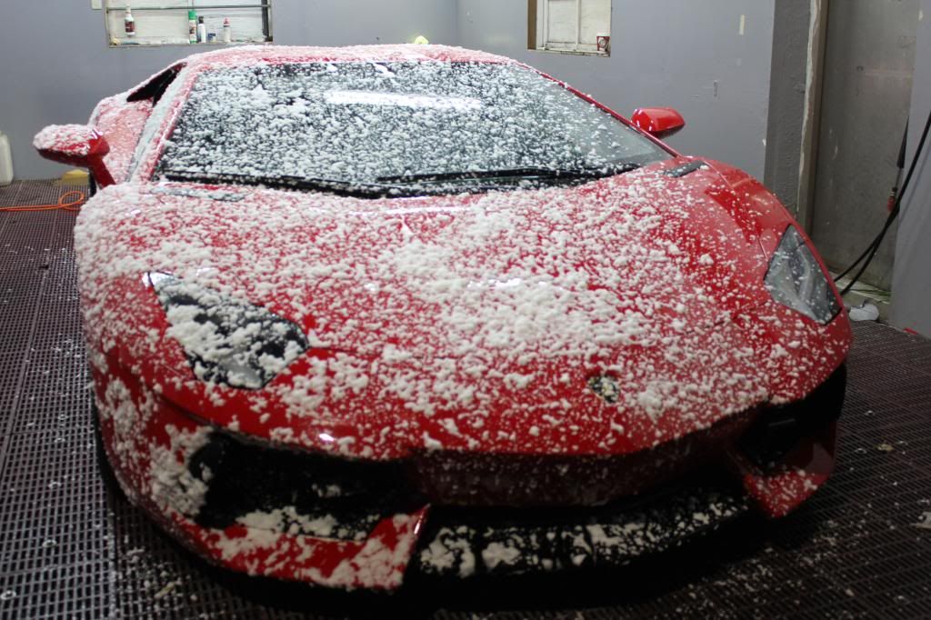

Apply the coat:

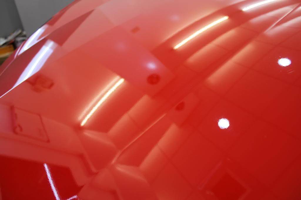

Spray finish:
When I am polishing it, customer call me, he want to join a party, need to use this car.
He will return back tomorrow.

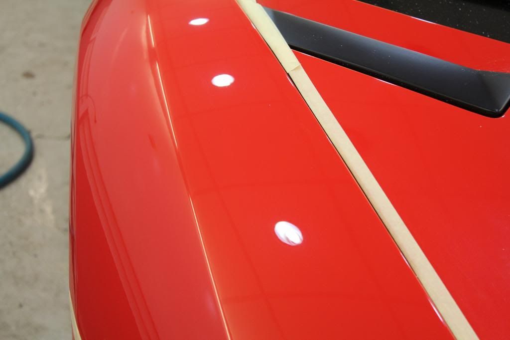

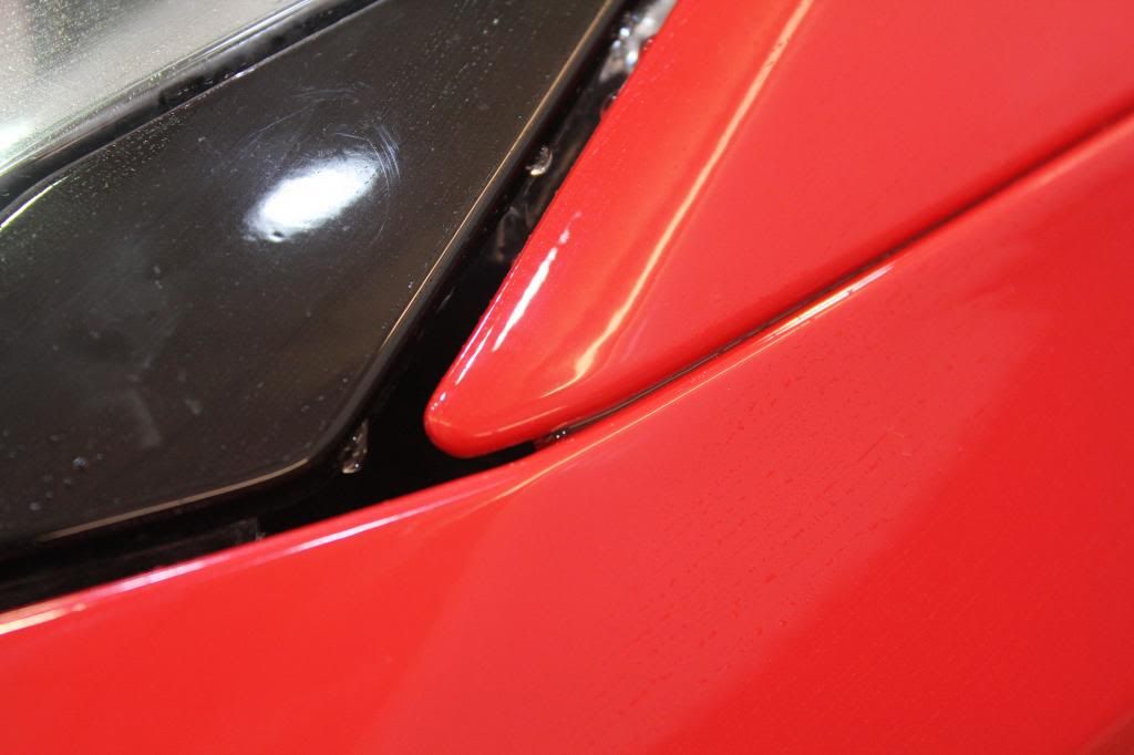

So, I only polish a area:
even no polish, the gloss is more better than normal PPF. :)

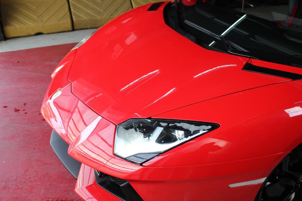

The car came back two days later.
Let us see the pictures continually...

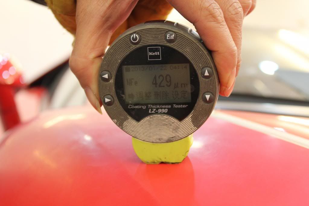

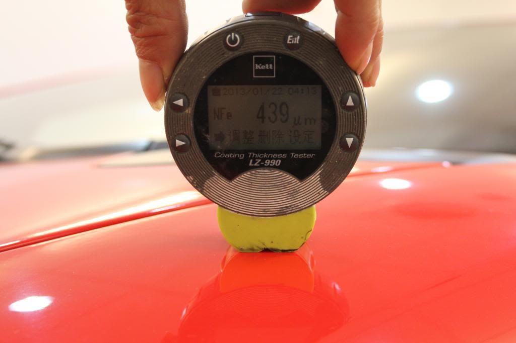

The new thickness of paint is:
So, the thickness of coat is more than 200um, more thicker than normal PPF.

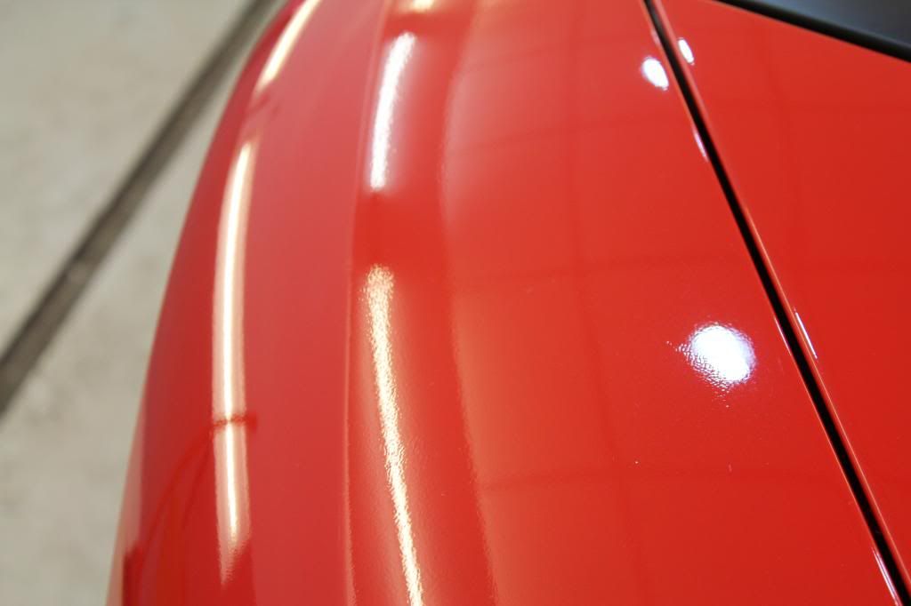

Grind it by 1500# sand paper
Then polish

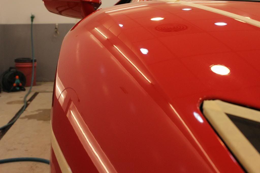

finish:

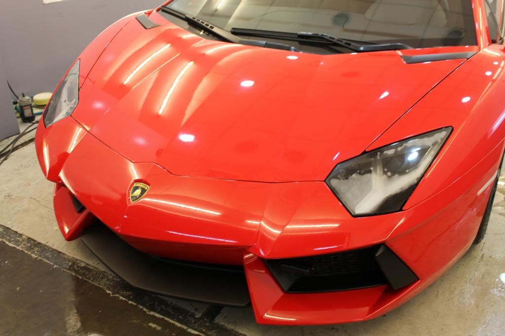

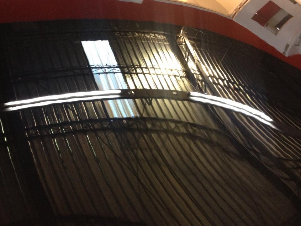

I'm sure that is more perfect than factory paint, not only than normal PPF!
all finished finally !
Almost can't see the difference between coat and factory paint

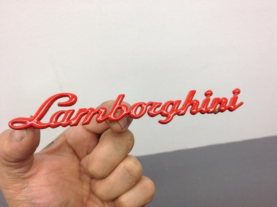

even the mark, we protect it!
Perfect solution for paint protection!

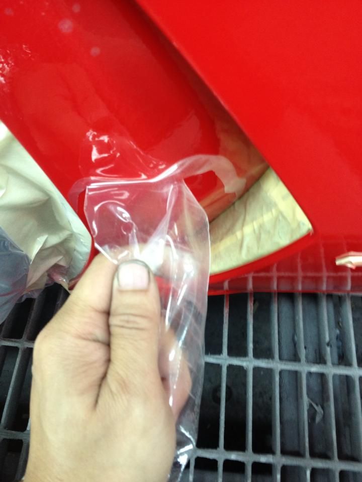

some people worry about not easy to remove this on future.
It's not difficult.
And factory paint had no any changed

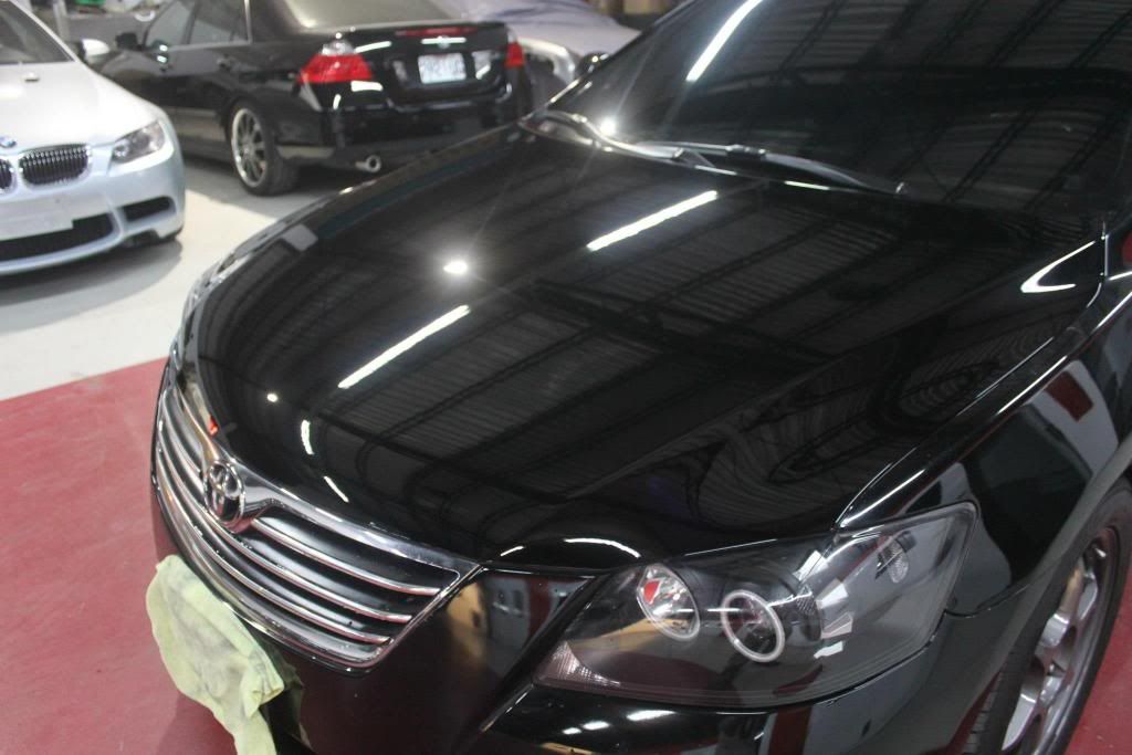

transparent

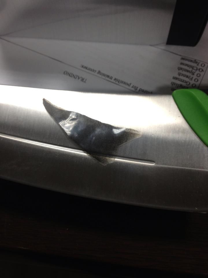

the coat can remove from the car
the surface can grind and polish

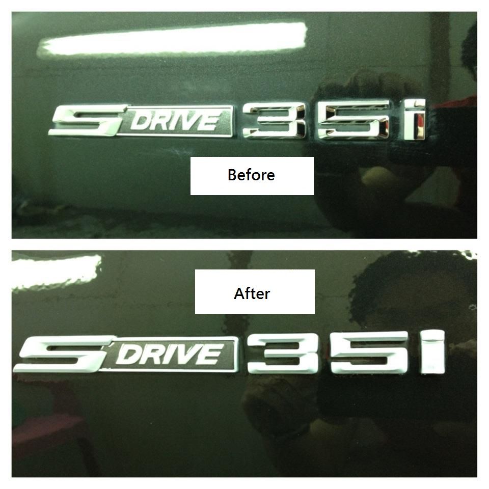

Any color you want
We already apply on some cars, it's the perfect solution for protection the factory paint!

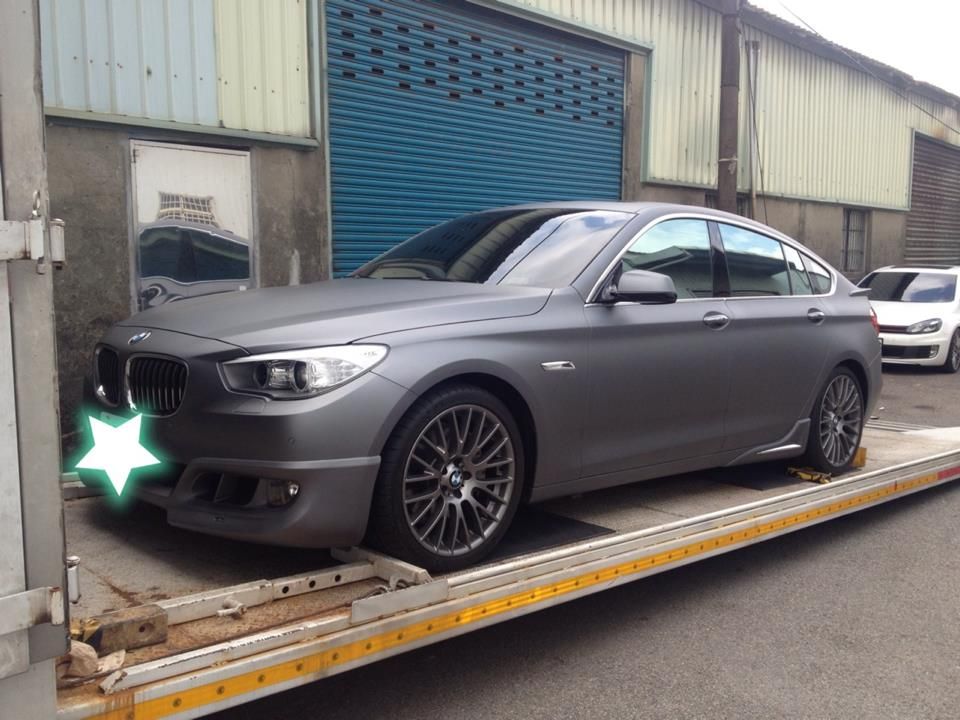

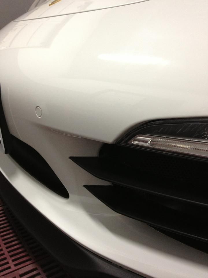

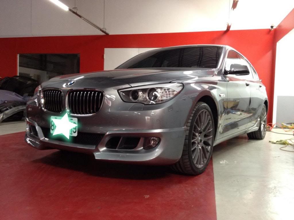

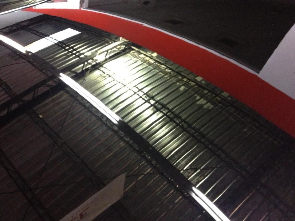

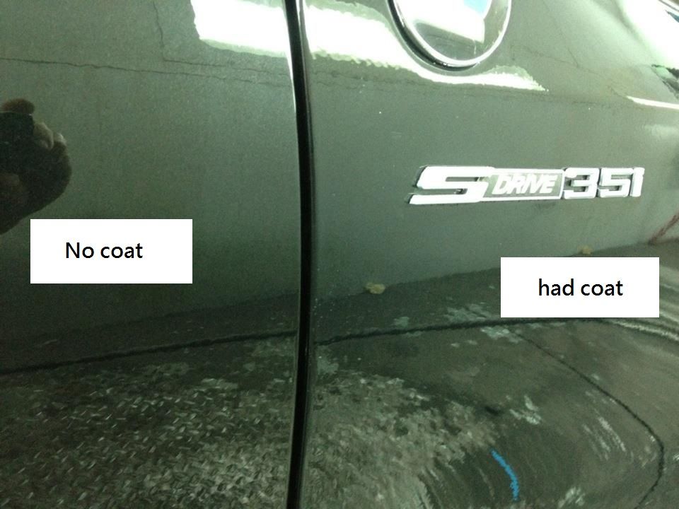

Before:

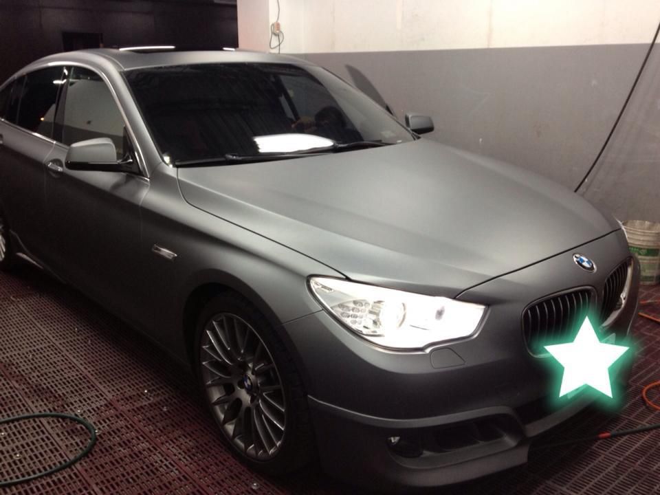

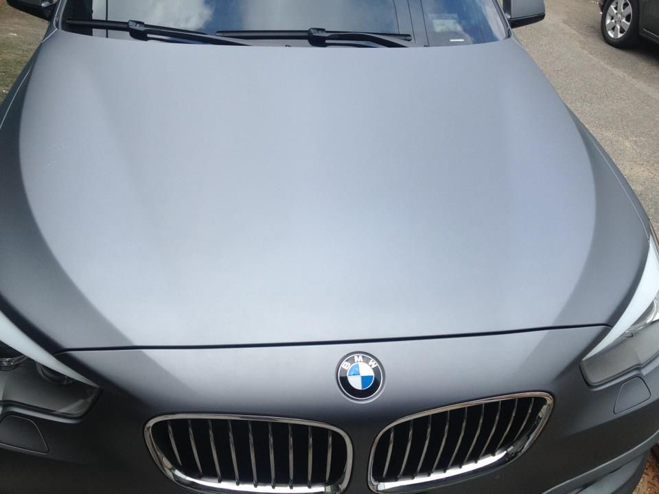

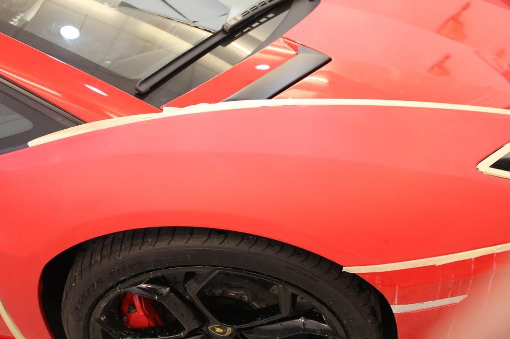

After: (Matt coat)
transparent coat (Hood)
transparent coat (Full car)

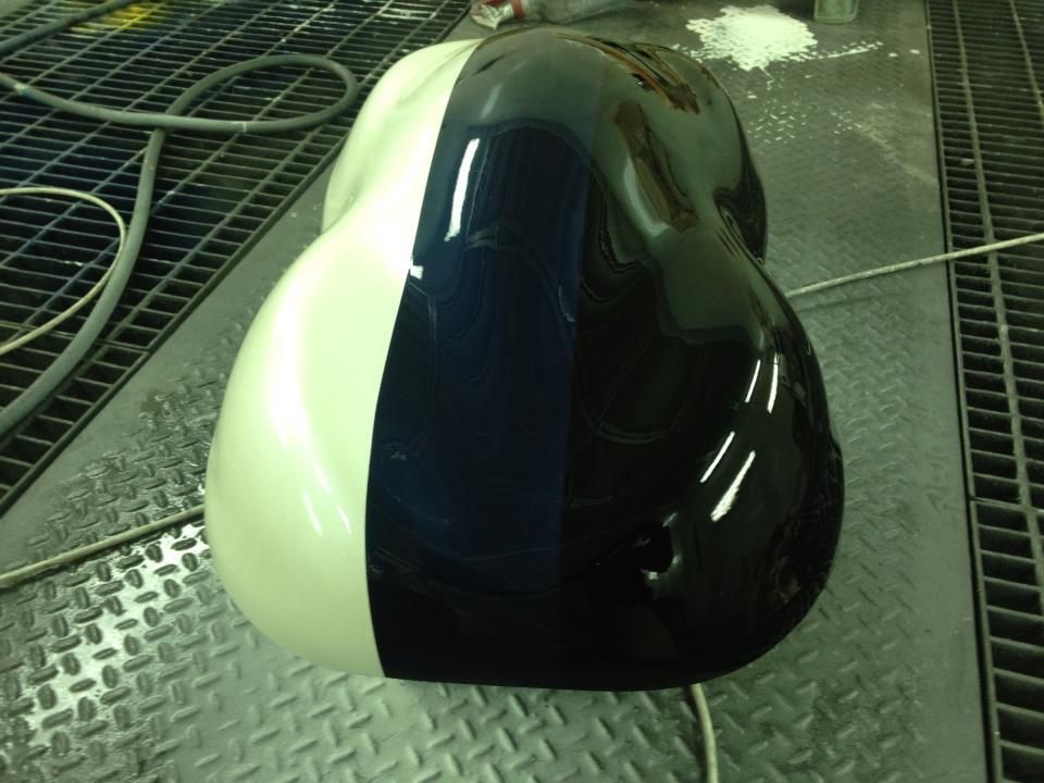

Finish coat on the hood

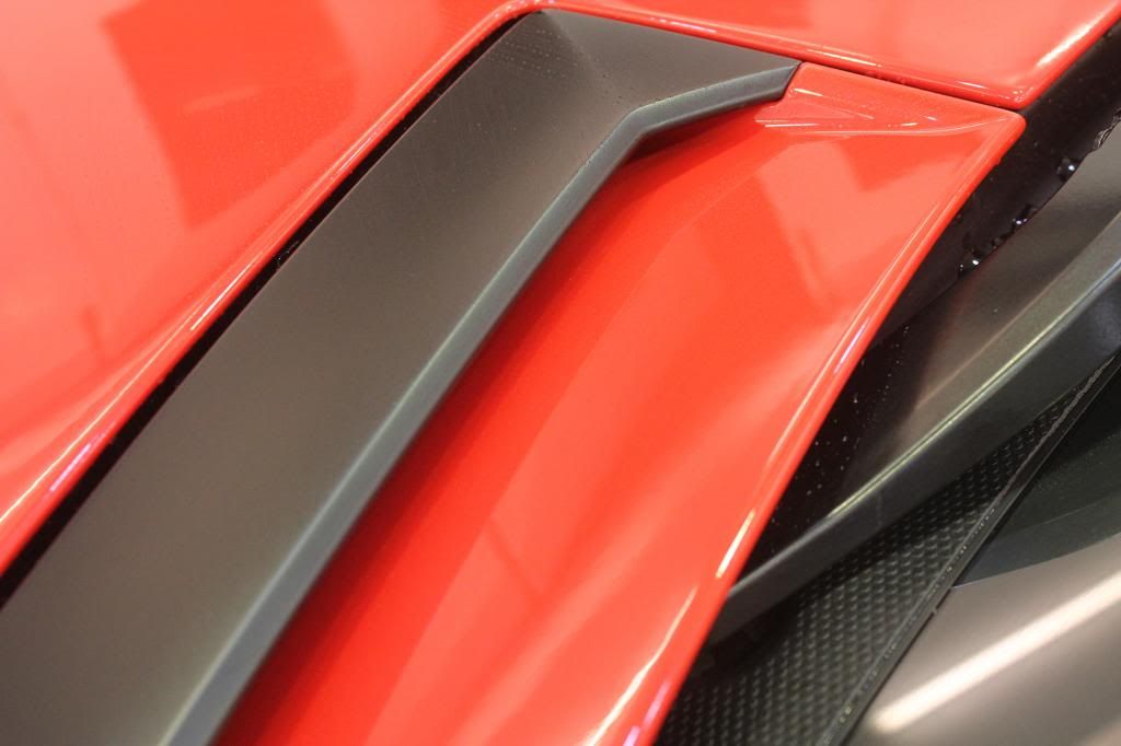

Because the hood had many chip, so we use the color same as original to hide it.
Thickness of coat is 167.4um

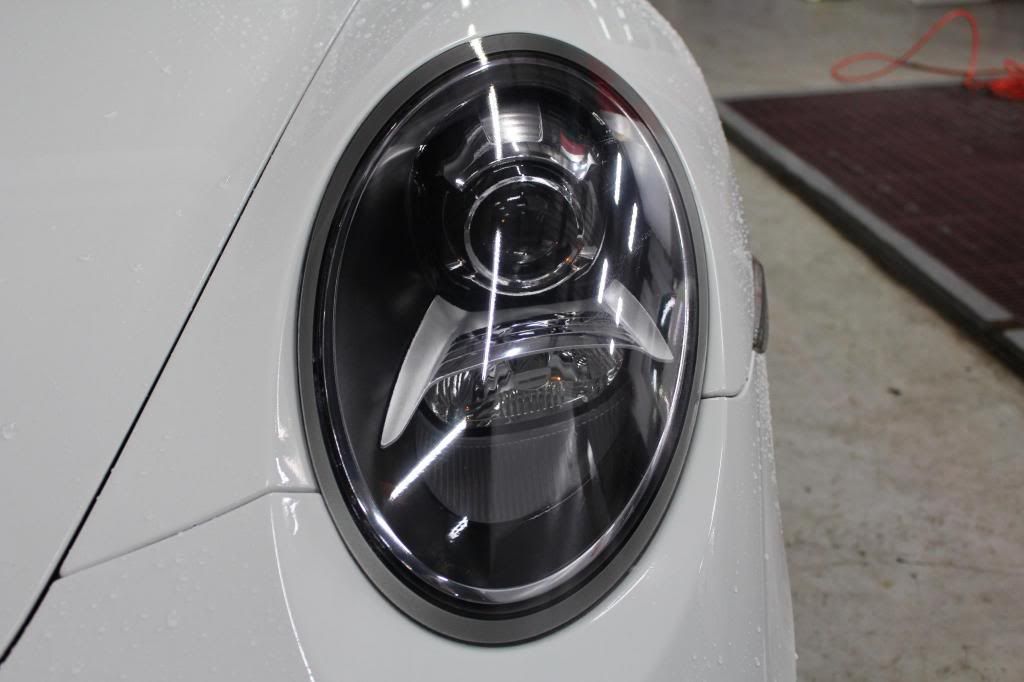

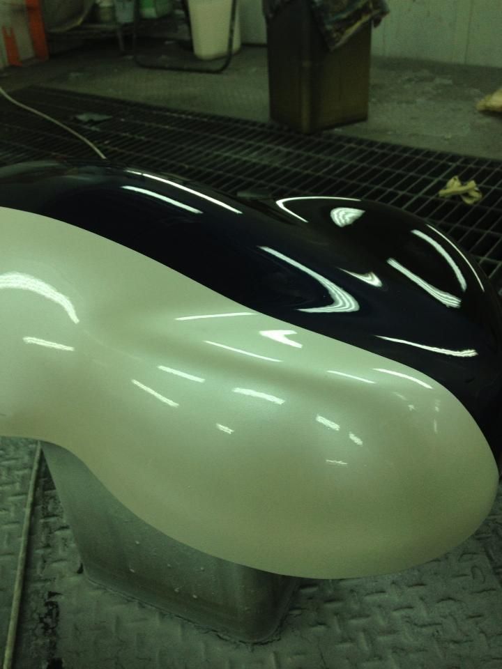

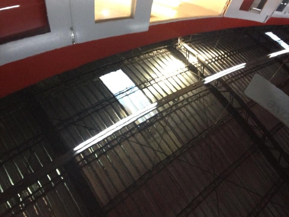

It can apply on any thing

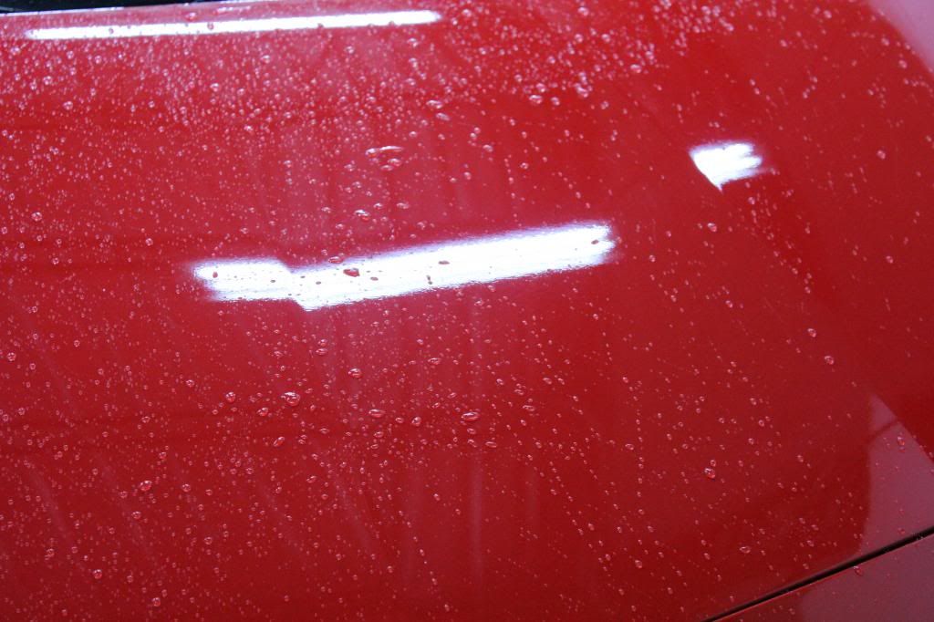

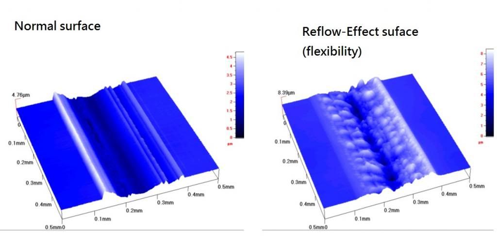

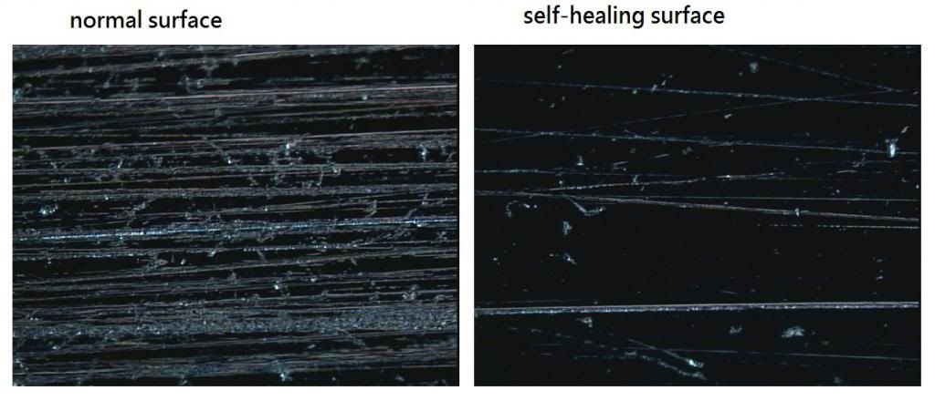

The coat's surface is nanocomposites coating, hydrophobic and self-healing for scratches.
What is self-healing:
It is not growing back, it's revert back to its original state.
The correct name is: Reflow-Effect
let we see the picture as below:
When normal surface damaged, the material is scraped away.
When Reflow-Effect surface damaged, the material is indentation.
Whe the material received heat, it will revert back to its original state.
But the important point is even one surface had reflow-effect function, it must also have anti-scratch function.
Both of these features, it is called "self-healing"

1. how do you peel the coating off ?
2. So it comes in colors like matte and clear ?
3. When you say it can polish and grind do you mean we can use woolpad and rotary speed 1500rpm like that on that coating ? It looks like i don't know what..maybe clearbra ?
sulla said:
Orion couple questions
same as peel the PPF off
