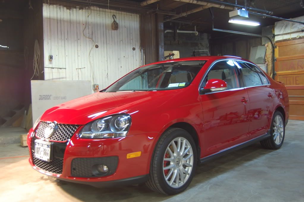

A client recently contacted me asking when I could get to this car. He traded his old VW in and had just picked up this Salsa Red GLI about a week ago. He wanted to get it looking good as soon as possible. I had hoped it wouldn't need as much work as his old VW (detail thread: http://www.autopia.org/forum/pro-details-before-after/123873-couple-vw-s.html ). Well, we were in for a rude awakening. I spent 19+ hours on this GLI myself, not counting my help from my business partner and the owner! Anyboy have a suggestion for somthing that will speed things up on hammered cars?
The car sat at the local dealers used car lot for a few months and it appears they run them thru the tunnel was at the dealership non stop. Every square inch of the car had deep linear marring which made polishing out all the RIDS a never ending task. We got the car to about 95% corrected.

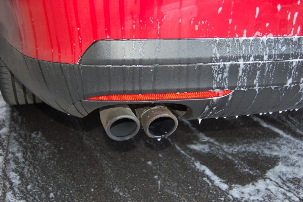

Exhaust tips before:

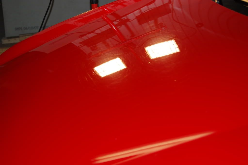

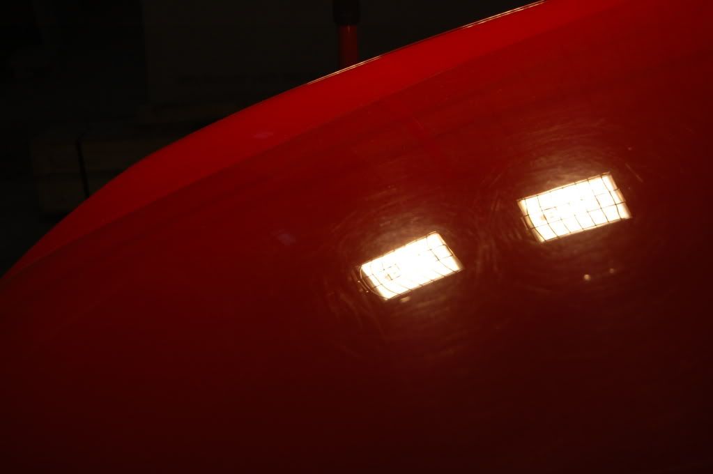

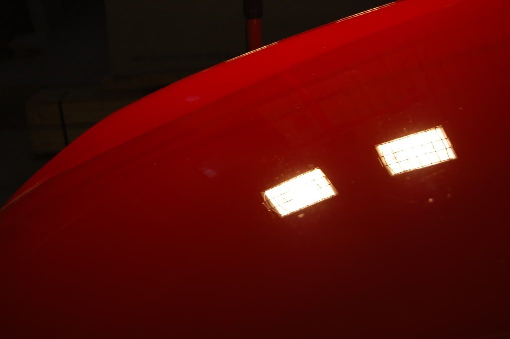

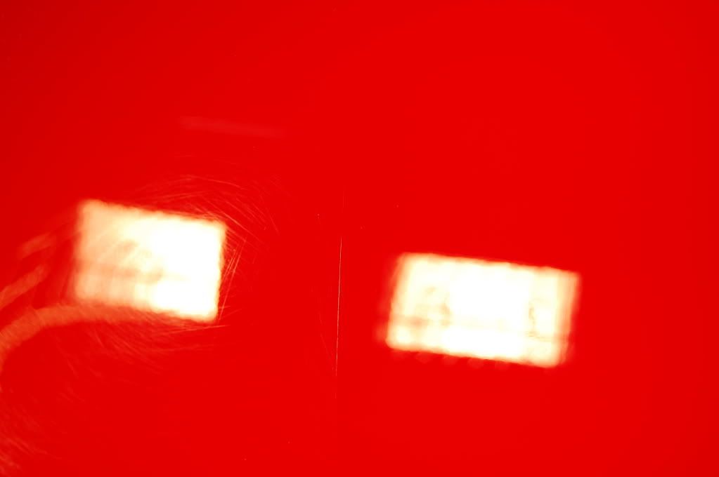

Hood before:

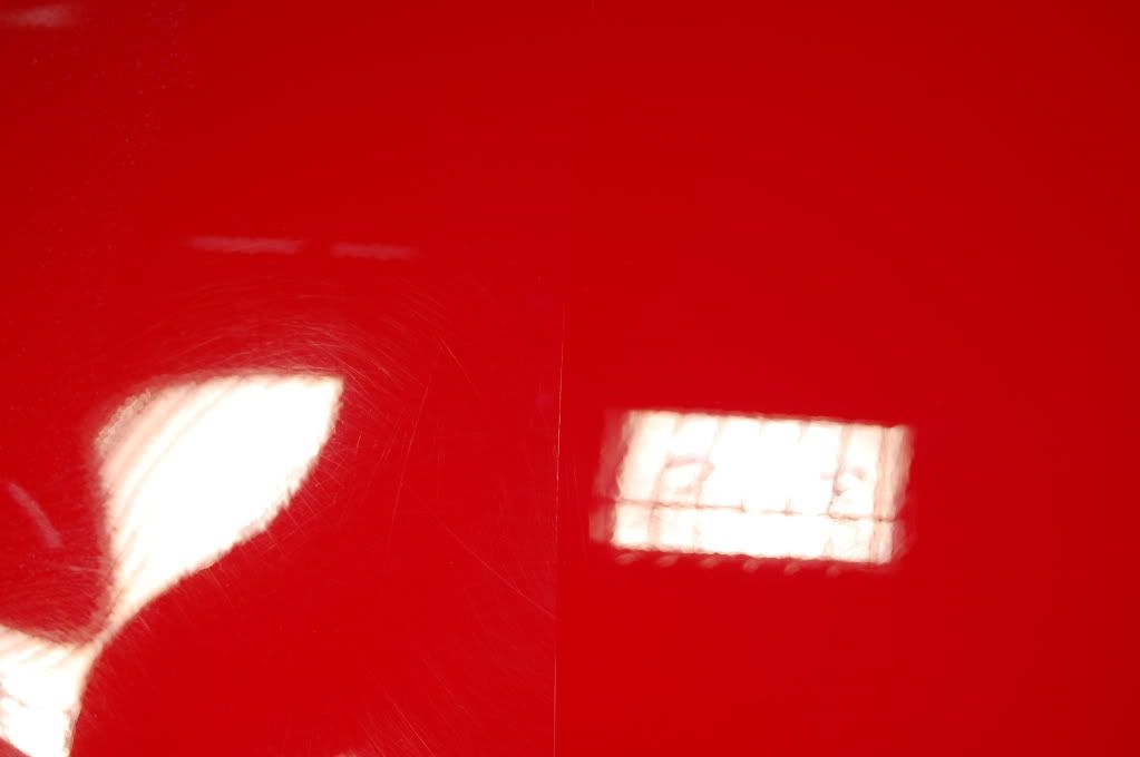

After 105:

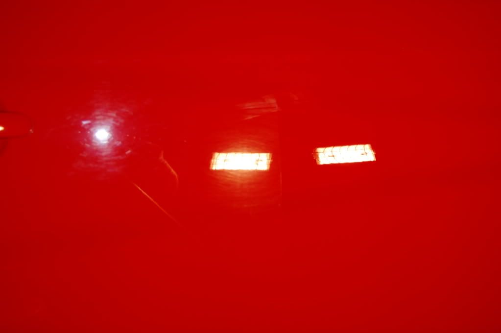

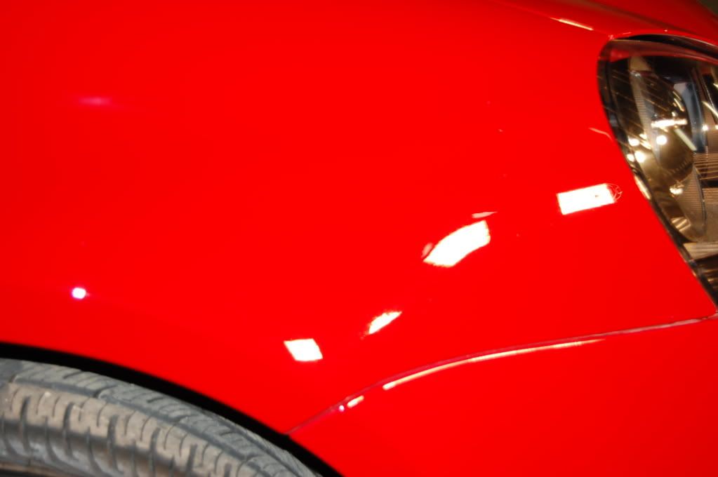

Various 50/50 shots after 105:

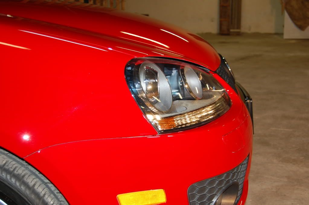

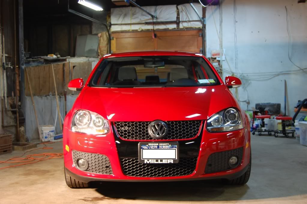

Finished:
