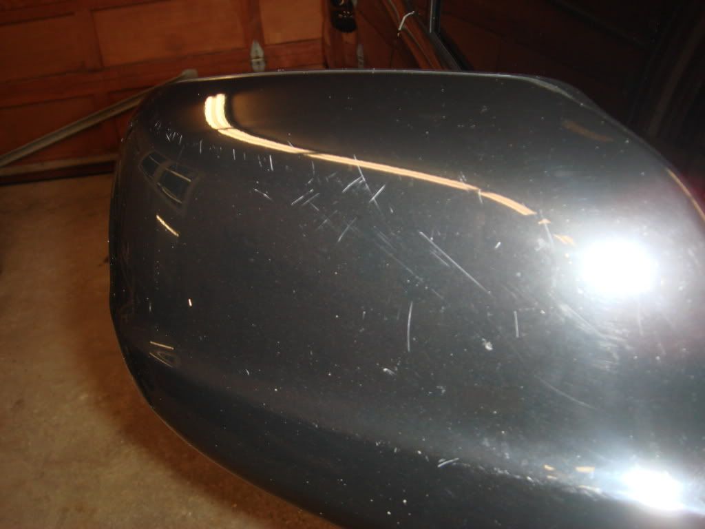

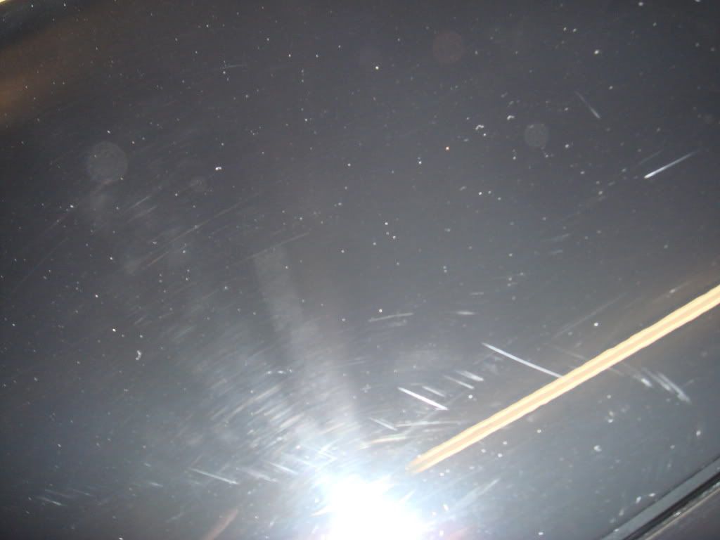

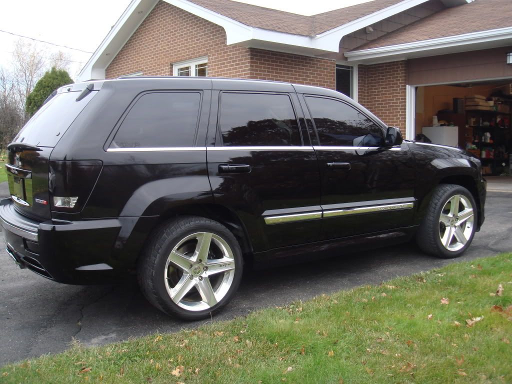

i spent 5 evenings restoring the paint on my Jeep, it was absoutley horrible and im ashamed I let it get that bad. I started out with a hand wash and dry, claybar, and then moved onto the porter cable with a heavy cut, cleaner polish with light cut, machine glaze, and finally wax and buff. I also did the interior.

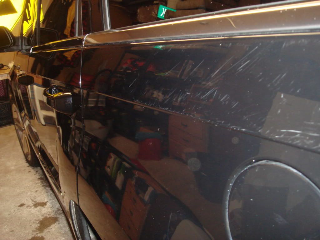

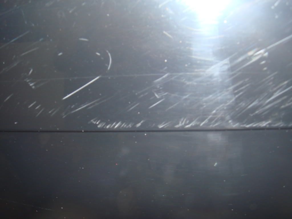

As you can see there were scratches, heavy to light and CRAZY SWIRLS!!!
I used a PC with orange white and grey pads with Meg's Mirror Glaze products.
This was a my first time using the PC but i couldnt be happier with the results. Here are the before and after pictures!!!

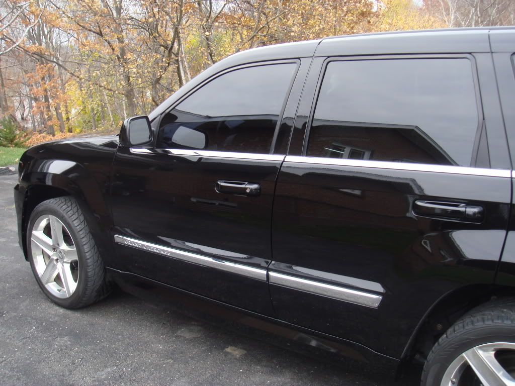

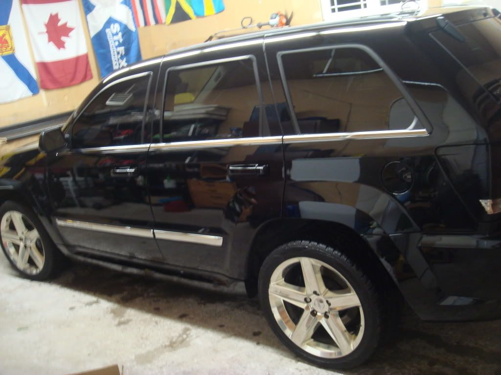

Driver side before
Driver side after

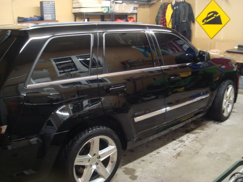

Pass. Side before
pass side after

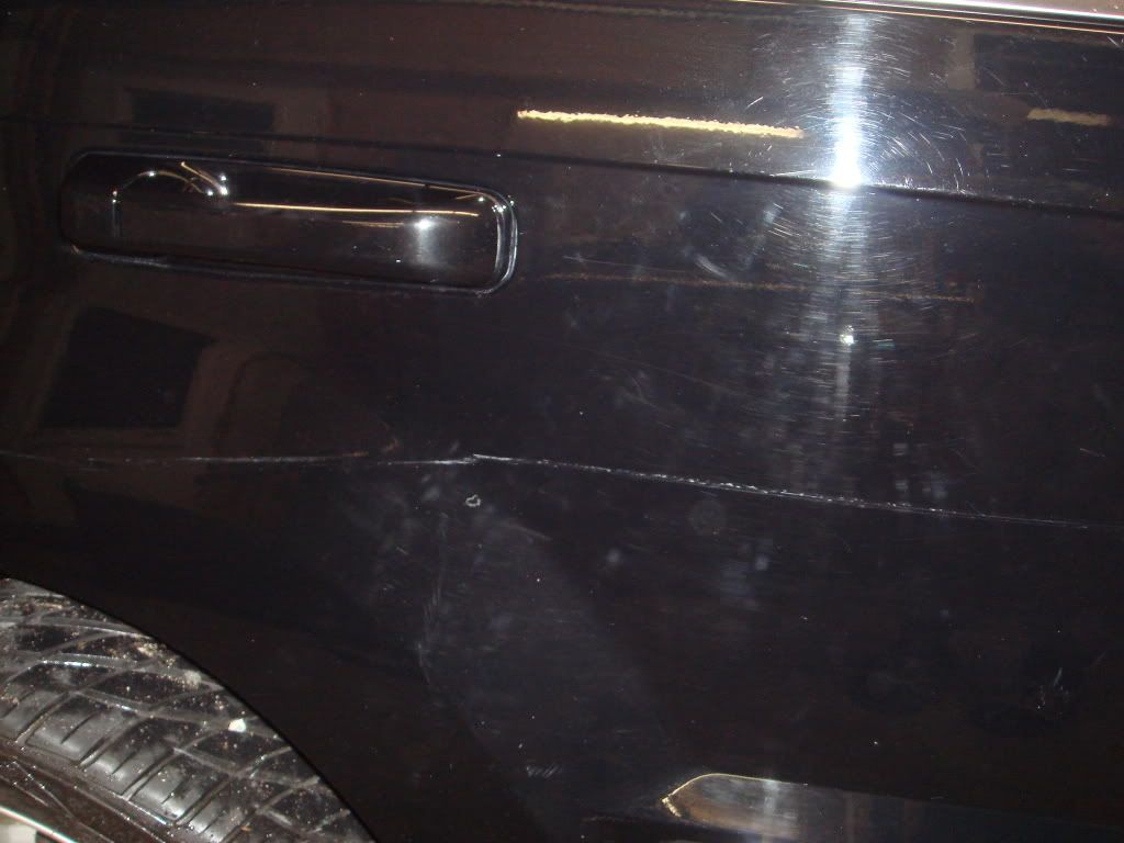

driver side rear panel before

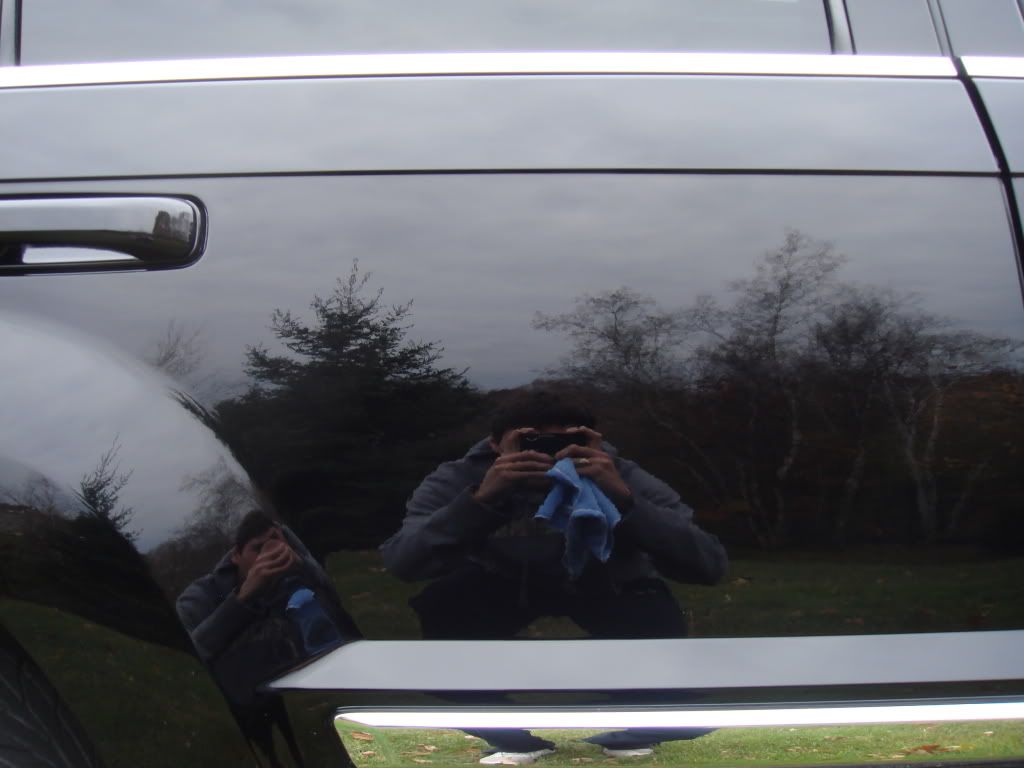

Pass rear door before
Pass rear door after

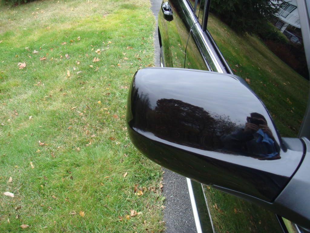

Pass mirror before
pass mirror after
hood before
hood after
Nice Job! You did a really good job on those scratches. If you dont mind, could you tell us which mirror glaze products you used and your process?
Wow, good job correcting with your PC!
What was the cause of those aggressive looking scratches? bushes/tree branches??
Very nice correction !!

The cause of the scratches was that i was using a MF mitt which had one of those plastic tag attachers stuck within it.. i didnt find it untill a few washes.. dumb dumb dumb i know...

Alrite i started off with a wash/dry
Clayed with Mothers kit
PC with orange pad and Meg's #4 (i know its not the optimal choice but its the only one with a heavy cut that i could get local, ended up working good!)
Followed with white pad and meg's 83
followed that with meg's white pad and megs 3
meg's gold class wax applied with pc and grey pad
removed by hand with MF towels.
Great correction mate!
