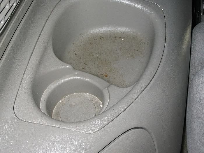

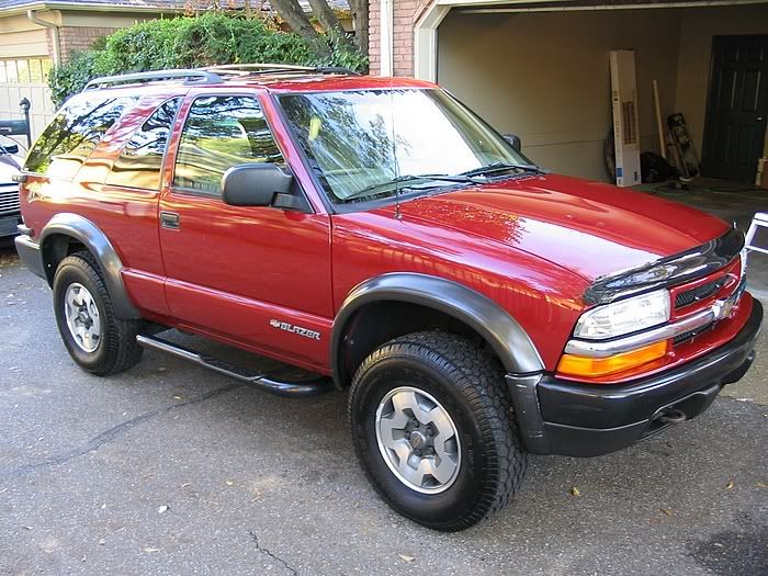

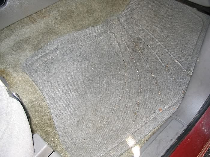

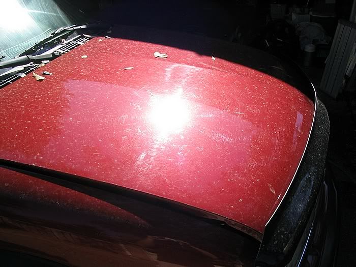

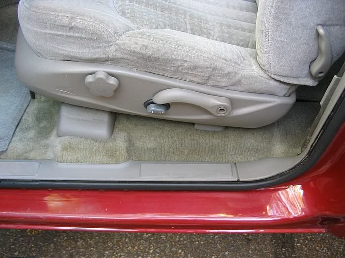

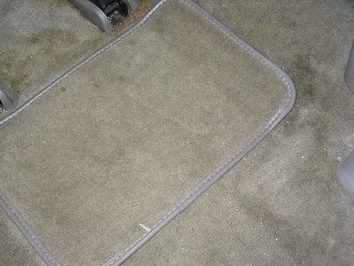

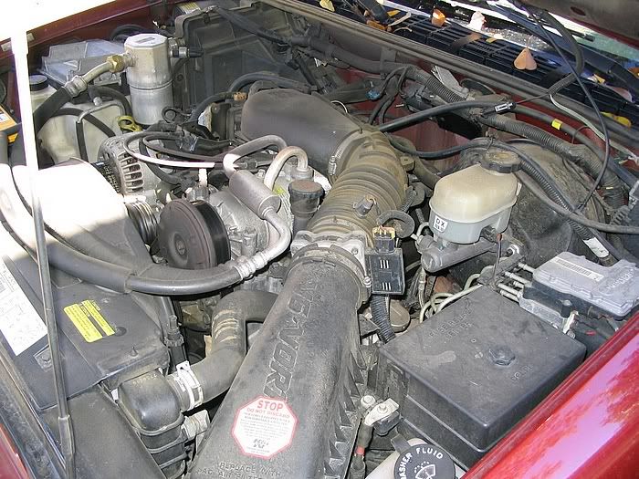

This was my project yesterday, owner stated over the phone that it was “in good condition, just needed a little sprucing up.� I knew exactly what that meant.
Total time was 5 hours.
Process was:

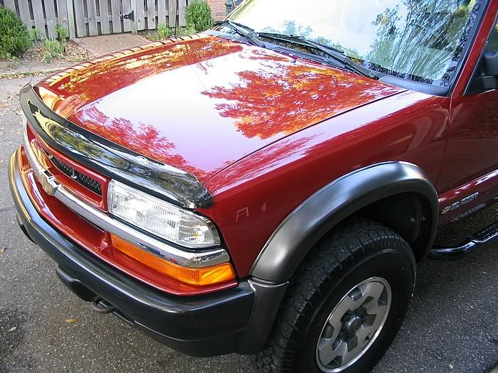

Wash
Clay

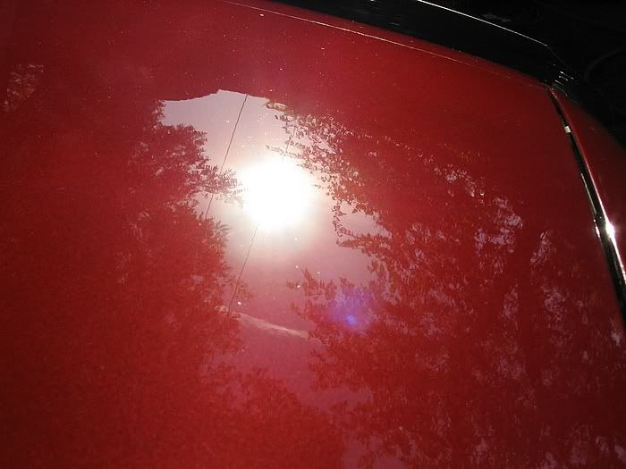

Hi-Temp extreme cut with wool pad via rotary @1500 RPM’s
Meguiars #83 via rotary/polishing pad@1000 RPM’s
Meguiars #80 via Pc/polishing pad @5.5
Meguiars gold class liquid wax by hand (new formula)
OCW
Tires dressed with hyper dressing 1:1
Glass cleaned with NXT glass cleaner and MF

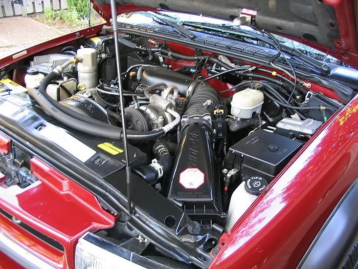

Engine degreased with magnum
Pressure washed
Dressed with Eagle One water based dressing 1:1
Interior:
Vac

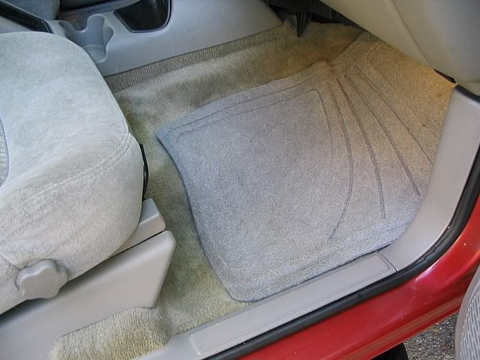

Costco APC 10:1 on everything

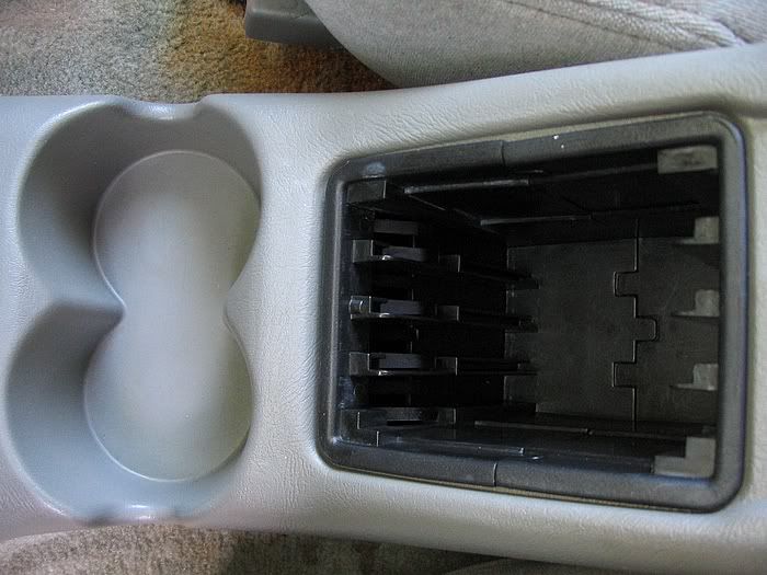

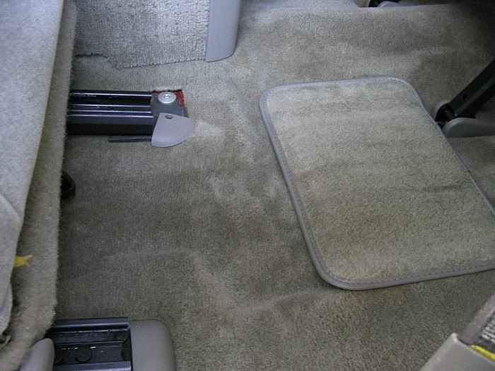

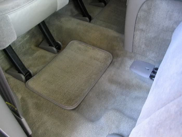

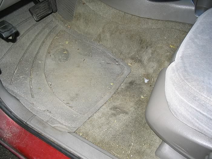

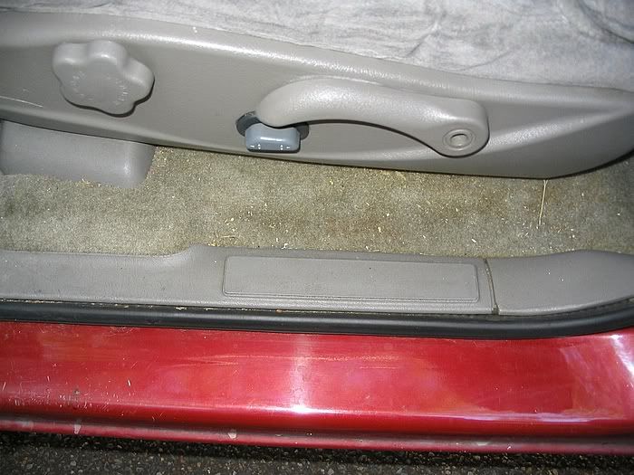

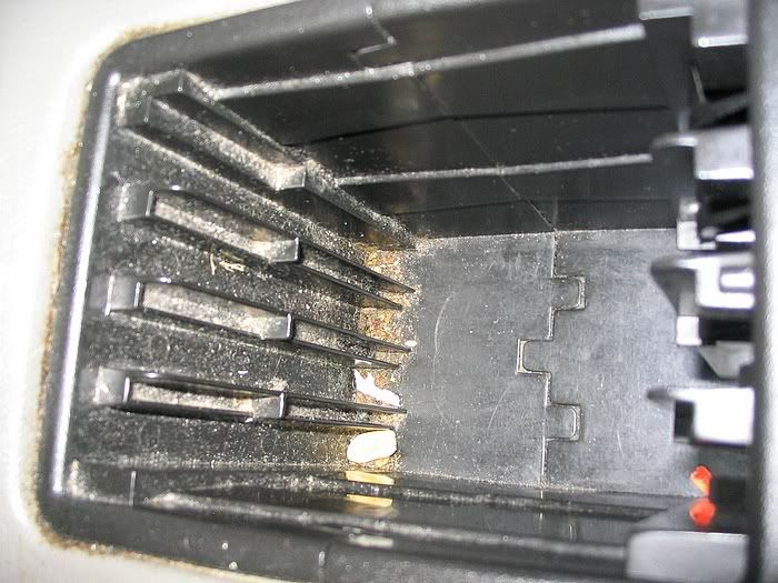

The dash console area was easy to clean…everything was falling apart.
Before:

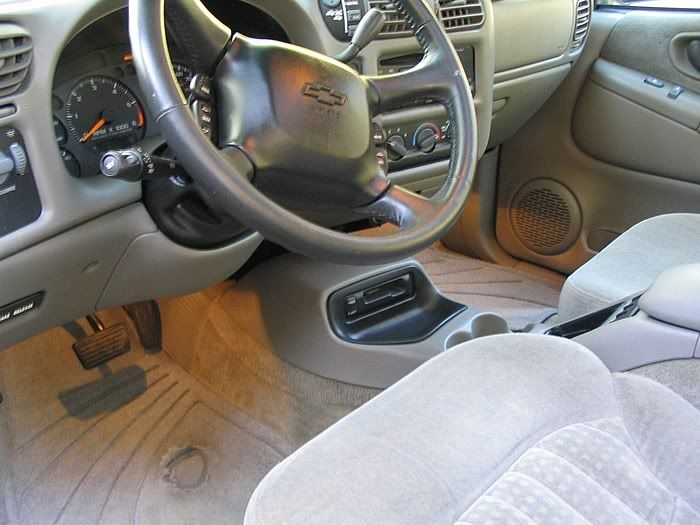

Oh my !!! wow ! huge transformation ! excellent work .. nice combo that i would've used as well.. dacp w/ rotary..
Nice work and even more amazing that it was done in 5 hours.
Any chance of you breaking down how long it took for each part of the process?
:bow
Wow, did you use 10:1 APC on the carpets as well? I would think a stronger ratio would be needed.
I am amazed at your working time, I wish I could get done in that amount of time.
Man, I have no idea how long each part took. I attack every vehicle in the same way. I have the process down to a science, but I have no idea how long each part takes.
Thanks everyone!!!
:eek: :eek: Five hours? WOW! I am very impressed with how long it took you. I think that would have taken me 10 hours. :hairpull Great work!
Excellent transformation! I think that would take most of us weekend warriors 6-8 hours to get those results, looks as close to new as it ever will. Just a little sprucing up, yah right............. People!

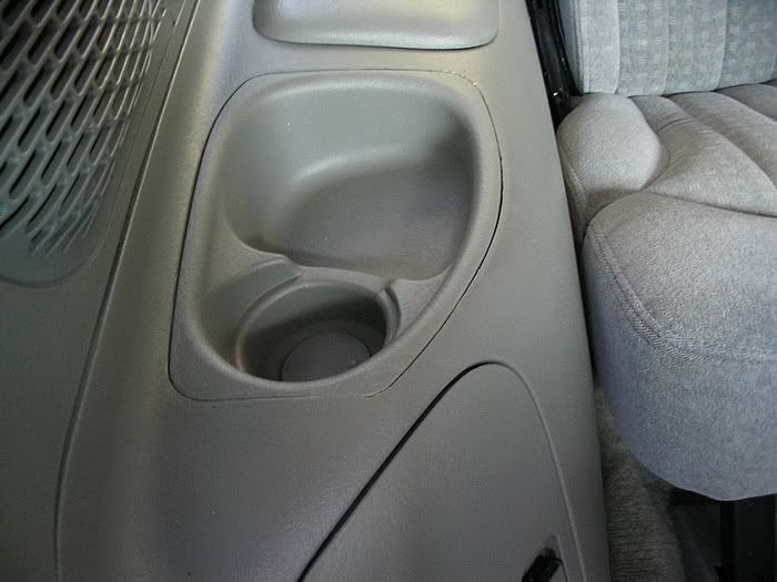

then I clean all the vinyl starting with the front driver's side door
apply APC scrub crevices with denture brush
wipe with MF

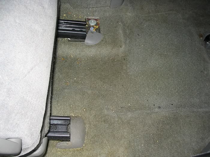

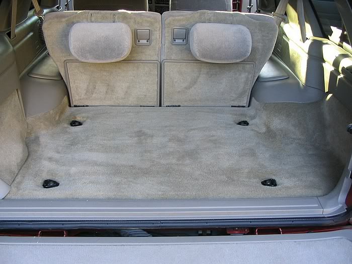

I then move to the carpets

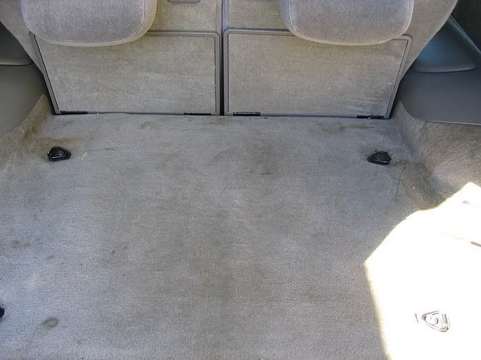

apply APC scrub wipe with towel/extract if necessary
one more vac over everything to remove loose debris/lint from cleaning

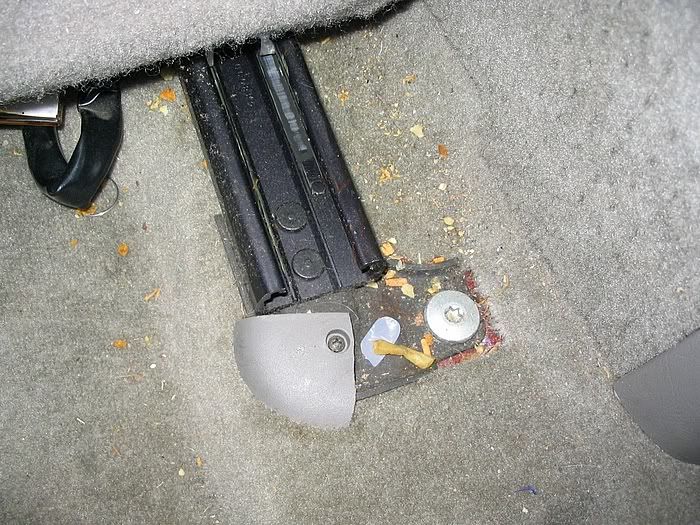

I like the sad, crinkly, stale french fry tucked under the seat!
