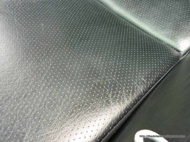

Moving to Interior?detailing his leather seats
look at the left side....the leathers look great glossy & oily...but is it clean & protected...
A marked area 50%/50%
what happen is when we apply too much of leather conditioner...so how over the years it will built up & layers upon layers built upon...the number 1 enemy of it is OIL....either from homo sapience or food...what so ever ...willl etch the leather....so i choose Power clean...as i can dilute to the least aggressiveness depending on the severity....(1 power clean : 8 water)...brush es with soft haitr bristle brushes & wipe down with damp micro fibers...
for safety reason I recommend u
be gentle ...as there is 2 type of leather here sprayed leather or dyed leather...what i see..most of the Bimmers in E60/E90 is a dyed leather...colour can be easily wear down ...do a test..in a less obvious area...bottom of the seat......flip & clean the leather inside, if there is a discolouring..it is a dyed leather...careful
for sprayed leather it is easier maintain..like S class
once the oil is remove....now u see thats the coloour it is suppose to be...
After 50/50%
remember the Before side
After
Protected & condition with Leather protectant plus...it does not fill any surface but protect it.....not oily / greasy finish but satin
T a D a
so simple spray on wipe off & walk away
all you need is to do a damp micro fiber wipe down every bi-weekly & protect it with leather protectant- bi monthly

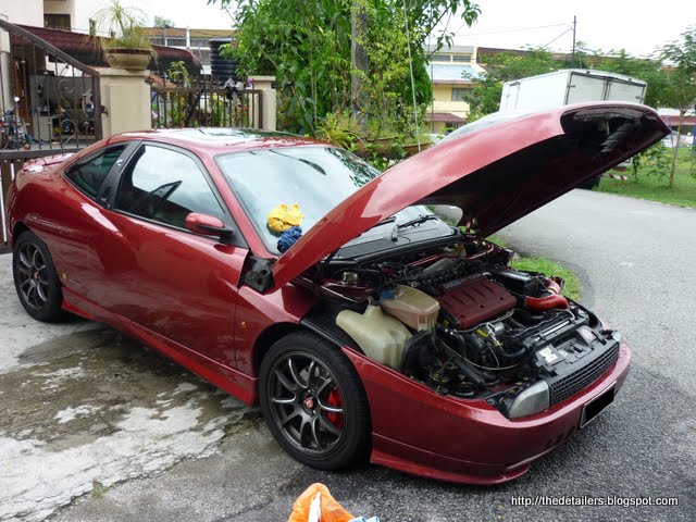

Moving to engine compartment
Wow wow
Immaculate?the owner kept it so well & clean??
I recommended him to do a quick wipe down with ONR & protect it with
Good for all vinyl, plastics & rubber as well
