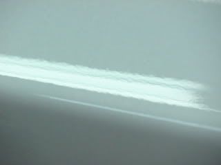

Example of serious OP (on Nissan SUV's factory paint) that leads to a highly distorted reflected image (fluorescent light)

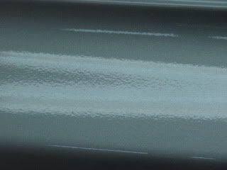

Another example of horrible OP leading to extreme blurness.

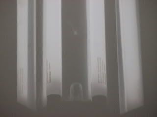

After sanding away OP and extensive buffing.
Reflected image is very clear now. Fluorescent tubes appear straight. Wordings on the tube can be seen. Looks great but I won't want to "wool pad " this car in the future!!!:nana:
