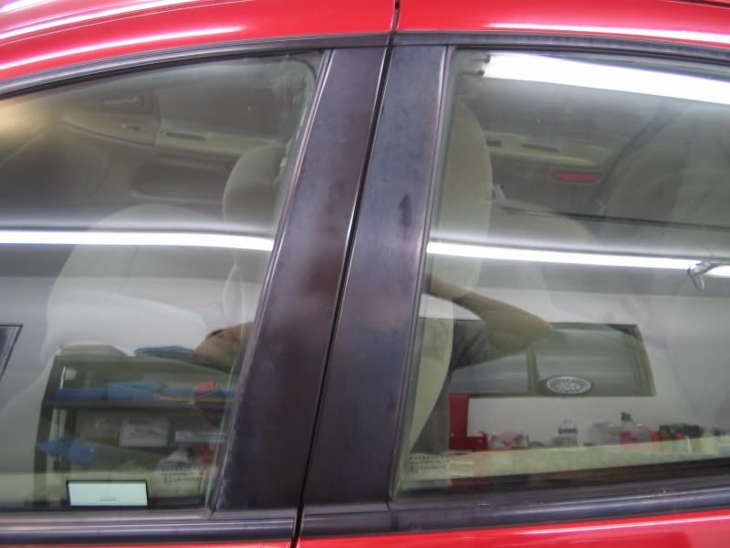

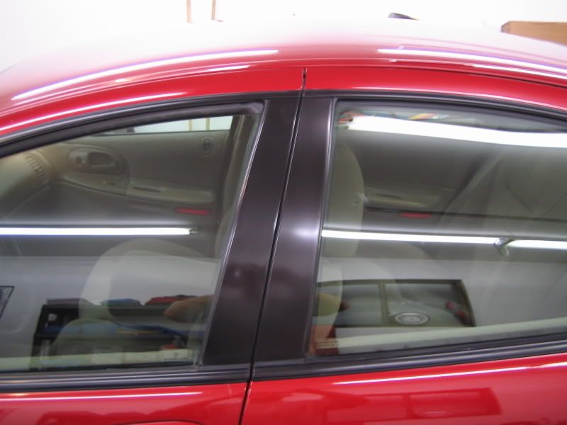

Here is your touch-less washes at work...
damaged
How it should look

Any questions? :D
RaskyR1:
I'm curious as to how you corrected or would correct the trim damage in pic 3 (process/polishes/pads used)?
I see this type of trim neglect quite frequently.
Thanks.
They actually clean up rather easily with any mild polish. ;)
Think I used M80 on the Navigator but it was a few years ago... 4" white LC pad on PC.

I should note that on those painted trim pieces I posted above two of them were painted pieces and my main concern was oxidation removal. For that just about any mild polish will do the job. If you have heavy marring a more aggressive combo will be needed. I don't believe the intrepid pieces were painted and on those type of plastic pieces I've found KAIO to work well (As noted above by Accumulator).
I always tend to use more caution any time I'm working on trim like that.
