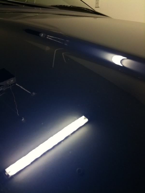

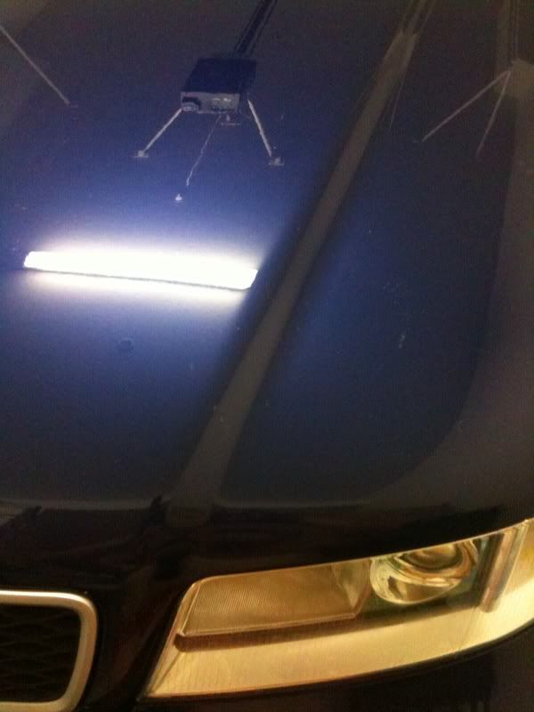

Here are two pictures I took of the hood under flourescent lighting. I though it would bring out the swirl marks, but apparently my iPhone can't do EVERYTHING... :)
Regarding the 3M Swirl Mark Remover, to my knowledge 3M has made several products with the same name. The only one I have used is from the Perfect-It 3000 line and I was not impressed with it at all. Not only did it barely remove swirl marks but it was next to impossible to remove. Since I am not sure which one you have I will exclude that from the process.
Next, Audi's tend to have hard paint. I say tend because it is an absolute generalization and you really don't know what you are dealing with until you put a buffer to it.
The key here is going to be to dial in your process using a test section. Tape off a 2x2 square or so and work that section until you are pleased with the results, inspecting the section as you go in the sun light or bright light. Once you get what you are looking for you can move onto to repeating that general procedure over the entire car.
Here is how I would do it and how I would pair the products.
Swirl Removal: Menzerna IP with an Orange Pad. You may need to make several passes (or more) to remove the defects if the paint is typical Audi hard and the defects are deep. Use speed 5-6 on your PC with moderate to firm pressure. Again use a test section to dial in exactly what you need to remove the marring. Keep in mind that the paint will not look perfect after this step and will likely have a very light haze or micro marring. That is okay, focus on the defect/swirl removal.
Polishing Haze Removal: You should only need one step for this. I would start with Menzerna FPII on a Black pad at first, polish the area, then inspect the section. If the Black Pad isn't sufficient to remove the polishing haze then I would step up to the White Pad. Use the least aggressive pad necessary.
I would not use hand glaze prior to Klasse AIO because the cleaning property of AIO will remove the hand glaze from the paint. I would go straight to AIO.
I would use the Green Euro Foam at this point (which may seem strange but this foam works exceptionally well with AIO's). Use speed 4 and light pressure, working the AIO back and forth until it almost melts into the paint. Use very little product.
When it comes time to apply the KSG, I would use this technique. Pour the product into a dispenser/spray bottle and apply it like a quick detailer with a twist. Use one light mist per panel and spread/work in with a microfiber towel. Then flip the towel over and continue to lightly buff until the surface becomes very slick, you will feel it happen.
As far as topping with a Carnauba Wax, that is certainly and option: PAC pioneered the use of topping Klasse with a carnauba wax, long before others copied the idea. P21s, which is a wax that is very similar to the one we first recommended, makes an ideal topping for the Klasse twins and is amazingly priced considering the awards it has won against more expensive competition.
Above all else take plenty of pictures and share them with us so we can share in your joy!
If you get started and need help shoot me a PM and I'll send you my cell number and help you out.
Todd
