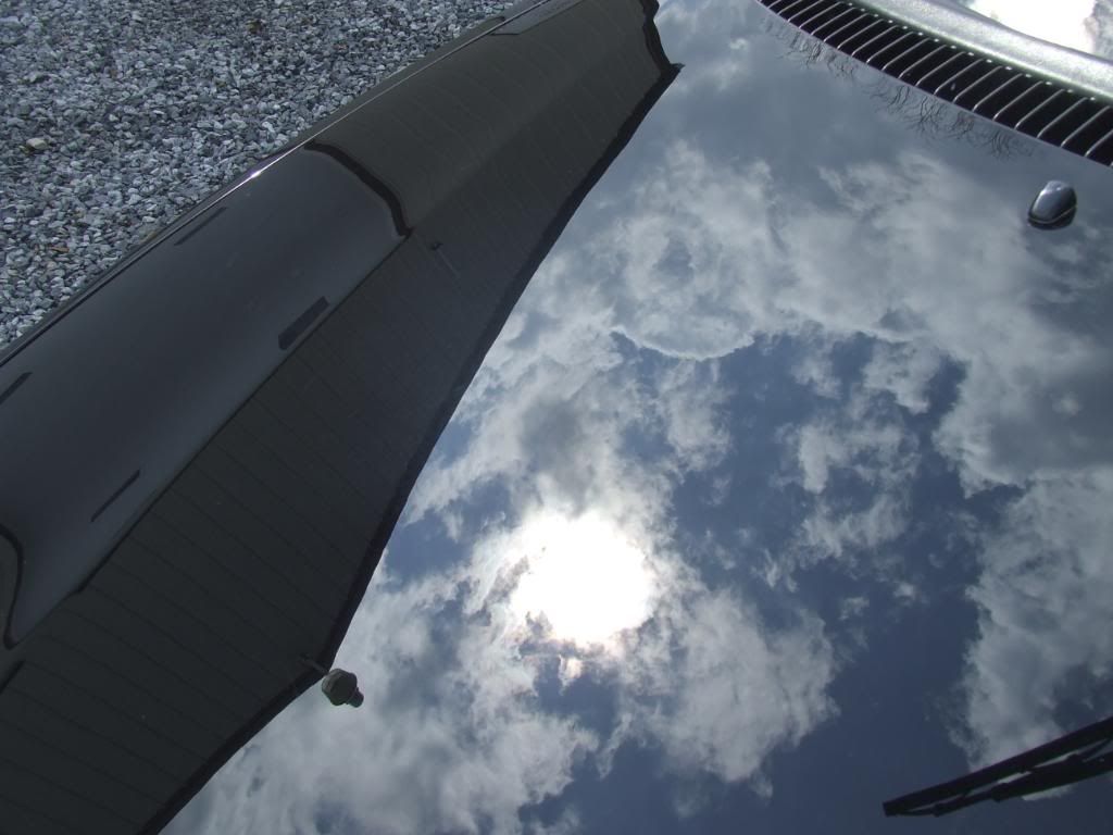

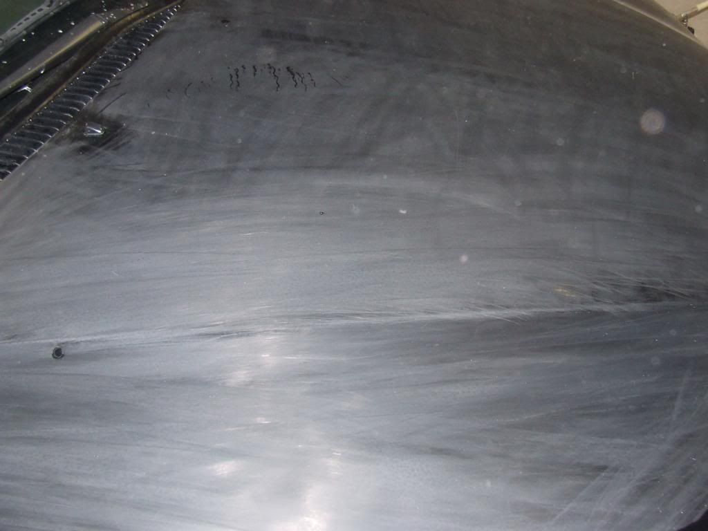

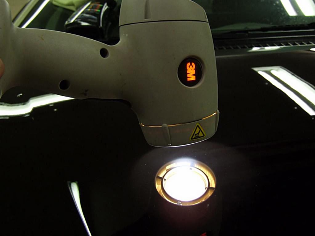

Now i don't have a brinkman, but yes it is possible to fully correct paint under a sun gun. actually what your talking about doing is very tuff and takes years of practice. a perfect finish is all in the prep. here below you can see where i was asked to correct this paint. the first picture is where i got the paint leveled by wetsanding. this removed any defect that could be seen. then there is a picture of the paint under a sungun this is just compound and polish!. here is proof you can correct paint perfectly under a sungun. next i showed you a pic of the same spot outside in the sun. good luck on your adventure! and remember always use ipa 91% to do a wipedown.
