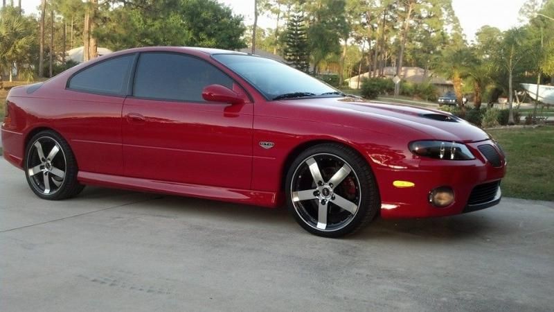

Picked up a Pinnacle elite diamond coating kit that includes the paint, glass and wheel coatings along with the surface cleansing polish some applicators and microfibers. I couldn't resist trying it out on my GTO before using on a customers car.

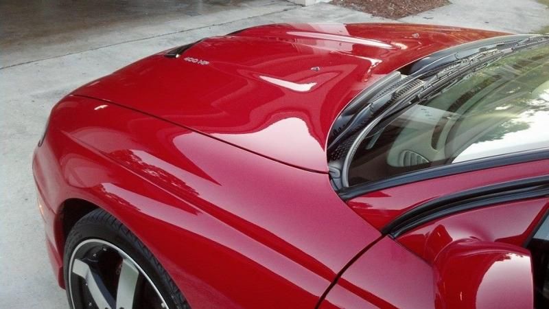

After a nice wash and going over with a fine grade nanskin mitt I polished the car with my 3401 and a white CCS pad using Menzerna PF2500. After that I switched to a black ccs pad and the surface cleansing polish. You don't need much as a little goes a long way. The polish wipes off easily and leaves a nice clean surface. Then it was as simple as following the directions on the diamond paint coating. A few sprays and working the product into the panel was effortless and the remaining product wiped off easily.
I prepped the wheels and glass with the surface cleansing polish and applied the respective coatings using the supplied applicators. After allowing to cure overnight I was greeted with a nice slick glassy surface and best of all, no high spots!!!
