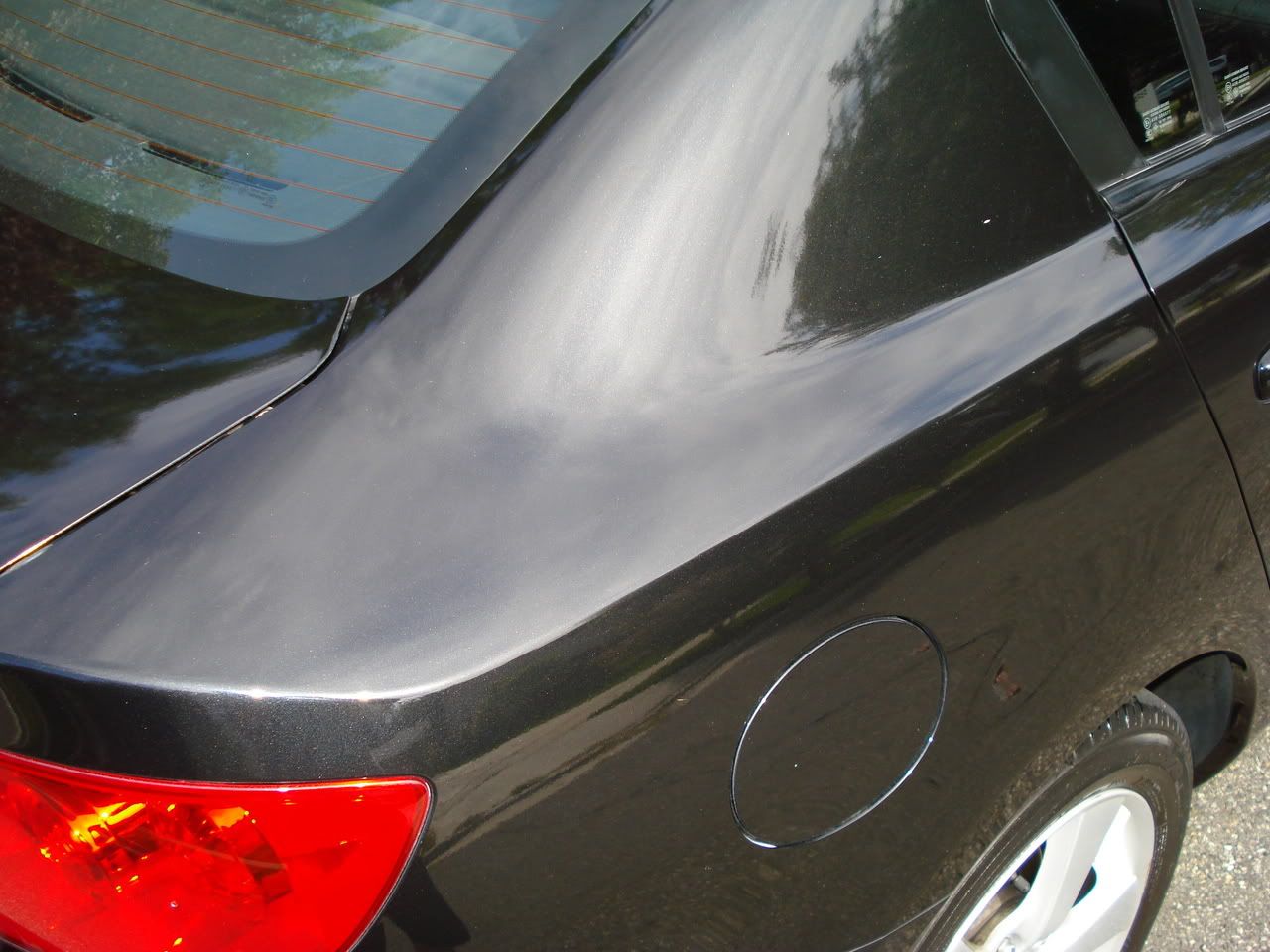

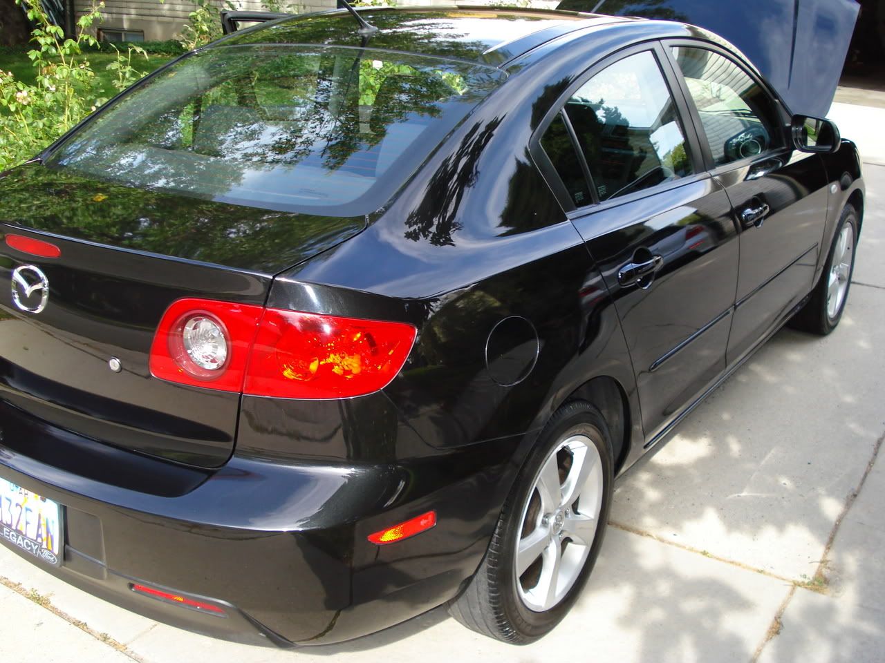

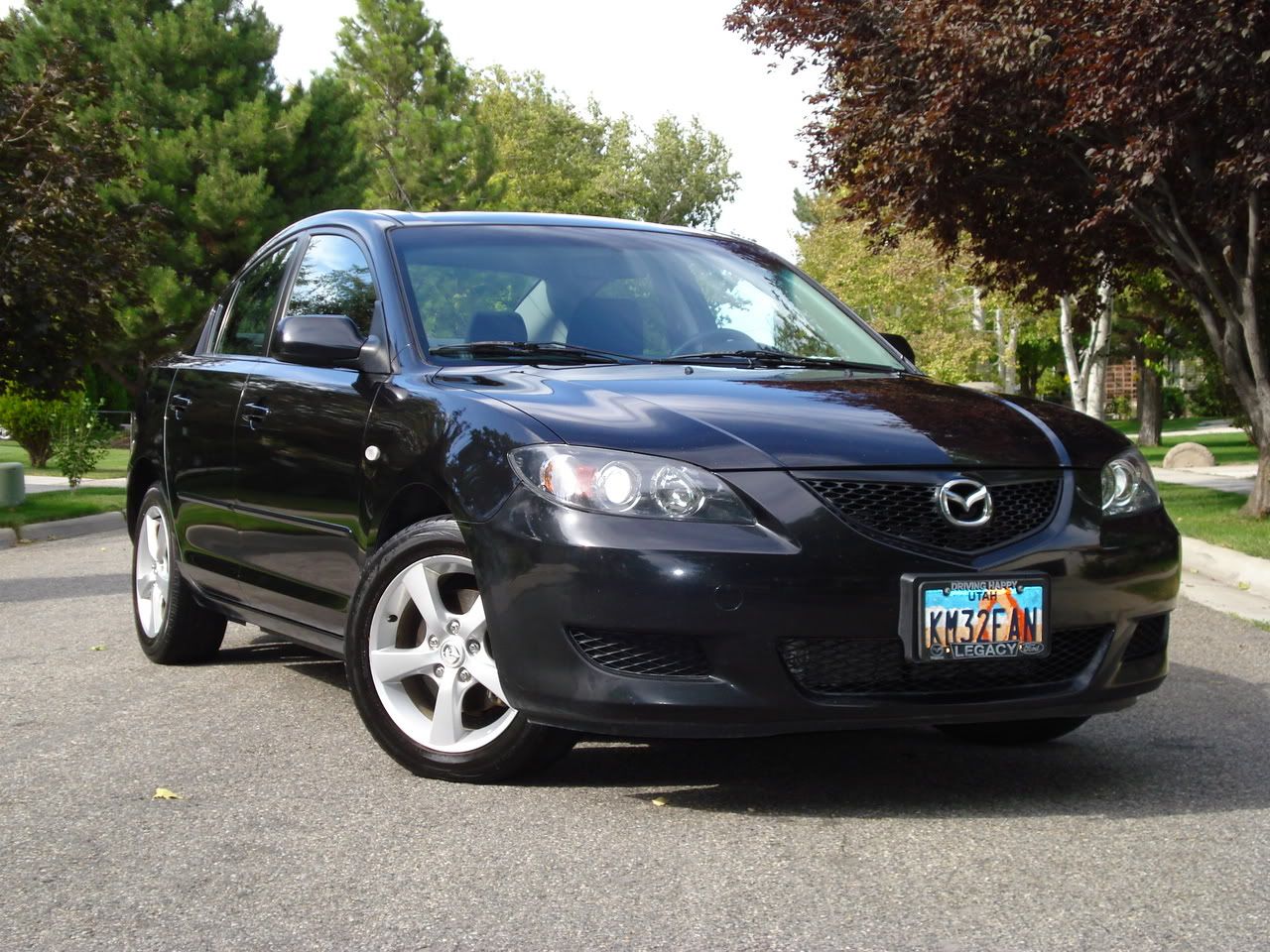

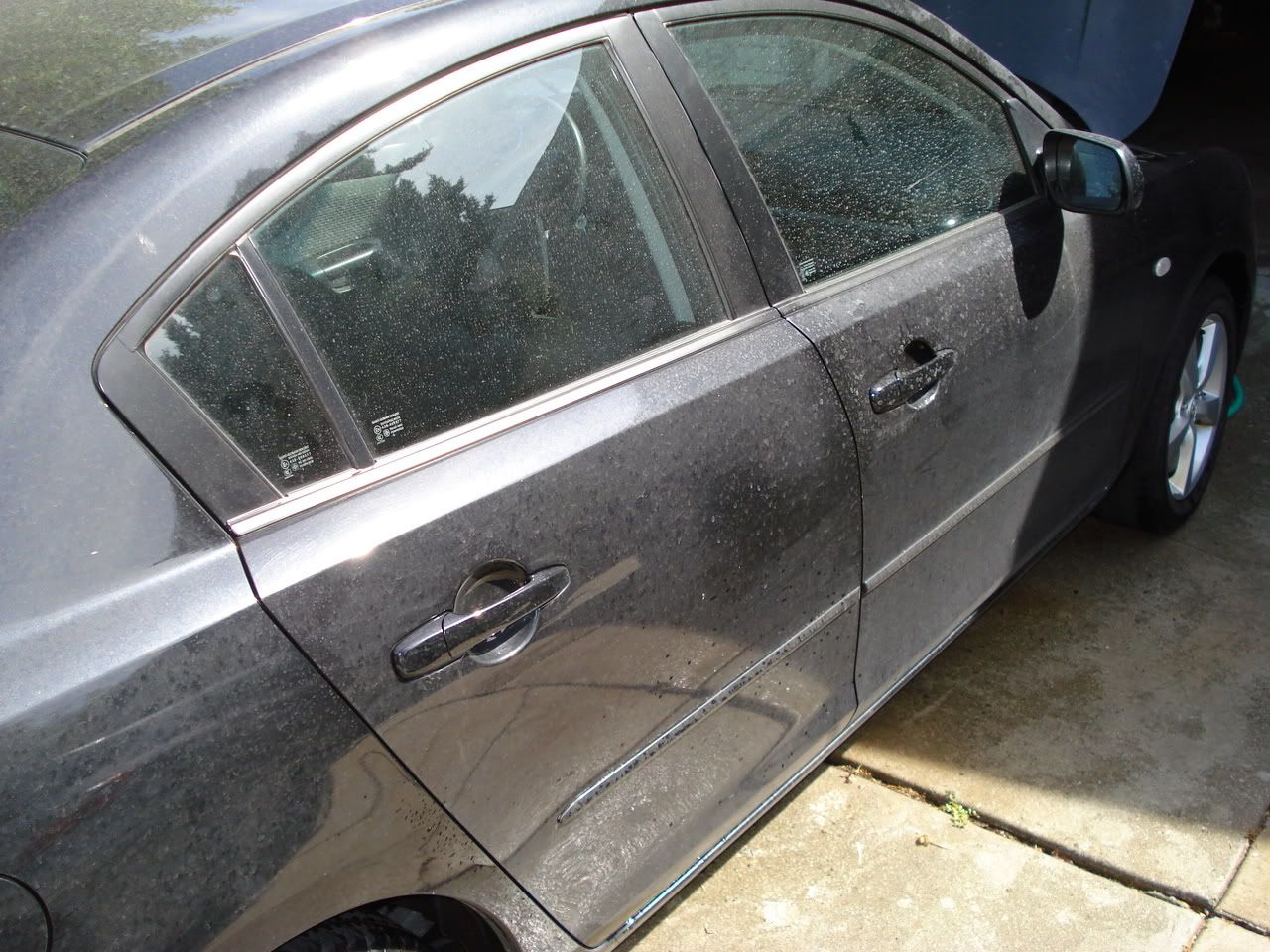

This is a co-worker's car. We work together on several projects and we usually end up walking out of the building together. I've commented on her car several times, as has she. Every now and then she winds up parked next to my car and the difference between them is pretty stark. I've done a couple other cars in the office and she knows what I can do, so I finally talked her into bringing it by. She must have been planning for this because she was nice enough to leave it in the sprinklers all week and let it all bake in nicely before she brought it over. Sheesh... Anyway, nothing a little SSR2 and Danase Swirl Abolisher II (basically the same thing as far as abrasiveness and effectiveness goes) on a yellow Edge 2000 pad and my FLEX couldn't handle. :) It got the typical wash and clay and then the polishing. I finished it off with a little Danase Wet Glaze because I knew I would be doing the car again in a couple months to prep it for winter anyway. No sense in using anything too durable if I'm just going to have to strip it off again anyway.
It was just a little tiny bit oxidized...
Fortunately a lot of these swirls were in the oxidation and it wasn't tough to polish them out.

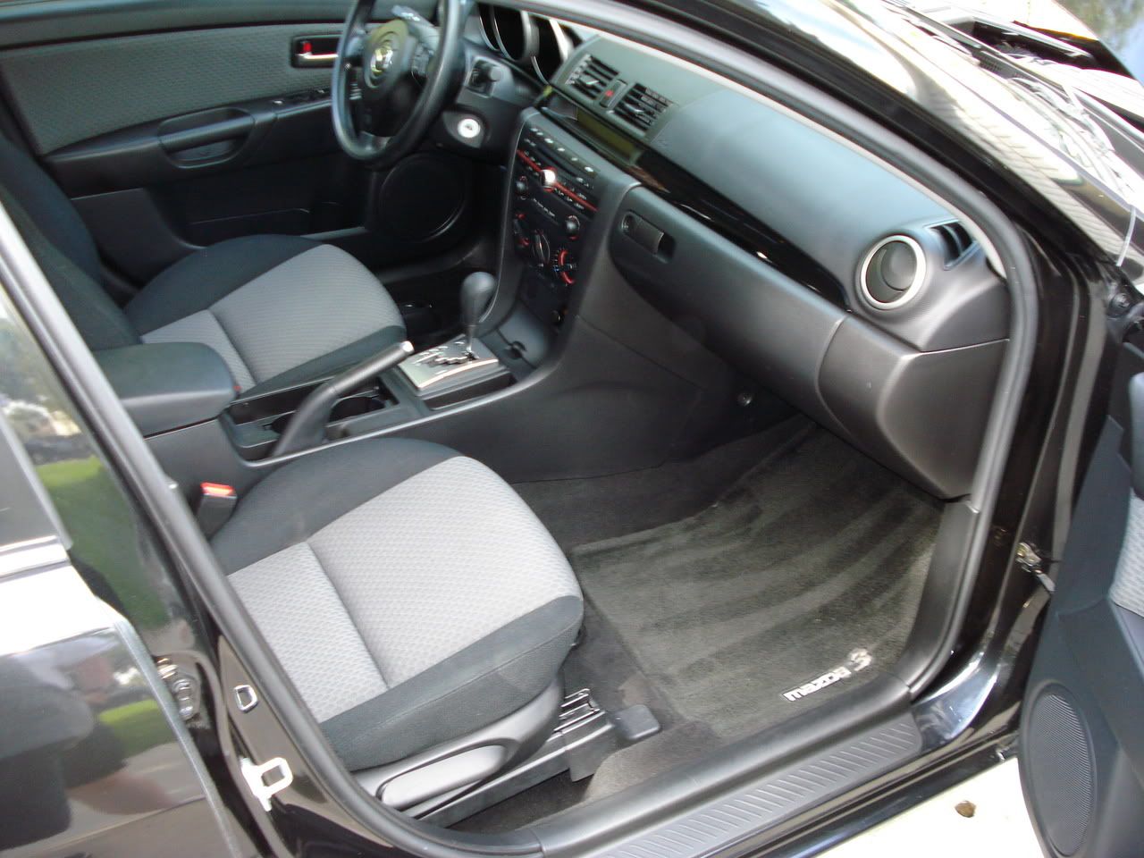

When you detailed the interior were the seats dirty? I know those seats are that synthetic cloth material. I have yet to find a product or method to clean them.:(

These seats were in pretty good shape, but they are a huge pain in the keester to clean when they aren't. The best thing I've found for them is to soak them with Tuff Stuff and then let it soak for a bit. Then soak it again and suck it out with the vaccuum. I don't even bother brushing those seats because it just seems to spread the crap around more. I just go at it extractor style with my redneck methods and that seems to work pretty well.
