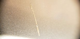

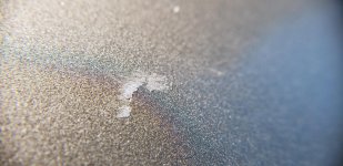

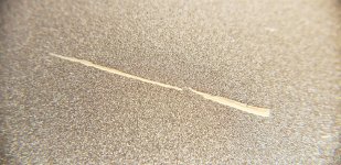

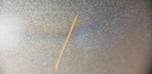

I found a few of these spots on my paint and I can`t seem to get them off
kenaston
I`ve tried using quick detailer, degreaser, clay bar, even a razor blade with lubrication and even that was a pain. Any ideas?

Did that vehicle run over some road paint recently ? Anything on any of the tires?
Enlarged the pic and it looks like some type of paint..
Do you have any mineral spirits and a Q-tip ?
I would never put a razor blade to paintwork..
Dan F
I’ve seen pine tar look like that, but it takes awhile for it to turn that color. If you do use a razor blade make sure it’s the plastic type. You still will have residue remaining. If it’s paint, the residue will buff away with a polish. Just be careful spot buffing by hand. You can go through the clearcoat easier than you think (I did it). Something like Klasse AOI is safer than a polish when trying to remove residue by hand.
You could also try 3M adhesive remover and a plastic razor blade.
That`s what I`d try since the clay didn`t work, either that or the Mineral Spirits. I`d saturate a paper towel/etc. with the solvent and use something to prop/hold that against the stuff so it has a longer dwell-time.
