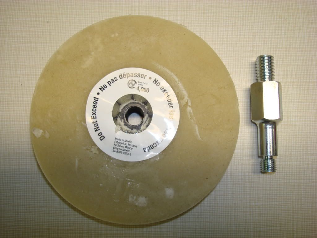

If the glue is not too sticky I myself would use the 3M Eraser wheel. That is I'm assuming you will be doing some sort of polishing. If used properly there will be minimal marring. I have used it on soft paints too. Just a minor polishing will clean up. It is a real time saver. 3M adhesive remover is also a good go to.

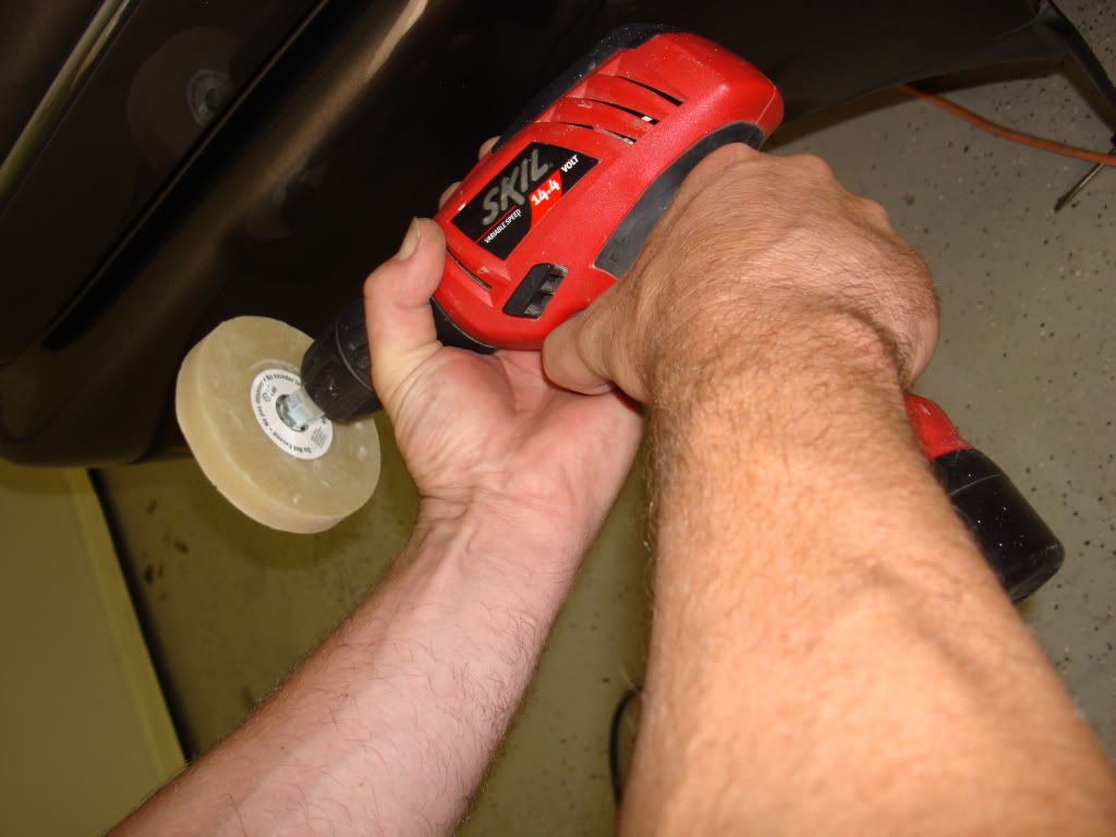

I picked this up at Advanced it is made for a drill. It sheds to prevent grinding whatever you are removing from the paint. It is also great for decals, tar and paint transfer scrapes BEFORE polishing. Iv'e used this and the high speed unit for years. Its also safer than sanding down areas as it only removes the transfer or glue and you can go straight to polish after a wipe down. Used properly it leaves minimal marring. Always test any area first. Once you get used to it you will love it.

I fully agree with you. It can remove heavy paint transfer also very quickly. I've done bumpers where a body shop quoted 1100.00 to repaint.
In 2-3 min. cleaned the area to find no cracking or scrapes then straight to polish. A 45 min. fix max.(if you polish the whole bumper) Its up to the person to decide what they charge but there is a huge profit potential even being very fair.

The wheel can create minor marring. But I have found it not to create any more than scrubbing with a rag with a solvent.
