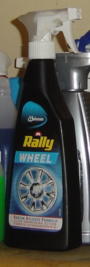

I recommend this. Is not acid based, very cheap (here in Greece) and very effective.
My second choice is autoglym wheel clean (also not acid based) but a little pricy.
And I do not know if you can find sonax wheel cleaner but I suggest to avoid it as it is very mild (even the extreme solution)
