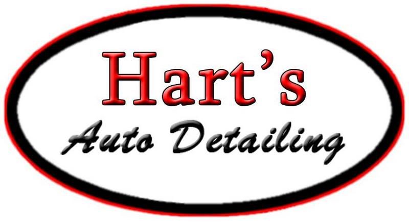

Here's my logo: (the basic design)
I know the lettering has some shading in it, but when it's stitched, it would just be red and black. Do I need to change the lettering to make it a solid black or solid red before sending it in to be digitized?

No, they should be able to work with the lettering even though there is shading. Depending on size, you might even be able to get away with the shading. My first question on that logo would be: Do you want the oval filled? If so, it will remain constant on any color garment. If you leave it open (cheaper), the garment color shows through.
My personal opinion for embroidery is to drop the oval all together-I don't know that it adds that much to the logo and it would be less expensive to do. If you're Ford, yeah, you need the oval, but I don't know that your logo requires it.

Yea, I would not have the oval filled. I would also like to keep the oval though, I want all of my things to be constant.
Well now what do I do? haha.
Is there a way that you can digitize? or do you just do the embroidering?
If you don't fill the oval, you'll have to be a bit picky about the fabrics you embroider on. The more solid, the better. What happens when you do an open oval like that with something inside of it is that they pucker at different rates (all embroidery will eventually pucker). And since you're embroidering against the waft and the weave, they pull at different rates.So you end up with a lot of wrinkles inside the oval. Just a warning.
