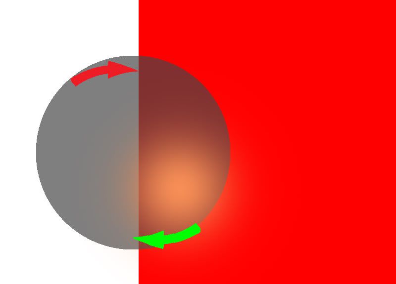

No. I don't mean tilting the pad so that you are lifting any section of the pad off the paint! You are tilting the polisher slightly so that you are not driving the pad onto the edge, but letting it flow off of the paint. The pad (or atleast the area of the pad that is on the paint) is completely flat against the paint.
Here is a quick graphic I drew up that hopefully better explains what I was trying to say. The red is the paint, and we are buffing over the edge (not up to the edge which will never fully correct the paint).
We tilt the machine slightly down and slightly to the right in order to focus the polishing action on the orange area. (again slight tilts). When you polish over an edge (such as a popped hood) you don't want to run the pad into the hood but it is okay to run the pad off of the hood. Again I don't know how good of a job I am describing this, but if you are using your rotary like an angle grinder then or that is what it sounds like I am advocating them I'm just not doing a good job with my explanation.
Mindflux said:
You're essentially talking about 'lifting' the buffer off the hard edge (via tilting) when you are coming off the hood, I get it.
but just slightly, so that you are not putting any additional pressure on the more dangerous area (where the pad is coming into the paint)...
This is how we where taught to do it at a body shop years and years ago (one of the few things I remember in that failed experiment!) but Mike Pennington's (from Meguiar's) video does such a good job of explaining it.
I have always polished over edges instead of up to them using this practice, and have polished original paint cars from the 1960's that have very thin paint (and a burnt edge would be a catastrophic loss in value) and have never had a problem, fwiw.

This picture helps a lot. so I focus the point of contact of the rotary on the orange spot as I move the rotary towards and away from the edge, without applying any extra pressure? And another question: Is there any way possible to run the pad along the edge without burning it?
