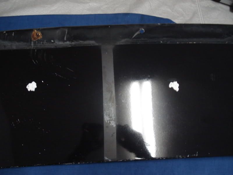

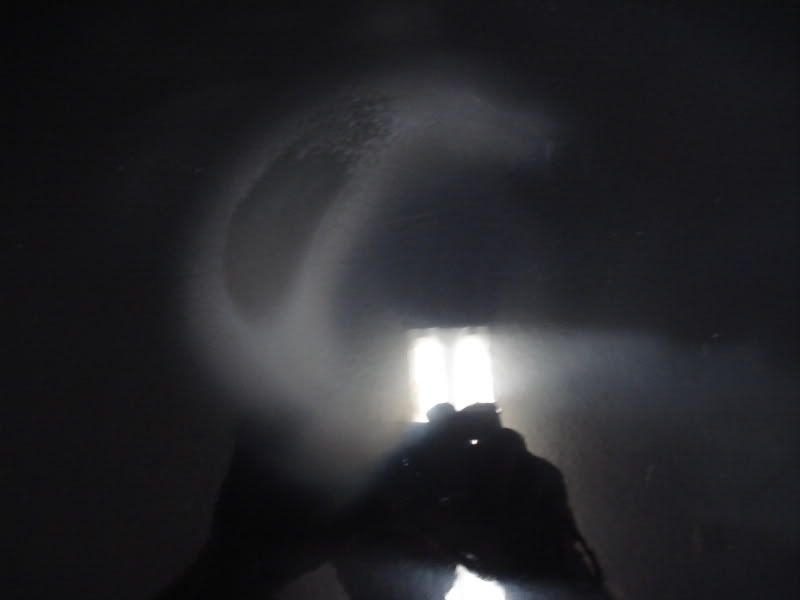

Sometime back I did the following test. I'm not sure if you guys will consider it an accurate test or not:shocked. However, I was trying to see how each tool/pad could stack against each other, although I ran the test for 2 minutes I later went back and ran the porter cable for a longer period, but I was not able to damage the paint.
I’d also like to mention that I’ve been able to do some real good jobs with the Porter Cable and to me the size and the weight are a big factor.
In my opinion the Porter Cable tool is a very friendly tool.

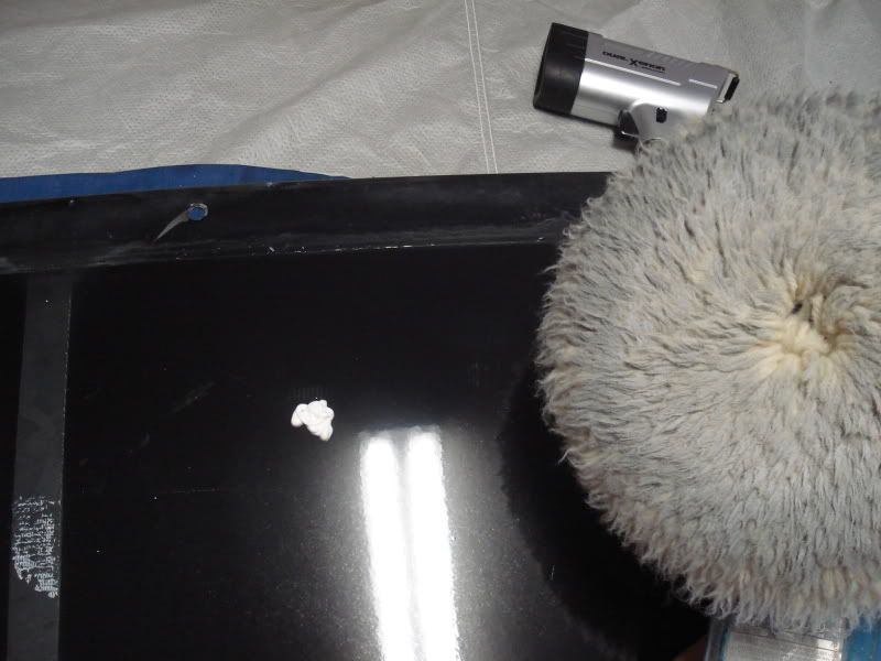

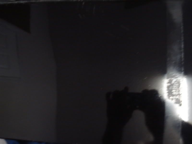

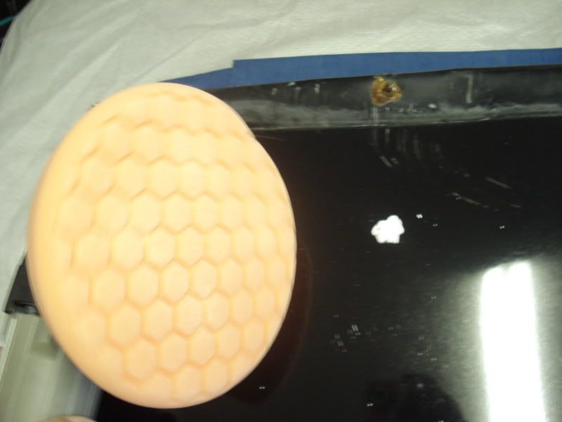

A used neutral non molested surface, same amount of product was used in each test, Left side will be Porter Cable- Right side Rotary tool.
Porter Cable -orange pad speed setting 6.0 2 minutes
Rotary with wool pad setting 6.0 2 minutes
