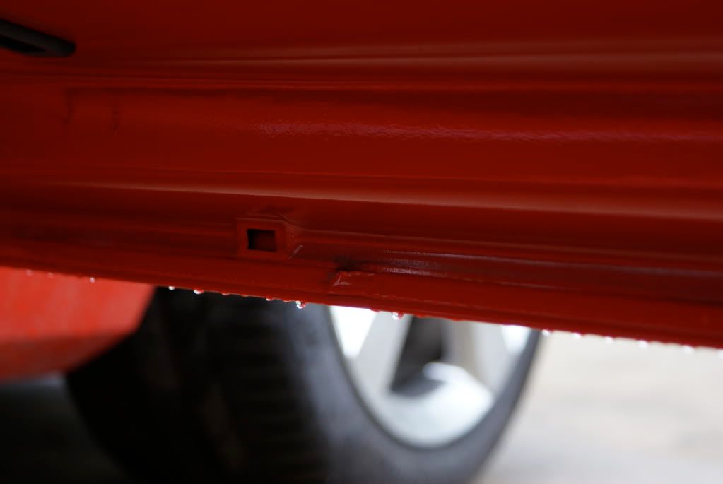

The door jambs needed some care as well. I mean this is supposed to be a new car. New means no dirt IMO. Door jambs before:
The process used was a spray with FK1 #1119 to break down the grease and any coatings used during the assembly process, agitated with a soft brush (as to not induce swirls):
... then followed by a wipe to get most the suspended grease off with the solvent, then rinsed with ONR solution to neutralize any remaining solvent and rinse away any residue, and a wipe to dry and clean the surface completely:
... and a mist with spray wax for protection:
... results in jambs that look proper, and truly new:

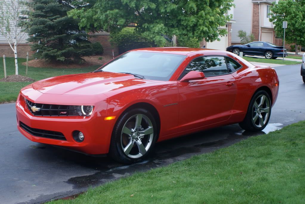

Finally done right as the sun goes down :(
It totally blow my mind ( or what is left of it) how a dealership can deliver a car in that shape and consider it to be "clean".... :grrr:think::nervous2:
