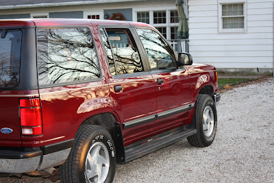

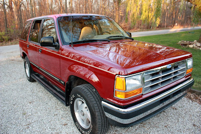

Here is my 18 year old Explorer and it don't even have clear coat it is just single stage paint.
Don't look like the paint is shot yet does it.

First, thank you for your reply. This is helpful. Second, WOW. Your vehicle looks fantastic. I absolutely love to see old cars that have been taken care of and look so good as does yours. That is so cool!

Jesus Bart, that's the cleanest older Explorer I've ever seen lol.
Thank you sir I try to take care of it.
I keep it just as good mechanically as it is clean, I plan on driving it for many more years if I live that long.
At my age it will last longer than I will.
