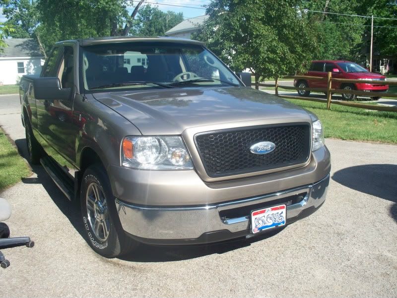

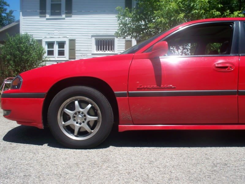

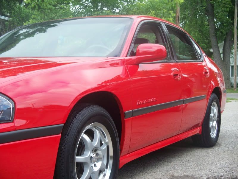

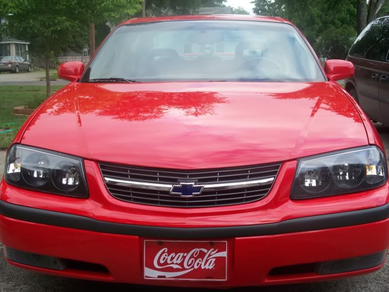

Here are some before and after pictures of my first 2 customer cars.:D
Great work, what kind of products did you use?
Word of advice, especially if you run a business now, censor out the license plates of your customer's cars. You don't want to run the risk of liability.
Looking good.:bigups The real test is the customers reactions. Were they happy or blown away? The former won't cost you business, but the latter will bring you tons and allow you to command a higher price.:)

Looks like you're off to a good start. Are you collecting customers e-mail addresses for any type of follow-ups or reminders ?
Thanks everyone!
Both customers were very happy I need to l learn how to do that kind of work, only Faster.

they were both blown away. The truck owner, im going to get him on a maintenance plan:D He even offered to let me put a "Detailed By" magnet on his tailgate.
I like the idea, but if his truck gets dirty I wouldnt want it on there after that. I dont know. Its something to think about

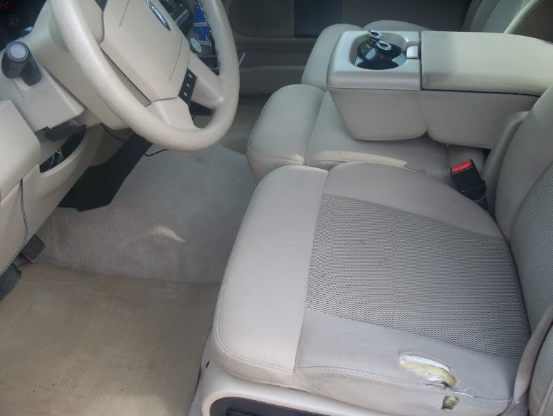

i really like he leather treatment..so u used Meguires leather conditioner on the leather?? and those cracks went away??i have some cracks on my leather seats
The conditioner is treating and rehydrating the leather. Cracks in leather are irreversible. There are kits out there to repair damaged leather, but in this case it looks like the conditioner made the cracks a little less visible. The lighting in the picture is a bit different as well so that could contribute to what you're seeing.
Either way, great job all around.
I think you did a great job, My only suggestion is looking at the "before pic" and trying to dublicate the same picture/angle in your after so theres a sense of continuity and you see exactly what the difference is. Over all looks fantastic. The suggestion about the business licence plate cover...Very smart!!
I cleaned them with Megs APC first then went over them with the conditioner. The cleaning alone helped make the cracks less noticeable. The conditioner gave it some shine and made it a lot softer.
