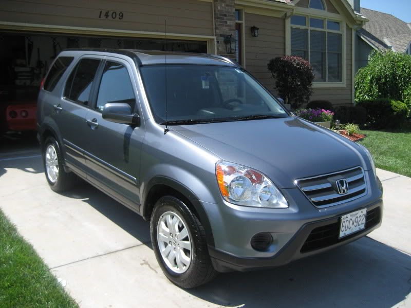

Honda CR-V... Nasty Interior, Exterior not bad....
imported_Luster
I had a 200(?) Honda CR-V this morning. I told the lady that I charge $(x) per hour and she said... "Well, I can afford 6 hours worth!"

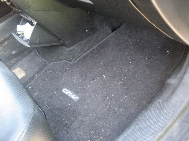

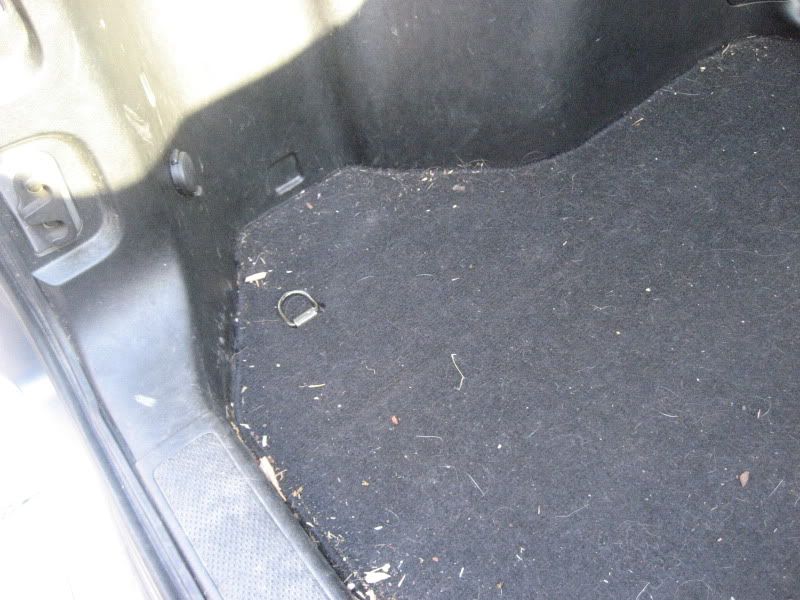

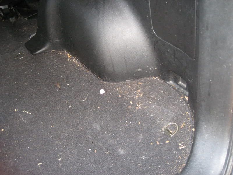

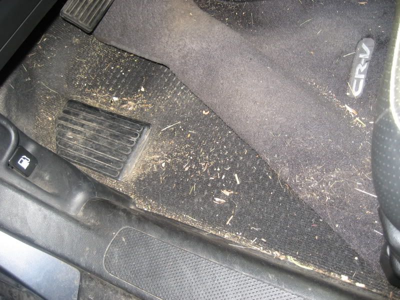

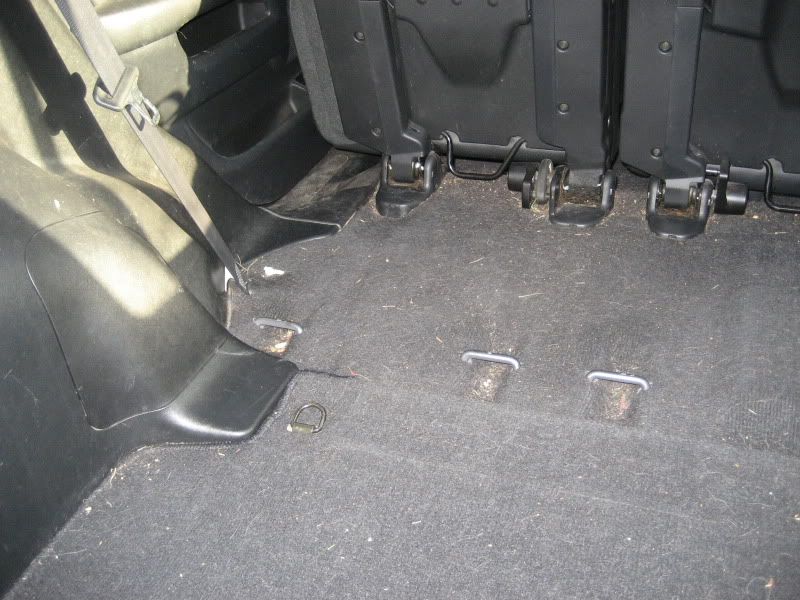

I worked on the interior for 4.5 hours!!!!
Trashed by 2 large dogs.
So I gave her 6 hours of my best work.

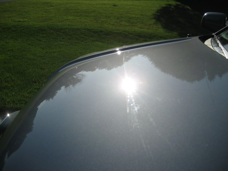

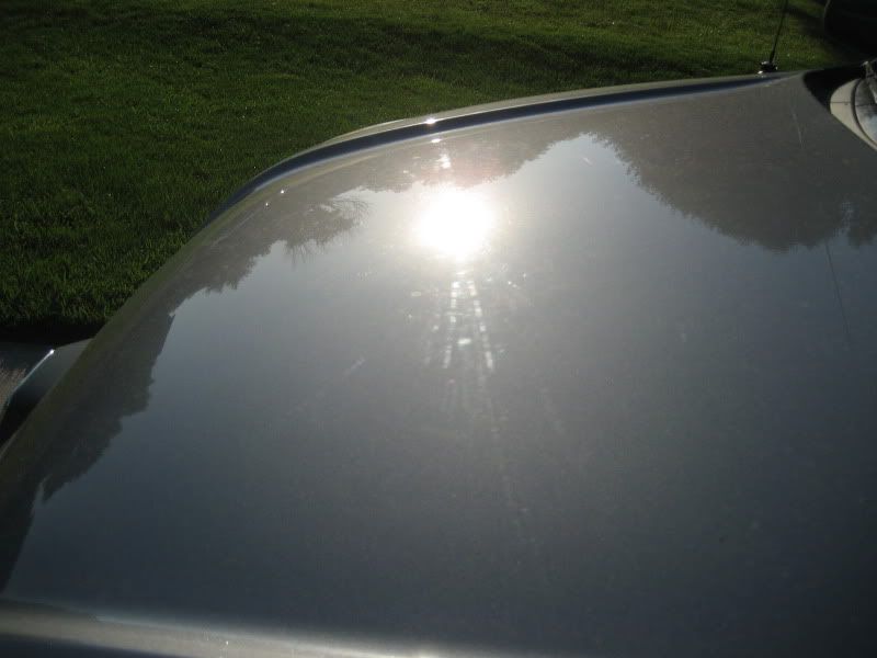

(Because of time constraints, I skipped the 105 step and went directly to 205... worked out pretty well actually)
Process...

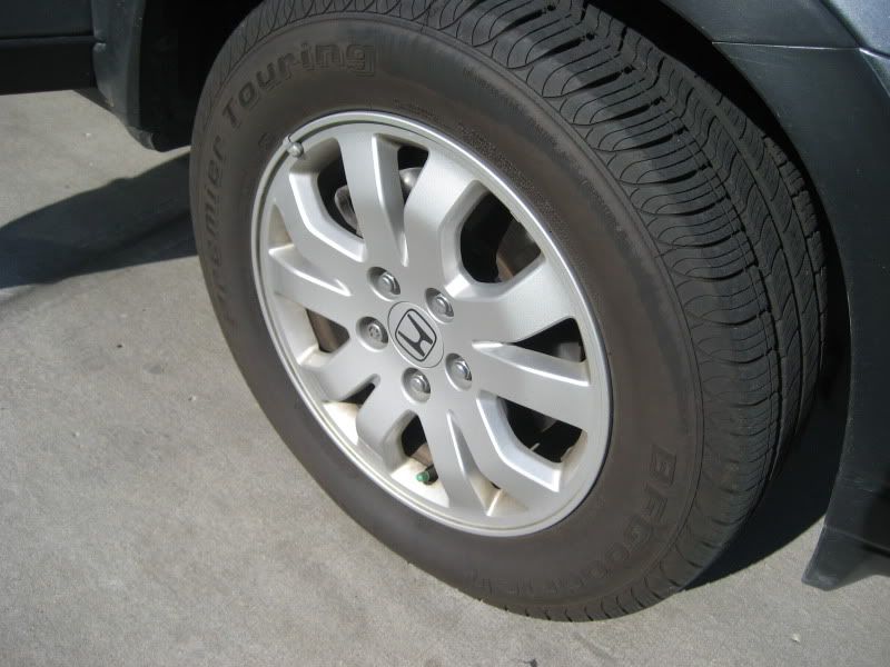

Washed with Meguiars Gold Class

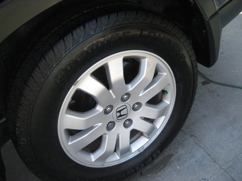

Cleaned wheels with Tarminator, then Gold Class
Tires cleaned with Purple Power, dressed with PBB&B

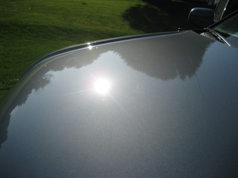

Polished M205, PCXP, Orange pad
Sealed with Blackfire Wet Diamond, PCXP, Black waffle pad

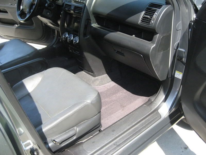

Cleaned interior vinyl with Purple Power/water mix
Cleaned leather seats with Woolite/water mix
Cleaned glass with Sprayway
Vacuumed carpets

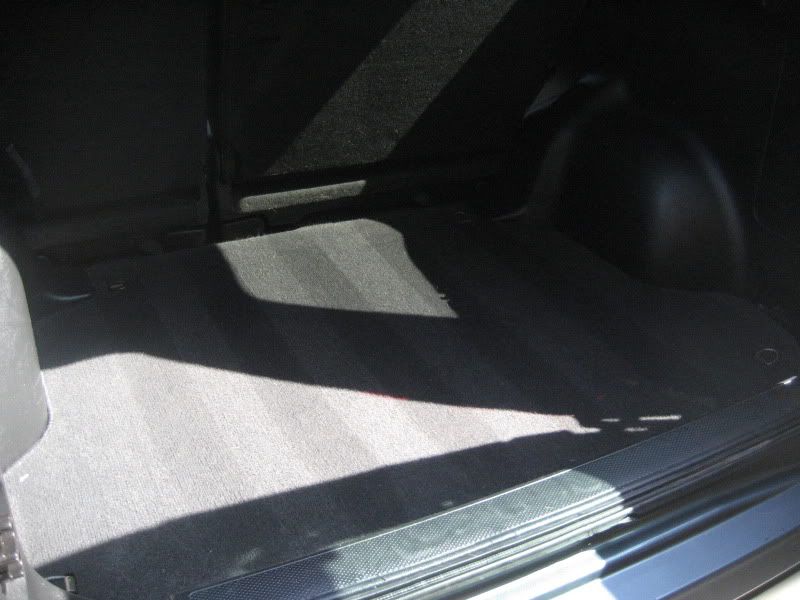

Cleaned carpets with PurplePower/water mix, scrubbed with carpet brush, rinsed with clear water, dried with white terry towel

Moderate/Minor Swirls
The 50/50 shot...
Paint After...

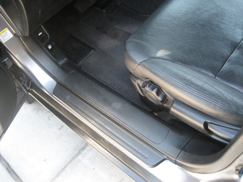

One of the Nastiest Interiors I've done in a while....
Some after shots... looks a little better...

Luster, so after 4.5 hours interior working you still took the extra minutes to "stripe" the carpet? :tongue: When you say you "rinsed" the carpets, are you using a pump up sprayer or an extractor of some sort?
It looks like the Meg's 205 handled the paint defects. Was the orange pad necessary to get the needed amount of "cut"? How did it finish out vs say a polishing pad?

Looks like the M205/orange worked great for that one step polishing. I used the very same process on a Acura TL a few weeks back. It seems that softer clears love this combo. Tomorrow I am going to try to use M105/orange as a one step on a Jetta. I figure the rock hard CC will not marr up too bad.
I've used 105/orange on a C5 Corvette as a one-step. I couldn't believe how it came out!!! No final polish necessary at all. No marring, no hazing. I think the KBM with a spritz of water on the pad helps in that process!
To rinse the carpet I usually use a fairly wet cotton towel, it allows more dirt to come out as well as any residual APC left in the carpet. Then i dry with a clean cotton towel, by pushing back and forth on the carpet with pressure. By the time I've finished "drying", the carpet is barely damp, especially in hot weather..... then stripes with the carpet brush (only takes a few minutes, and the ladies always like it!).
I tried a white pad, but not enough cut to remove the swirls. With the orange/205 there was no hazing.

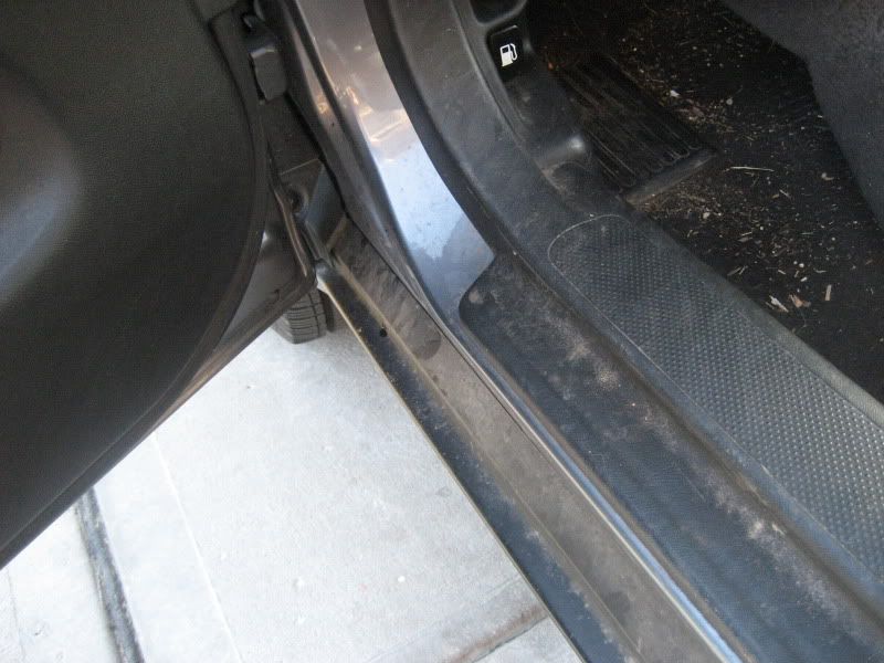

The only thing I couldn't get out was those two "bleached out" spots on the rocker panel trim. If I'd had more time, I would have tried some Back to Black; probably would take them out.
Frankly, by the time I was finished, the heat index was 113 degrees and I felt like I had just finished a triathalon!!!:out: Maybe next time.:tongue:
Here's the rocker panel trim.
To rinse the carpet I usually use a fairly wet cotton towel, it allows more dirt to come out as well as any residual APC left in the carpet. ...
I guess with that method you have to repeat that process several times to ensure the removal of all of the soap residue.
Another question I forgot to ask about the 205. I know the ambient temps you were working with, were you also working in the direct sun? I've been wondering just how much working time you have with the 205 in the heat and sunlight.
Yes... that's the idea to rinse the towel several times in a bucket of clear water, then rinse again and so on. It really doesn't take too long once you get on a roll... but hard work.
I was outside, but it was early enough that the heat wasn't a factor, the paint surface wasn't hot at all. I never polish "hot" paint. I polished the entire vehicle in about 1 hour. (soft Honda paint.) But, remember, there's a lot of glass, and a lot of lower body cladding. (I was glad for that!)
Not wanting to be pesumptuous, but I think we're in a close age related demographic and we need to have each other's backs :D We need to work smarter not harder. You might try buying a couple of dedicated pump up sprayers. Put plain ol' water in one and buy some All Fiber Rinse (I use the Matrix brand) to use in the other. Rinse and "extract" with the water, followed by a rinse and extract with the AFR. I believe your process will be not only easier, but more effective at removing/neutralizing the soap residue.
Also, you might consider purchasing a Traffic Lane Cleaner (TLC) product. These are designed specifically for carpets. Again, I can recommend the Matrix branded Grand Slam SC.
Excellent suggestions! Any time I can save myself some labor and make things go faster and smoother, I'm up for it! (Ain't gettin' any younger! Haha!):cornut:
I have a pump up sprayer and I'll definitely look into the products you're recommending. Thanks.:thumbup:

...I have a pump up sprayer and I'll definitely look into the products you're recommending. Thanks.:thumbup:
If you have a carpet cleaning or janitorial supply store nearby, these products will be on the shelf. I am lucky enough to have a Jon-Don (the Matrix branded products are re-branded products for Jon-Don) storefront nearby. I get products as well as good advice. After many years of thinking like a auto detailer, I took the opportunity to mix and mingle with professionals trained (isn't that novel) in cleaning textiles (carpet and upholstery). I dropped the "make-do" uses of APC for textiles and now use products developed specifically for cleaning those materials. I believe that in doing so, I now deliver superior results with less effort. In addition to chemicals I have also been picked up better tools (brushes etc.).
