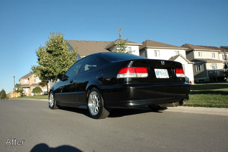

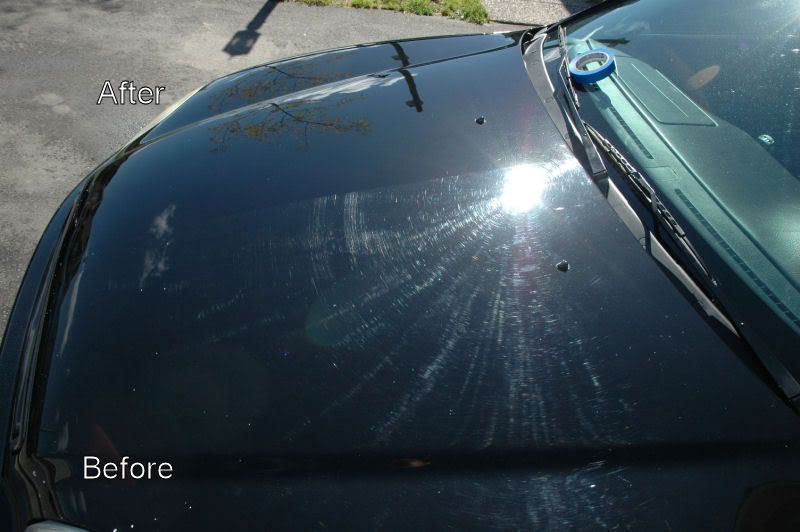

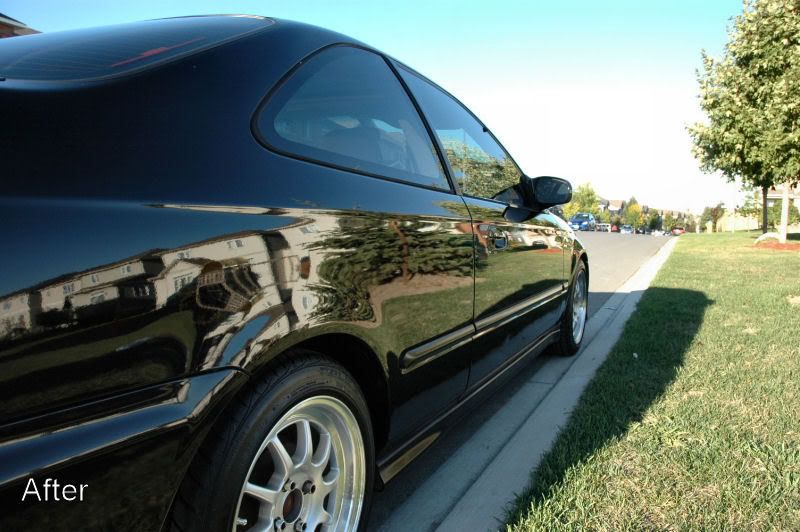

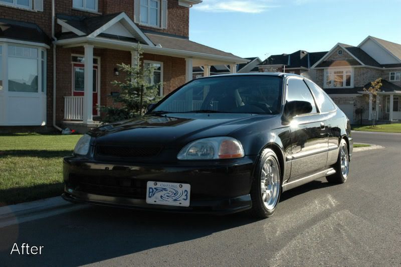

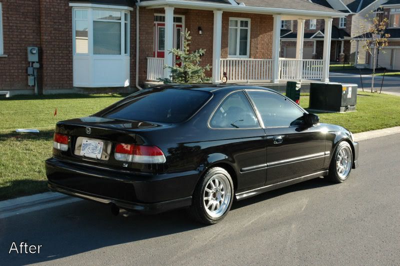

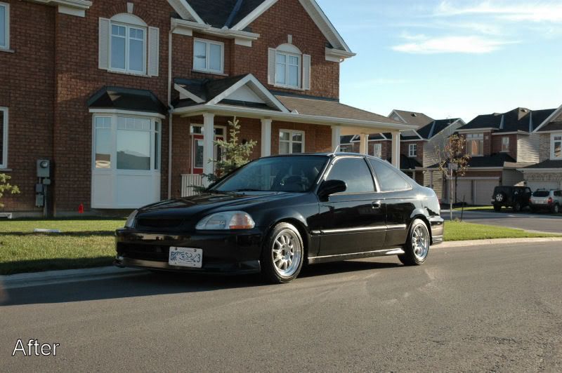

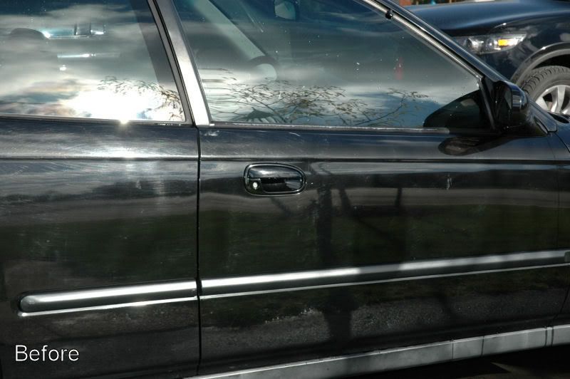

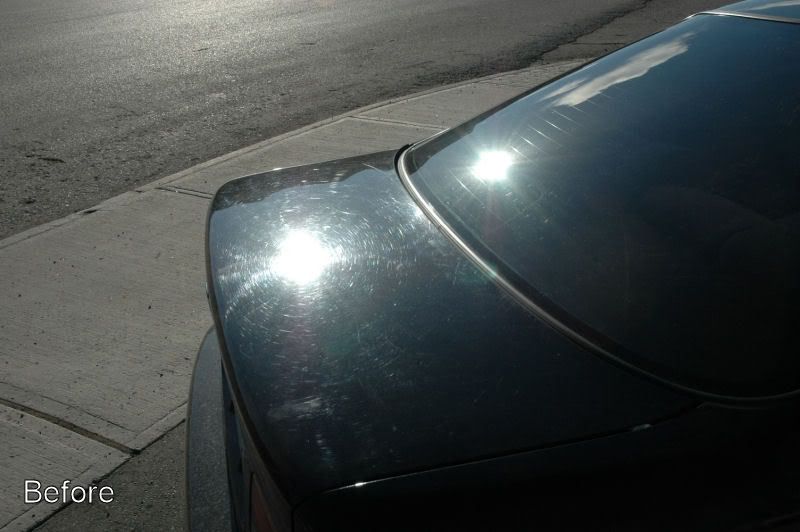

This car was pretty bad, I would say overall 85% defect removal, no swirls but some scratches remained.

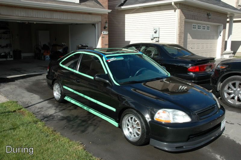

Process:
Wash and Clay
Degrease Wheels and Wells
PG via PC/Yellow Speed 6
PO106FF via PC/Orange Speed 6
PoliSeal via PC/Black Speed 4
Awesome job!

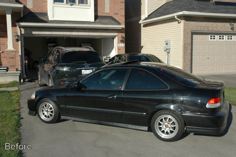

Doesn't look like an Si. Since the headlights are from the EK models. Also, no Si spoiler. :nervous: Also I believe the Si side skirts come painted to match the car. Those look like EK. Looks like someone is trying to turn an EK to an EM1. Thats fine by me! I love EM1's:getdown

Beautiful work. The green tape kinda threw me off for a minute. I thought those were part of the car some reason. I'm really diggin the half shots. Simply amazing.

it's canadian SI which is like EX in the states. US SI = SIR in canada for EK models

but yeah, 99% of the honda's I see look like those befores! You did a fabulous job with the correction though. How do you like powergloss? I tried it on a Trans Am (which later I found out had a Macco paint job, so that explains why the paint was so finicky) and found it worked great. The oils let you work it in nicely.

PG works great, only compound I use now.
