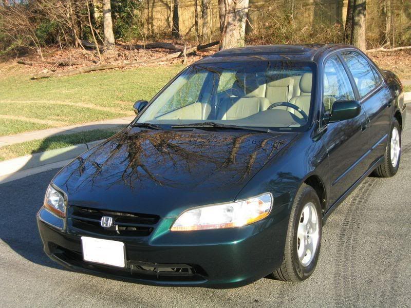

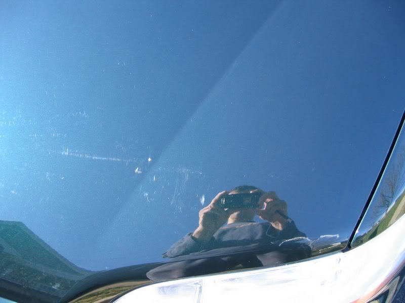

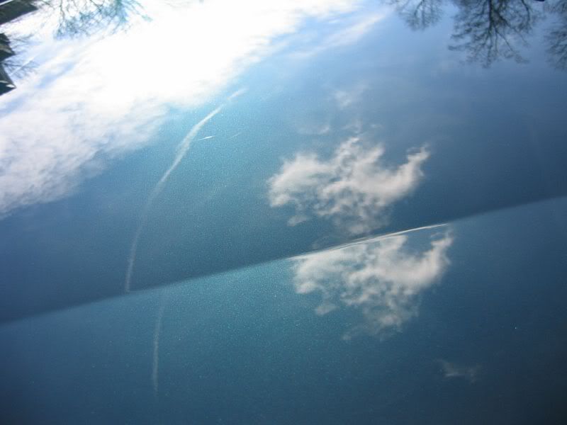

Exterior only. Awhile ago she ran into another car and the bumper/hood got damaged. I guess the shop buffed the whole car and introduced tons of swirls and holograms, but the paint job looked to be top notch.
nxt wash
TOL clay
#80 - Edge 2000 green pad
PwC - edge 2000 blue pad
Amino UV Sealant - Edge 2000 blue pad
before
after
before
after
How long did it take to get those swirls out with #80? What speed were you on (or was it by rotary) ?
What type of pad is the Edge 2000 green pad (cutting, polishing...)?
1 pass mostly, 2 in some places.
I always use speed 6 when correcting.
Green pad - light cutting
blue pad - polishing
white pad - finishing
