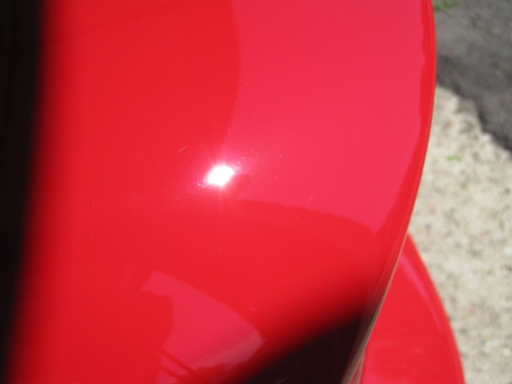

Well new to detailing I recently got a Porter Cable. Ive been using it quite a bit, went to do my full car yesterday and I just cant get it to come out looking good. Im using 105/205. It still has a haze to the paint like buffer swirls. Im using a orange LC pad and a white Hexlogic pad. Its looking better.... just not perfect yet lol. Ive tried working it in more, moving slower, More pressure then easing up. I primed the pad put 3 dots on it and worked a 2' x 2' area. This noob needs help! So was wondering on how some people on here used 105/205 or could give me any tips.
#205 and a polishing pad should take out hazing from #105, if not, you may need to use a cutting pad with #205 first, then go back down to a polishing pad.
