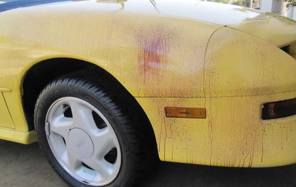

Now, the peachy color is everywhere, I am told. Even the roof, but my little spray bottle of Iron-X was out before I got there, so I didn't spray it. I am just about certain we didn't rub any of this up there, but I almost wish we had, because then this might point out the Iron-X as the source, just in my mind that is. It was not done in direct sunlight, we were two people rubbing the product after letting the spray set for a little while, and the worst spots turned blood purple instantaneously. You might understand why I was thinking Iron-X due to the hue described by owner.

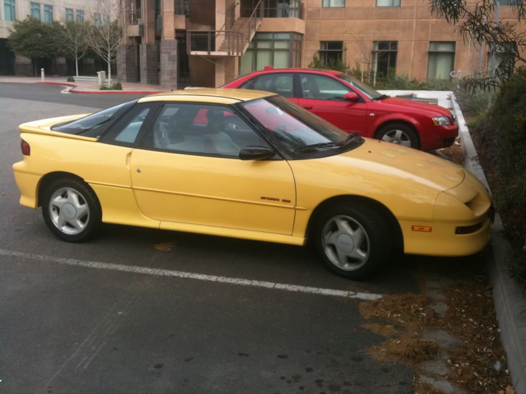

1: only before shot of my own, the crazy Iron-X fallout; everywhere else had moderate, or much less fallout.

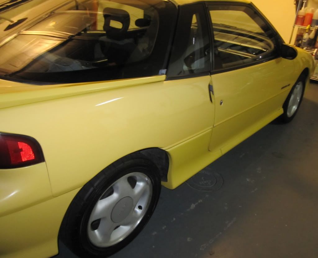

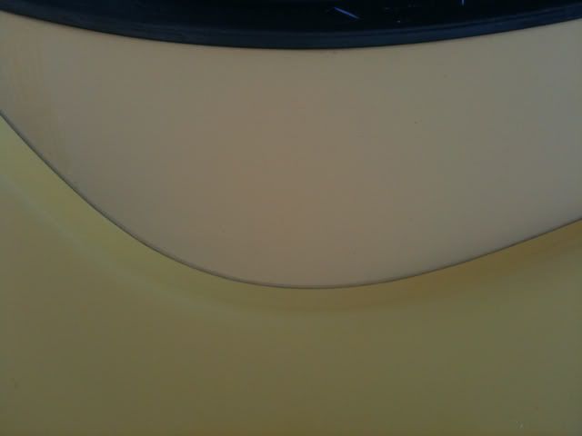

2-4: a few after pics at around nightfall, poor lighting

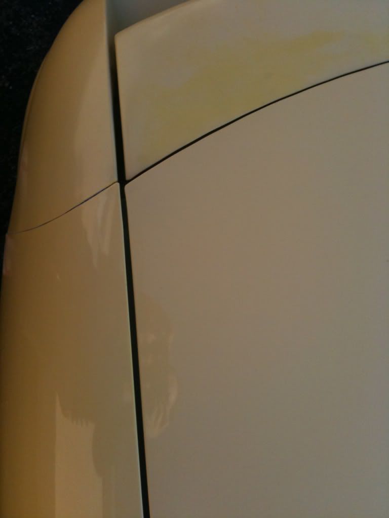

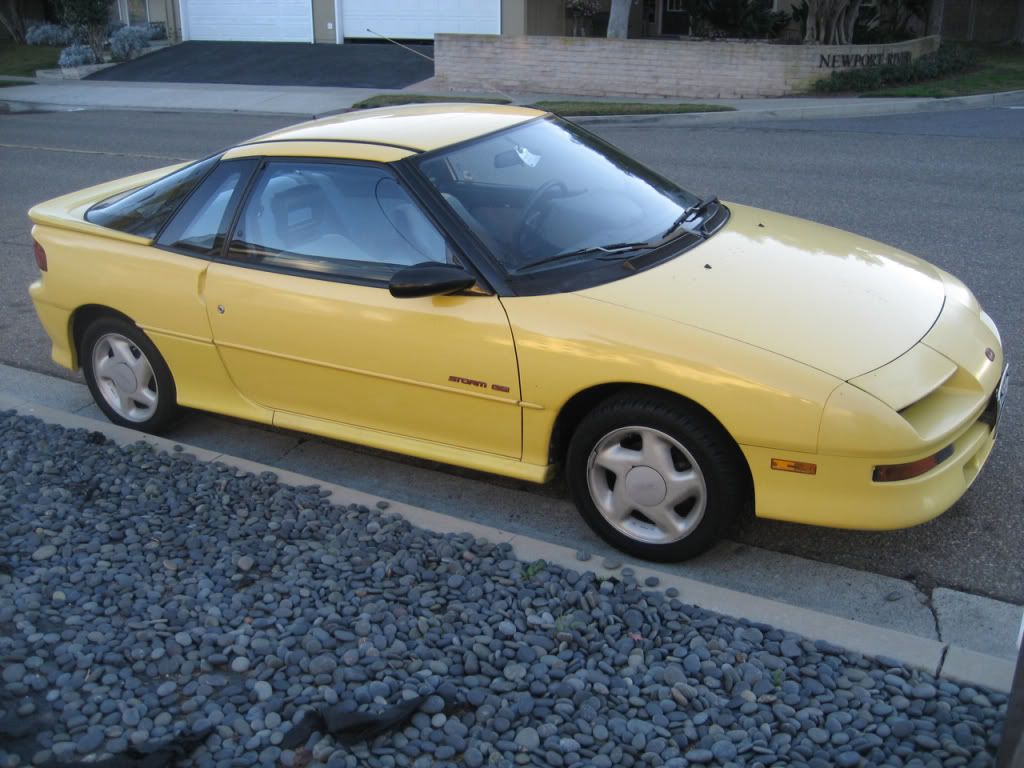

Rest are by owner, previous "before" shots
5: February 20
6: January 28
