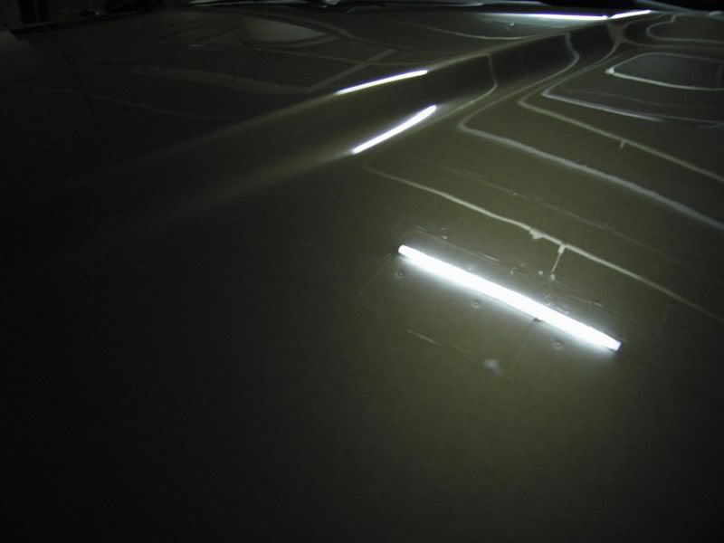

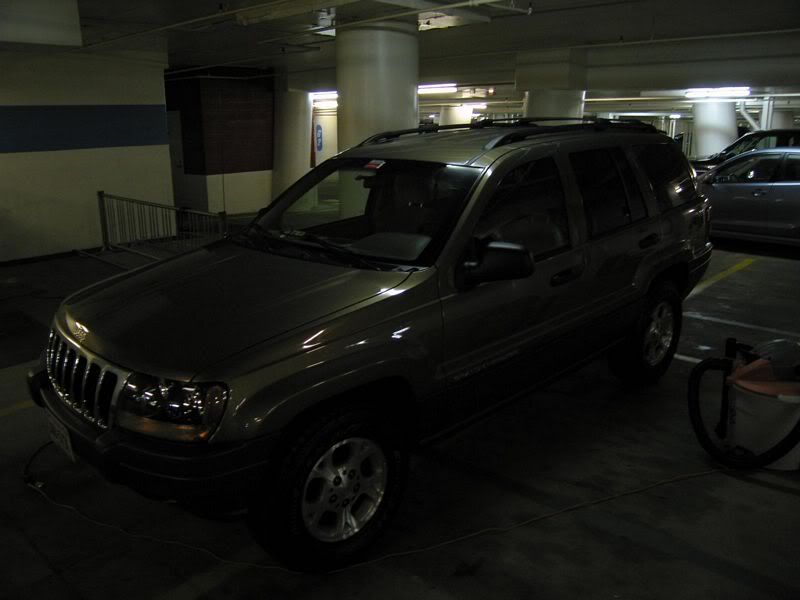

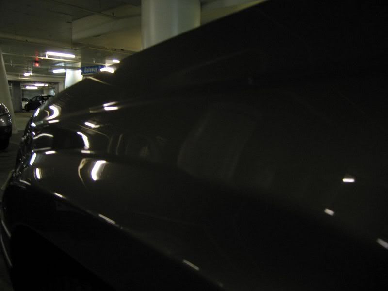

I did an escalade (regular client) yesterday that I detailed 6 months ago. Charged $250.00 I have only done the inside due to weather/owner was leaving town, but I did it in a little more than 2.5 hours. Outside may take me 3 or so hours. I don't know where you live but around No Va nothing is cheap, and gas costs $3.29/gallon. You are a skilled person. Not everyone can do what you are doing. Ask what people charge to clean your house. $100 an hour around here. 4 people working so it takes an hour only. ANYONE can clean a house. Just for the OP information - I did this Jeep today. Done his honda accord already, so I gave him a break. $150.00
Took me from 1:07 pm to 4:30 pm
Process.
qew
clay
OC with an LC orange pad on the PC
#16 by hand
clean & protect wheels/tires
Vacuum interior
clean all plastic
clean all carpeted areas/seats (fabric)
clean windows/door jambs
dressing on all exterior plastic.
Car is only a few years old but looked much worse prior to washing all the dirt off. Bad pictures but you see where I had to do it.
In the end it came out looking fantastic.
Don't sell yourself short.
Hope this helps.
