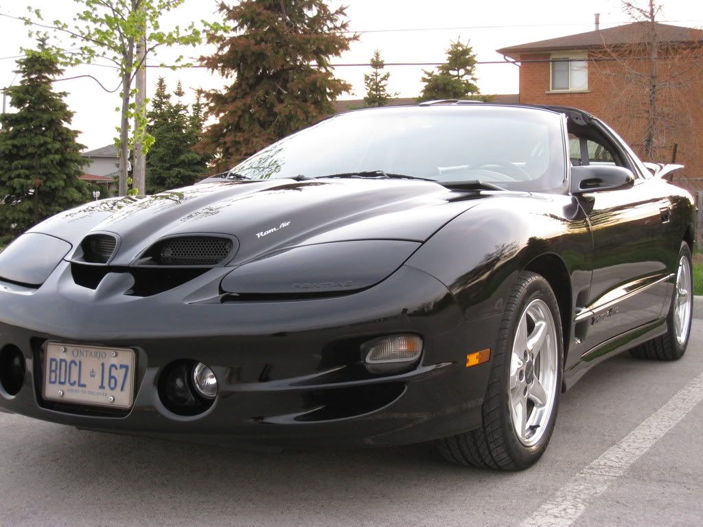

I have some scratches in the Clearcoat on the Ram Air hood of My 2000 Firehawk.. They are not very deep, they are not felt by hand. I have been trying Miguiars Ultimate Compound with a Zaino Tri foam applicator today to try to get them out... They have gotten a little better, but are still there and my arm is getting ready to fall off. Any other ideas on how to get rid of these scratches??
