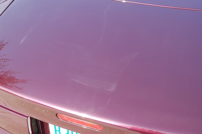

A while back I decided to wet sand and buff my new paint job. After doing a fender and a door, I decided that it was just too much work with a Porter Cable.
So I took it to a local shop that a friend recommended. They seemed to know what they were talking about and weren't hesitant about taking on the job. The first time I went to pick it up, it was full of wet sand marks and they had completely missed one fender. I gave them the benefit of the doubt and let them try again. Now it is FULL of buffer holograms and still has quite a bit of sanding marks.
Is this something I can fix with the PC, or do I need to take it to another pro?

It's hard to say if you can correct that with a PC but I'd give a *tentative* "yes". At the very worst you might have to re-wetsand with 3K Meg's Unigrit and then use the most aggressive products viable for PC use, and with 4" pads. Either Hi-Temp Heavy Cut or a mix of their Extreme Cut and 1Z Ultra/Extra oughta get out 3K sanding scratches, but you'll need a follow up with something milder. But again, don't try this with larger pads, you need the 4" ones when using such rotary-centric products as the Extreme Cut.
But IMO if you can find a competent pro you'd probably be better off letting somebody with experience (and a rotary ;) ) handle this.

I didn't pay them. They'll be lucky if I don't make them pay for fixing it. I hit it with an orange cutting pad 7" and Menzerna high gloss compound- no dice. It's better but I made 3 or 4 passes and it still looks like a train wreck.
Shane- You just cant get the PC to do what you want with the larger pads (and what you want/need isn't the PC's strong suit). And there aren't too many products, at least that I know of, that'll do this kind of work in a reasonable amount of time either. Gee, wish I had something more positive to say.
I fear you're gonna have to either buy stuff and spend a lot of time, or find somebody good...
