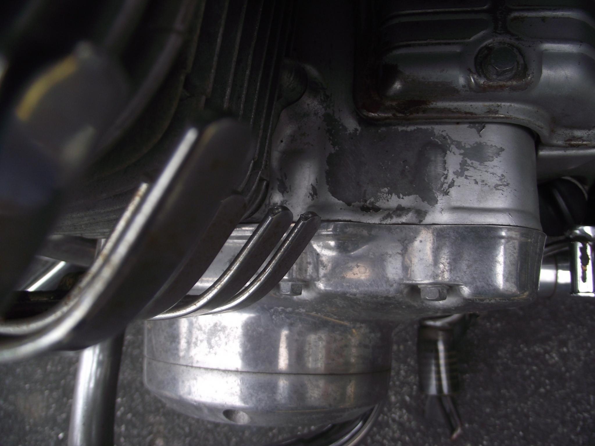

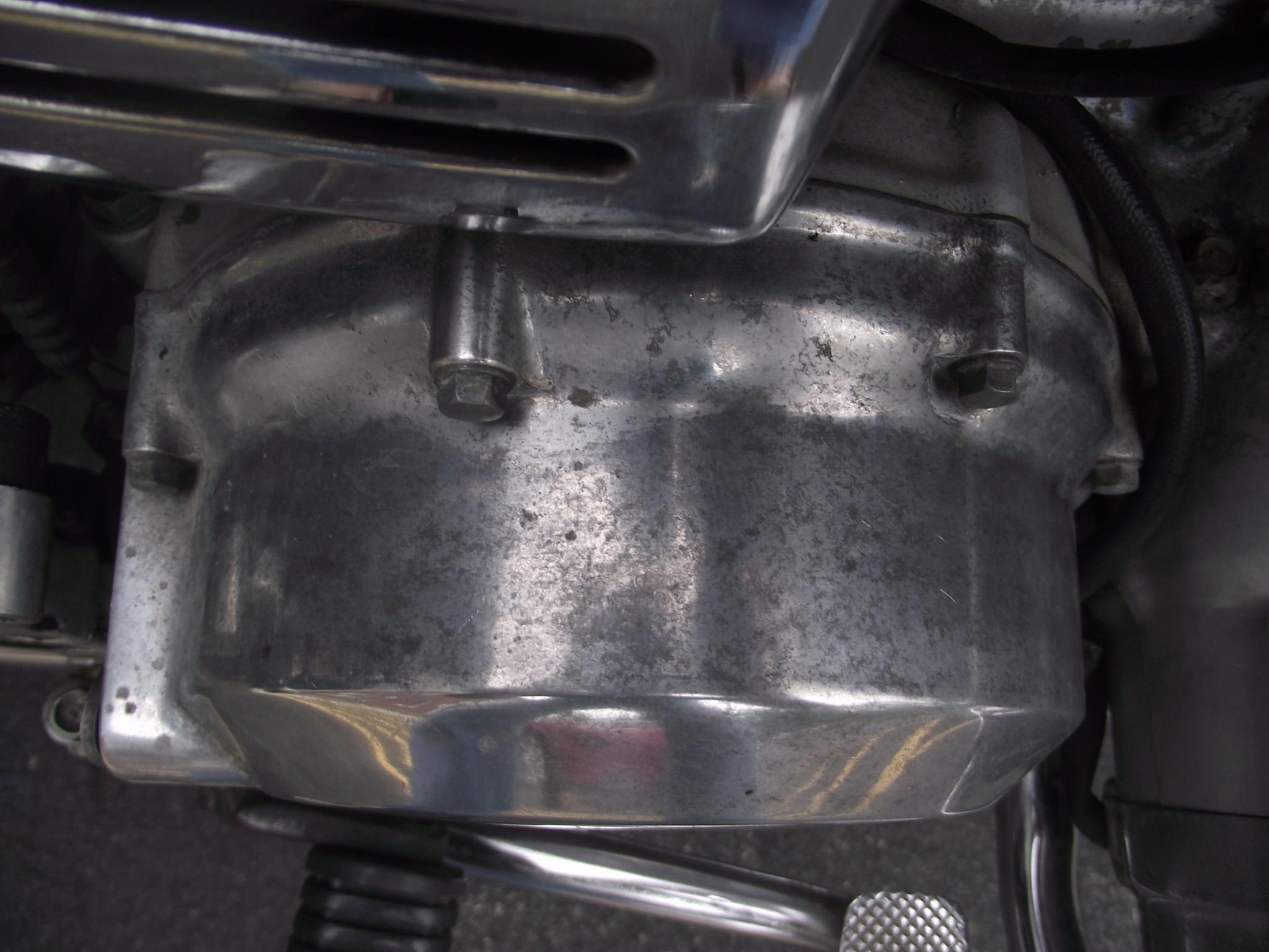

I'm new to detailing and this forum.
I have a 93 Chrysler and a 1980 Honda CB900C
I got this wild idea that could make them both look a lot better by using good detailing methods; I am going to try and keep them both original.
The aluminum on the bike is in bad shape-see pics-any ideas?

welcome to AF binklediddy. the aluminum cases on your bike look pretty rough and pitted.
i think i would start off with a heavy cut aluminum polish like BLACKFIRE Heavy Cut Aluminum Polish . after that you'll need to follow up with a finer aluminum polish like BLACKFIRE Fine Cut Aluminum Polish. the final step would be some type of sealant like BLACKFIRE Wet Diamond Metal Acrylic Sealant. there are many different types of aluminum polish out there. this tool will make polishing a little easier Mothers PowerBall Mini Polishing Tool

Welcome to AF!!!
I helped a friend restore (get running) a late 70's CB550 (I think that was the engine size). Cool bikes.
Do you know what the original finish on the aluminum was? Was it polished (chrome like shine) or was it cast (more than likely) and dull.
To give it a high-gloss, chrome like shine you will need to sand away the pitting (using a fine grade sandpaper) then polish it.
If you want to restore a cast appearance you would likely start with some type of acid dipping and media blasting.
It really depends on the direct you want to go but we are hear to help.
