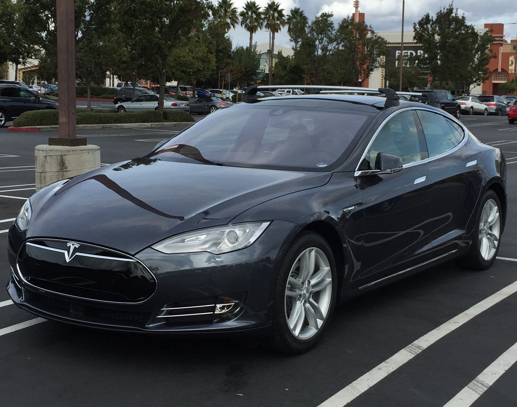

Hi everyone Im new to the idea of doing a proper detailing job on my cars. I have always washed my own cars but never really new a proper way. I just bought a new Tesla Model S that I tool delivery from the factory about 2 weeks ago. I really want this car to look good for a long time.
So I need help on how I should take care of the paint. I have washed the car once using the two bucket method, chemical guys wash, foam gun and an absorber. The car is a dark steel metallic grey. I would like to get a DA and a kit and any necessary product to get the job done right. I'm also going to buy a one of the MF towels sets of 42. I have never used a DA so a forgiving one would be nice and Im not sure what polishes to get based on best case or worst case scenario of the paint after washing off the wax coating on it right now. There are so many different products and kits available that my head is spinning. What kit has the best product, equipment and amount of products that I will need? Should I pick and choose different stuff and skip a kit? I'm definitely interested in a sealer too.
Oh and here is a picture of the car.

Welcome to AF! This kit would cover you on compounding, polishing and has one of the best sealants to protect your paint and look great. Plus it comes with the Mike Phillips tutorial dvd. PC is definitely forgiving. You did good buying the microfiber kit. Can never have too many. Awesome car btw.
