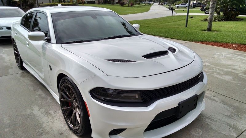

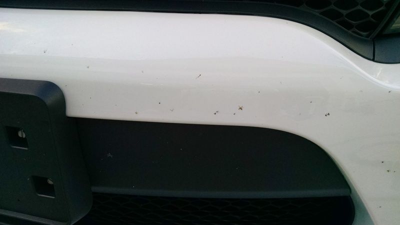

Had a client contact me about his pearl white 4k mile Hellcat Charger. He was looking for some correction work and a coating. At first when I arrived at his house the car appeared to be well kept. Overall it was but what I found after my wash and decontamination process was sickening.

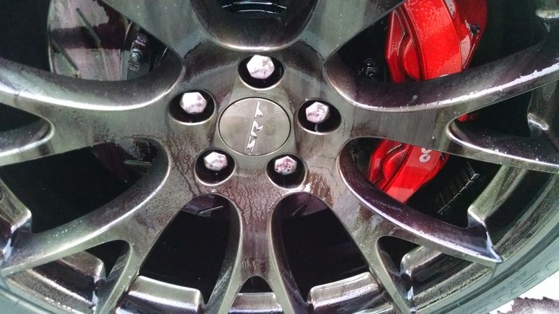

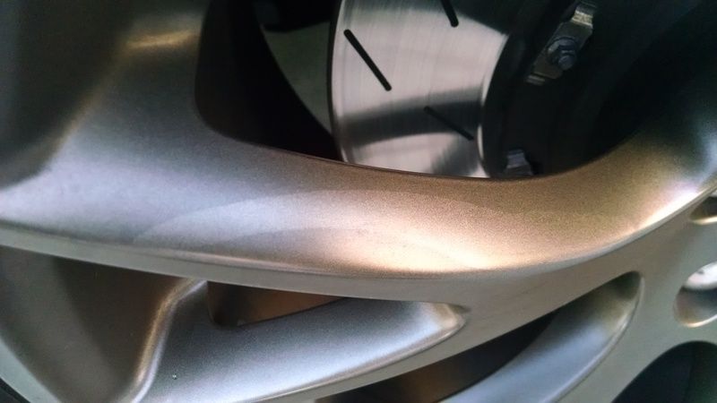

Wheels cleaned with iron-x, tires- tuffshine tire cleaner
Wheels sealed with Hydro2

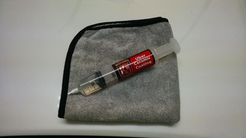

Paint and glass coated with Wolfgang Uber Ceramic Coating.

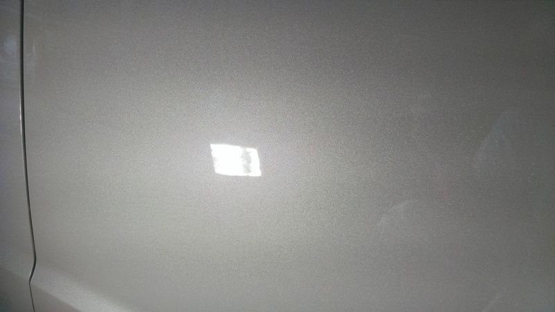

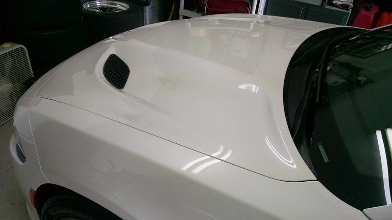

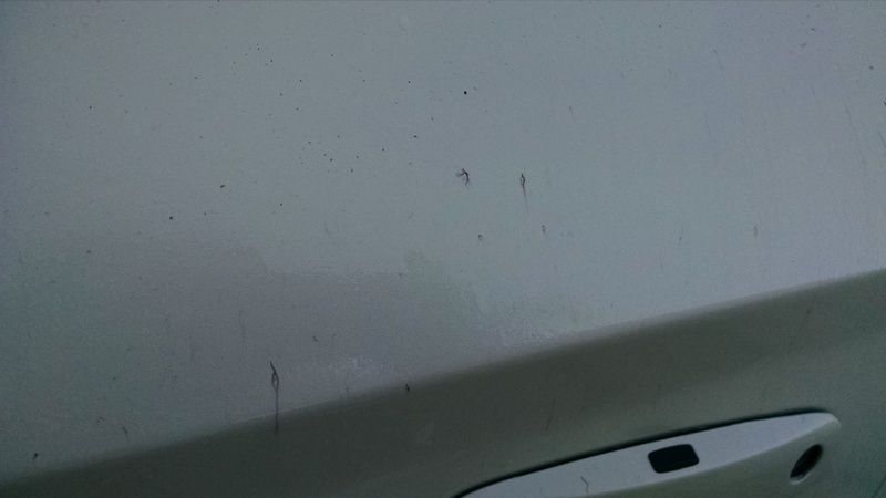

So after my initial wash and decontamination I had found some overspray on the window of the front passenger door. Well once I shined my light in the door it became pretty evident that the door and fender had been resprayed. It was very cloudy from there subpar finishing work. Fortunately I was able to fix it and get it back better than new.
Upon arrival.

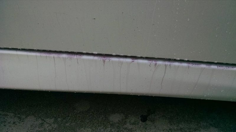

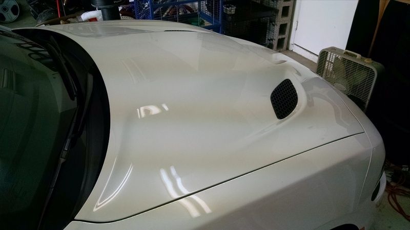

Iron-x doing work!
Cleaned up and sealed with Hydro2. Nice beading.
More iron-x.
50/50 of the repainted door.

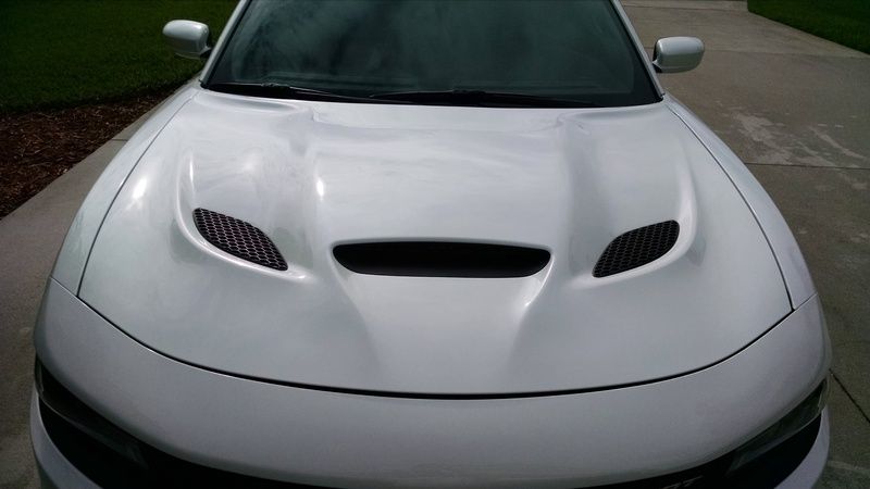

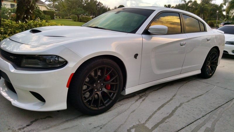

All corrected and coated.

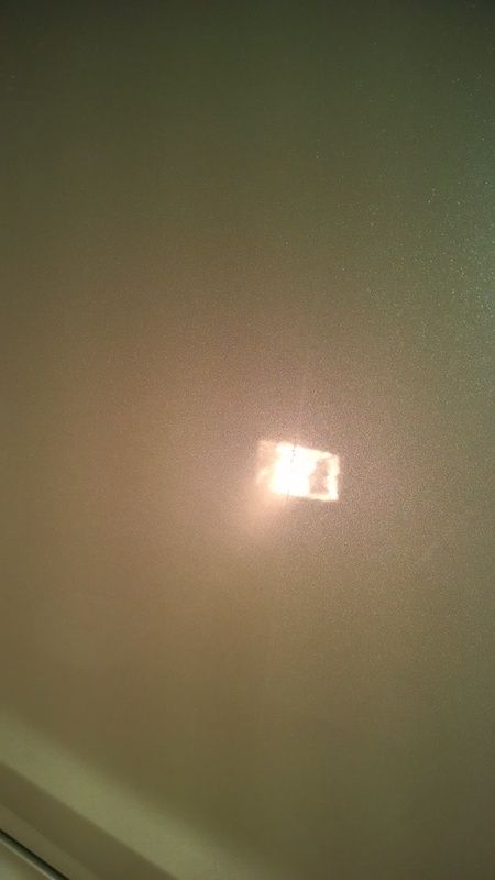

Thank you! I don`t remember seeing die back but one thing Chrysler product`s are known for having are perfect circles where they do spot corrections on the paint to remove dirt nibs at the factory. They sand a tiny area then whatever they use to polish it out doesn`t quite remove the sanded soot. The result is a cloudy spot under certain light. The Jeep I just did had one on the hood. I used to see it all the time at the Chrysler Jeep Dodge dealer with brand new cars.
