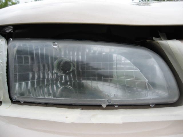

I picked up the 3M headlight kit and tried it out on my 2001 Pontiac. I did the left side of the light first to see how it worked. I only used the fine, veryfine paper and pad since my lights did not seem too bad. I used the least abrasive pad first. ( I did not use the medium pad) It still looks a little foggy. I used Megs plastix. Would the 3m stuff be much better? It's in a packet so it's a one and done deal. I have some Adams swirl /haze remover too , would that work? Getting picks soon. Thanks.
I think I have some swirl-x, for some reason I did not think of using that. Good idea, thanks. I did wet sand the lights by hand about a year ago, but was not happy with the results. I used a cordless drill this time.
