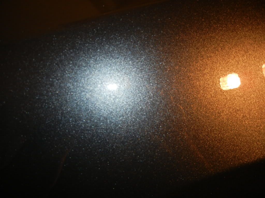

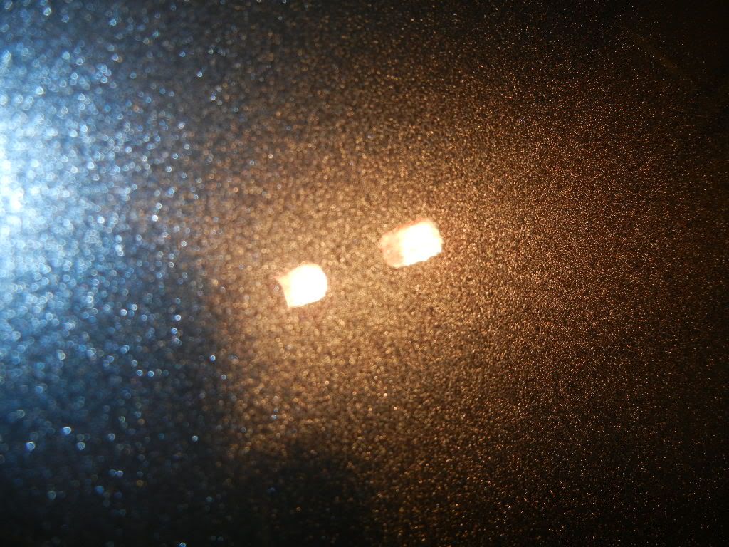

Before

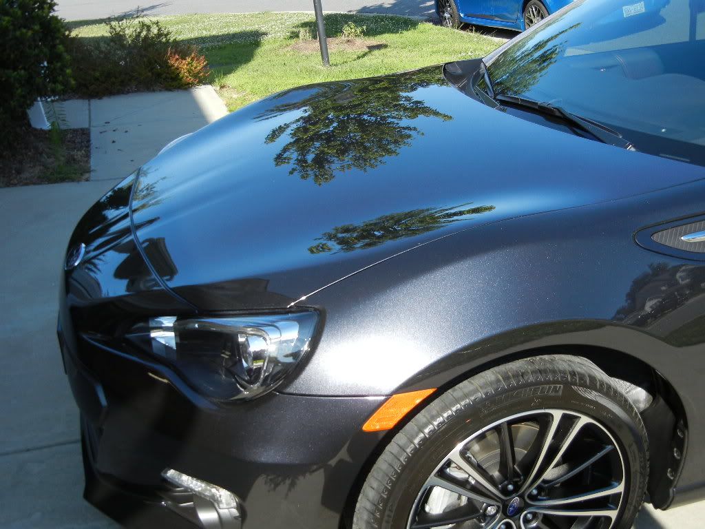

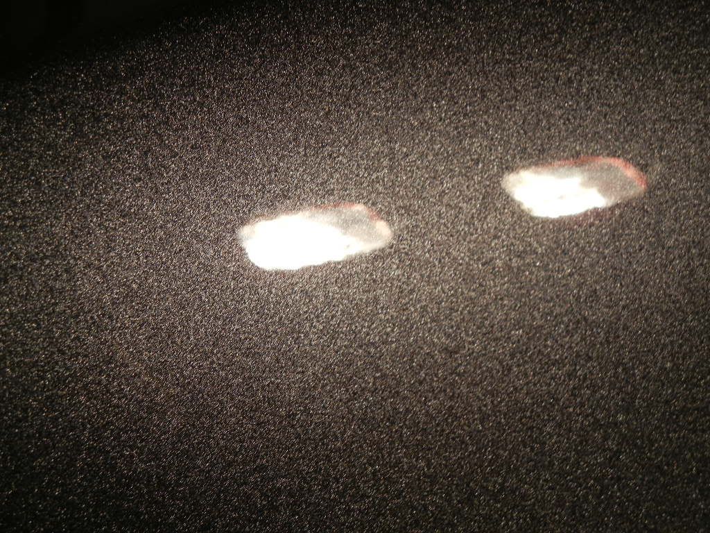

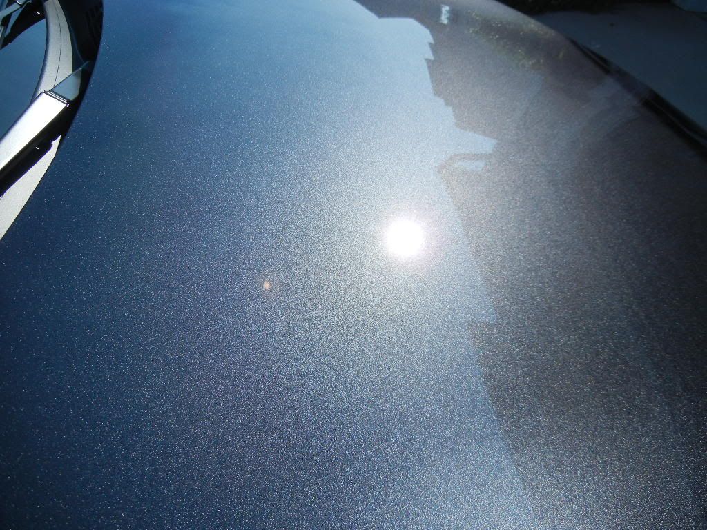

After

The before and afters look approximately the same regarding swirls/marring, but the afters of the whole car are BEAUTIFUL. Awesome color and result.
Very nice shine you ended up with. Fortunately, metallic paint is very forgiving in seeing any marring, at least easily. I also hoped Polish would replace 205 for me. I'm still experimenting with it, but it just doesn't match it with harder paints for me. The gloss it creates is create though, especially darker, solid colors.

I only included one before and after, because there was a deeper scratch visible in the pic right above the halogen. HD Polish took the deep scratch out easily. I agree though, none of the other pics showed any swirls due to the color and heavy metallic flake in it. And thank you, I really was pleased with the result too!

I'm a huge fan of Optimum Hyper Spray Polish Mike but I'll be honest with you, looking at the pictures HD Polish leaves a wetter look. And if it stays that way after IPA type wipe downs then that's a winner in my book. Don't get me wrong, bright glossy paint looks great but there's just something about a wet, glossy finish that just looks *fresh* to me. Yes I used the word fresh.
