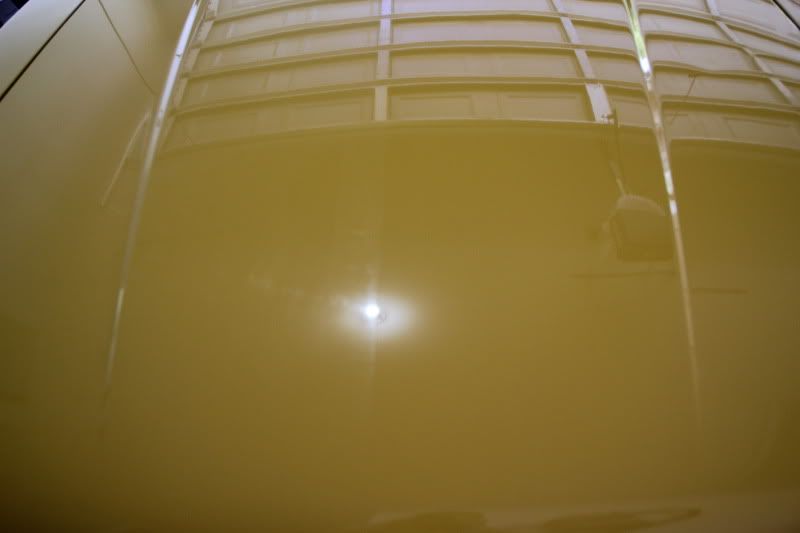

Ok guys... here is the 50/50 shot of the hood... it has taken me 4 hours to do just this half (save 30 minutes for running to the store). The PG wasn't cutting it (pun intended) so I go some Meg's #1 I think it's fine cut cleaner? Also #4 which is heavy cut cleaner... there are still scratches that the only way they will come out is simply by polishing more and more.
Thus far I have done 2 passes with the heavy cut with red pad
2 passes with the #1 on a meg's red pad
A final longer pass with SIP on Meg's yellow softer pad.
You can see the pitting in the paint... it's quite severe.
I don't believe I can do much better on this... very dissapointing, as I like my work to come out at least near perfect.

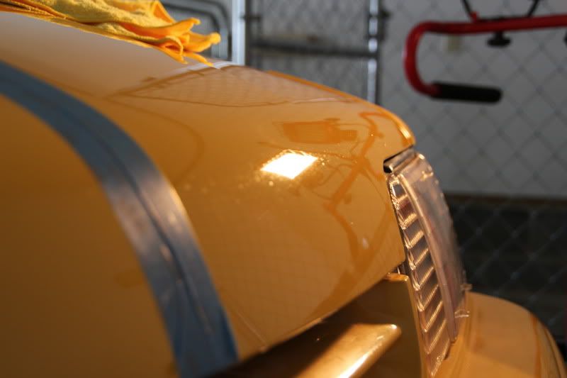

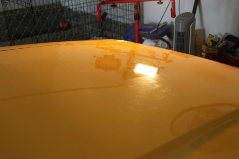

Update: The car is coming along slowly... i've gotten some M105 and used it on the Meg's burgundy red pad, which is a cutting pad. For some reason, the softer yellow pad seems to work better. The process is very slow, however the results are very good with the almost 20 year old paint almost looking liquid.
