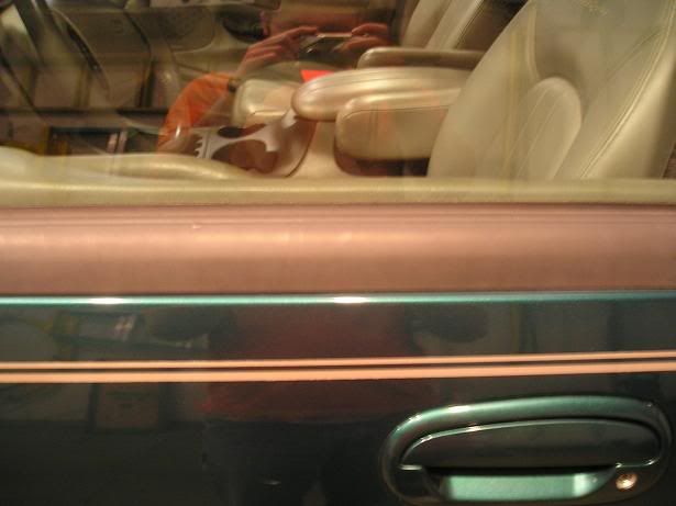

1. Here is your faded trim with oily wax stains.
To prep this trim for restoration I lightly sprayed the trim with some water and then very lightly ranthe magic eraser over the trim making sure not to come in contact with the paint. I made sure to wipe of all excess from the trim after the eraser.
2. Here is half the trim done.
I used VRT on this trim with a foam painters brush to brush it on. After letting it dwell for about a minute i wiped off the excess with a MF towel. If your trim is really dry and thirsty you might want to follow up with another coat of dressing.
3. Here is the Trim fully done.
Trim restoration is not that hard if you just take your time and pay attention to details.
Greg
