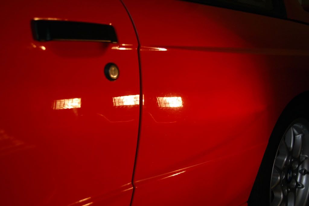

Makita speed 2 / Orange Lake Country / M105 (old formula)
I polished very S L O W L Y...original 20 year old paint here.
This is after only M105. Im going back this evening to hit it with 205 then possibly jewel with 085, then some Swissvax Concorso. I think it should pass.
The door is finished with its heavy polishing with M105, the quarter needs another pass.
The entire car took 6hrs to cut into. Lots of thin paint and edges to be careful of. I expect this to be a marathon correction.
