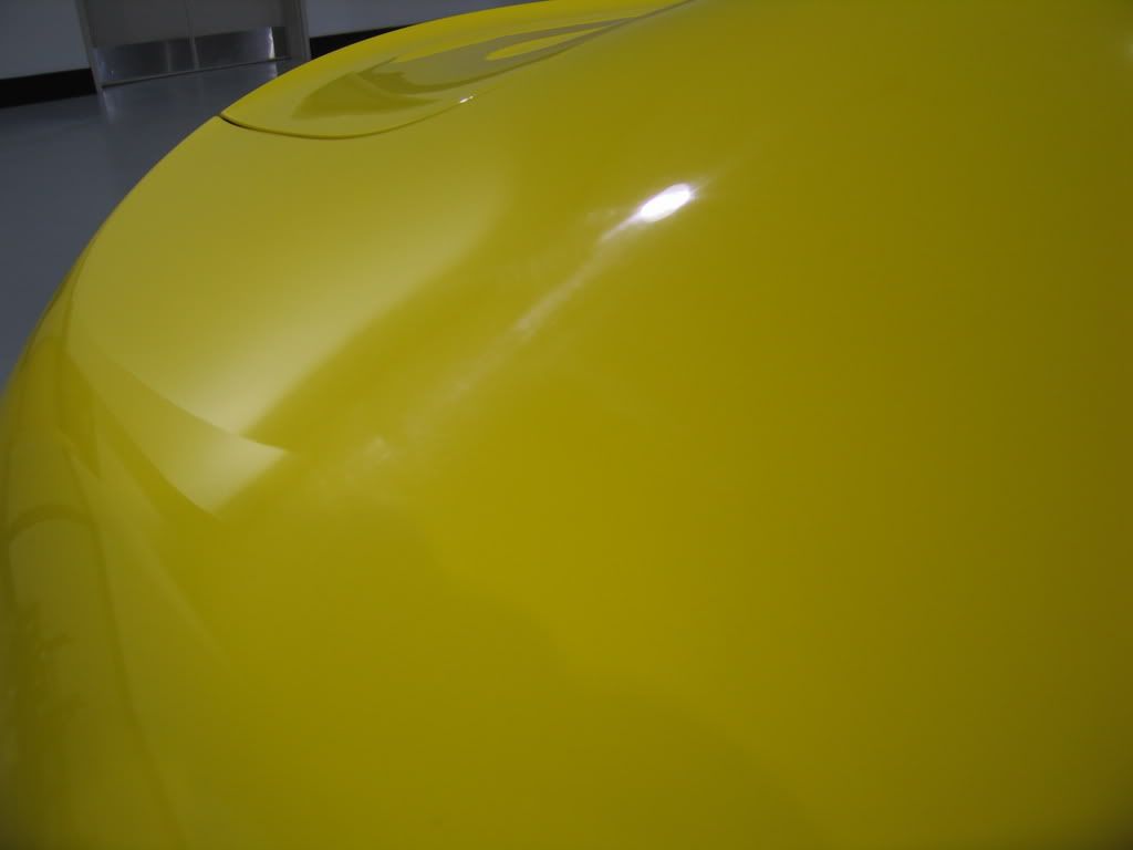

I tried capturing what the butchers did at the paint shop. (paint was baked)
Car came with a chip on the right side between the rear wheel and the passanger door. Dealer decided to have the whole rear fender repainted. Found 2 small areas in the repaint that the owner has to see as far as what the next step will be. Live with it or have them fix it. :wall :wall
The buffing job was terrible. Made the paint look dull.
Owner bought the car 2 saturdays ago and haven't seen it since. I think he is picking it up tonight. Getting radar/tint done today.
Once he has the car I am going to his house to prep the car. Yesterday I just deswirled the areas where the 3M was going this am. I used 106ff on a green ccs pad 1100rpm. Followed up with the pc on speed 6 - same pad
I hope that you can see some of the rotary "work"
