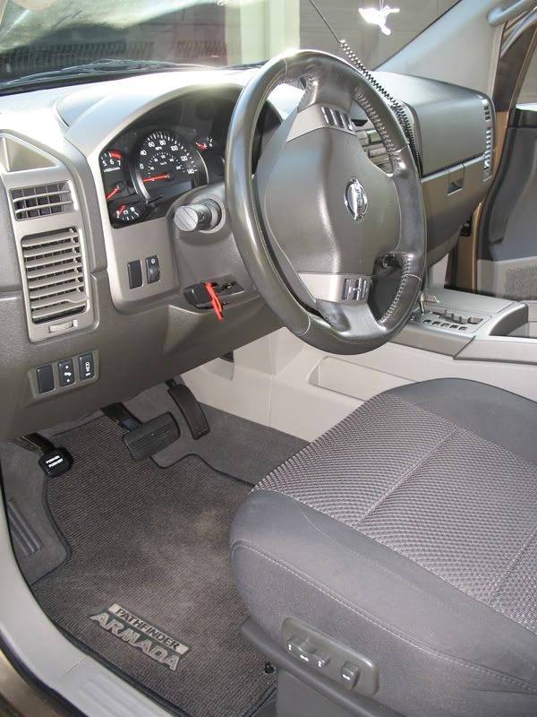

Interior:
-Vacuum
-Meguiars Quick interior Wipedown
-NXT Glass cleaner on all glass
-Poorboys Trim Restorer for the dash/door panels which needed a fresh black look
-Heavy stains removed with diluted simple green (lower door panels) then treated with 303 protectant/meguiars quick detail

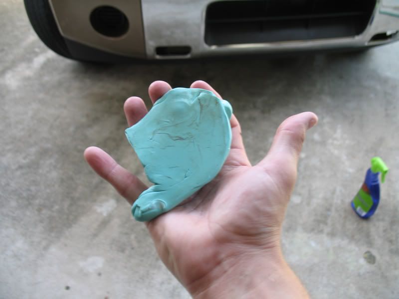

Exterior:-Wash with NXT wash
-Clay with Pinnacle Poly clay

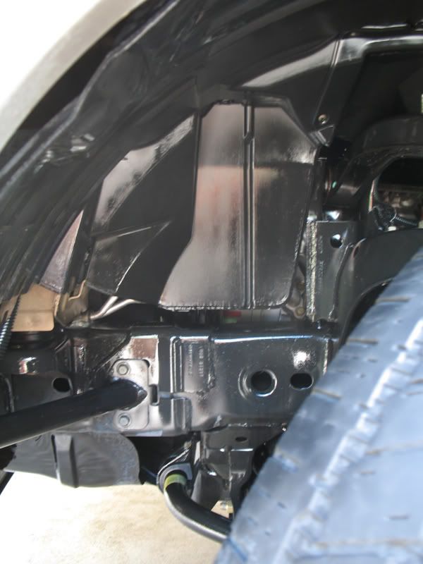

-Pressure cleaned wheel wells
-Wheel wells dressed with black magic tire foam

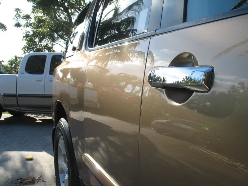

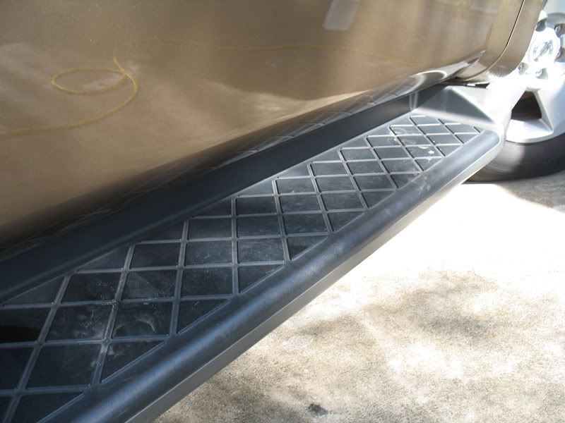

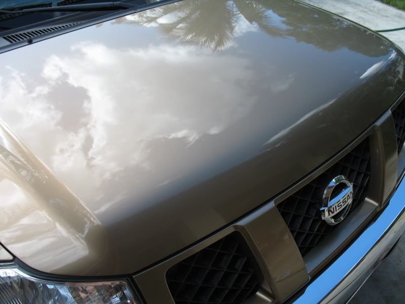

-Optimum Polish via Orange cutting pad PC speed 6, (whole car, 2x over in certain areas)
-Optimum polish via White pad on PC speed 6 (hood, doors and fenders)
-Poorboys EX with caranuba
-Poorboys S and G wipedown

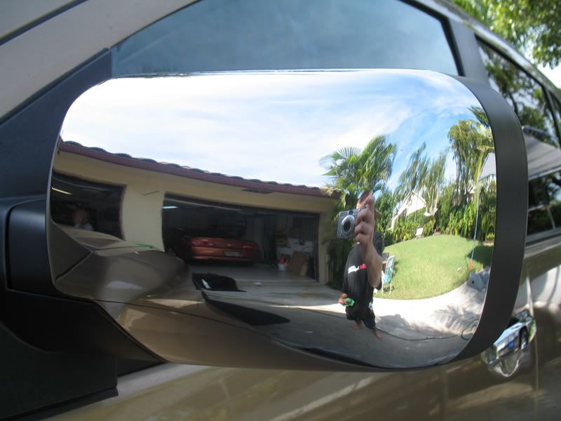

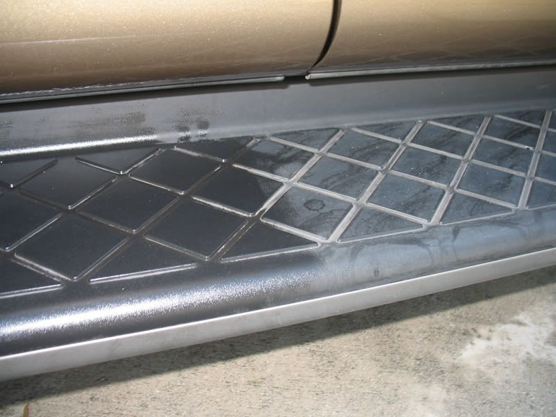

(the paint had yet to be clayed/polished/waxed in this one, just a picture of the chrome
Half/Half of Poorboys Trim restorer

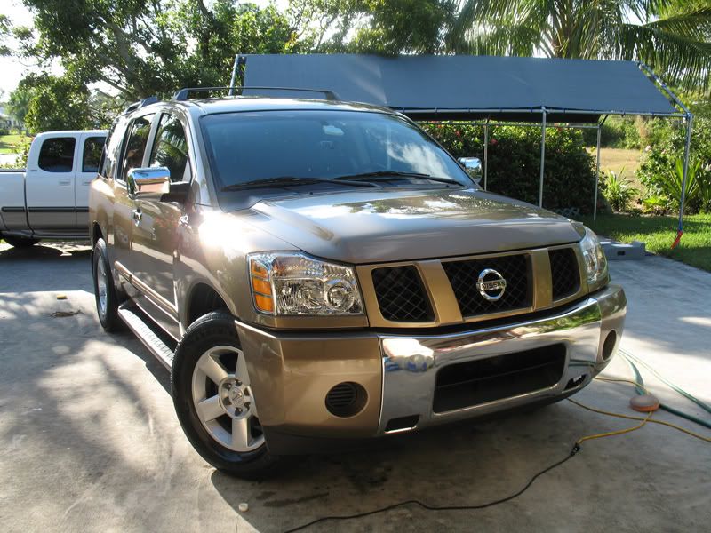

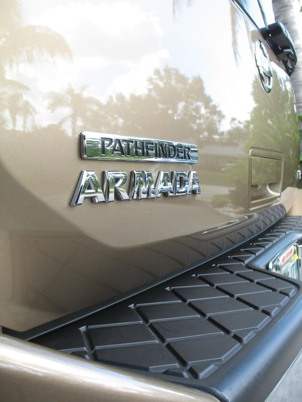

Finished product

looks awesome :cooleek: ! why is that orange foam pad on the ground? :chuckle:
Yep, I'm thinking he 'stuck the landing' but gets points off for execution!
LOL
Seriously the ride looks great but the pad on the ground makes me cringe!
LoL thanks, as for why the orange pad is on the ground, I'm pretty much through with my set of pads right now so I put it face up on the ground after I was done with the car, didnt think much of it, I'm set to order some new lake and country pads
nice buddy . . . i have a silver frontier . . . think ill give that lsp combo a shot . . . love the finish . . . reflection and depth is awesome, especially for such a mellow color . .
