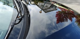

I got it all finished up today. Perfect weather for it too. A nice breezy 75°F. I did all the prep work first of course. I washed with Mckee`s Sio2 wash, decontaminated with their Xtreme Iron Remover, clayed, and then did some touch up polishing to remove some marring and swirls. Then used Mckee`s Coating Prep Polish to get the paint nice and clean. Finally on to the last step. It was very easy. It applied very smoothly, you can easily see where you`ve applied it to and make sure you have adequate coverage on each panel.
It buffed out easily as well. No problems with high spots or streaking at all. Now it`s out there curing and then after a few days I will hit it with the Hydro Blue Sio2 coating.
The paint coating itself gives a very nice glossy look to the car. I read other people saying it has a bit of a darkening effect on their paint. I could tell this too when doing a 50/50 on a panel. Since my car is Phantom Black, the added darkness makes it look even deeper and rich. I can see why people with light colored cars may not want to use this coating.
They claim 2 years worth of protection with proper care and optimal conditions. I am guessing by refreshing the coating with Hydro Blue it might last a year, I would really be amazed to see 2 years of full protection. For the money and ease of use though, it seems to be a good product.

Looks great!
Your gonna love coatings; now your black car will stay cleaner for more than 5 minutes after washing. You`ll get at least a good 20 minutes now...unless the neighbor decides to blow leaves.
